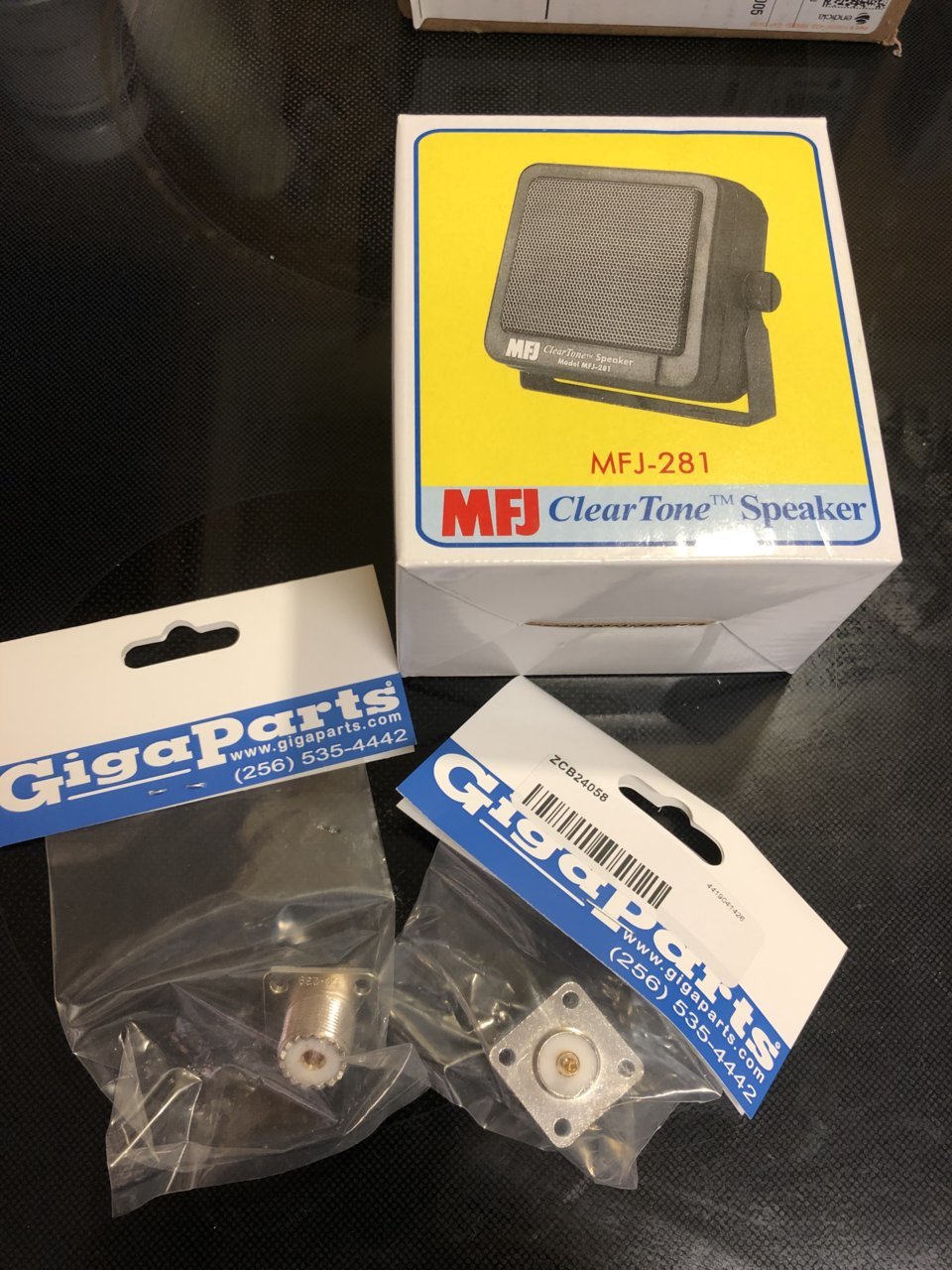

    Got some new parts in today. New speaker for the truck to replace the crappy cb speaker I’ve been using and some so-239’s to build antenna’s with.
