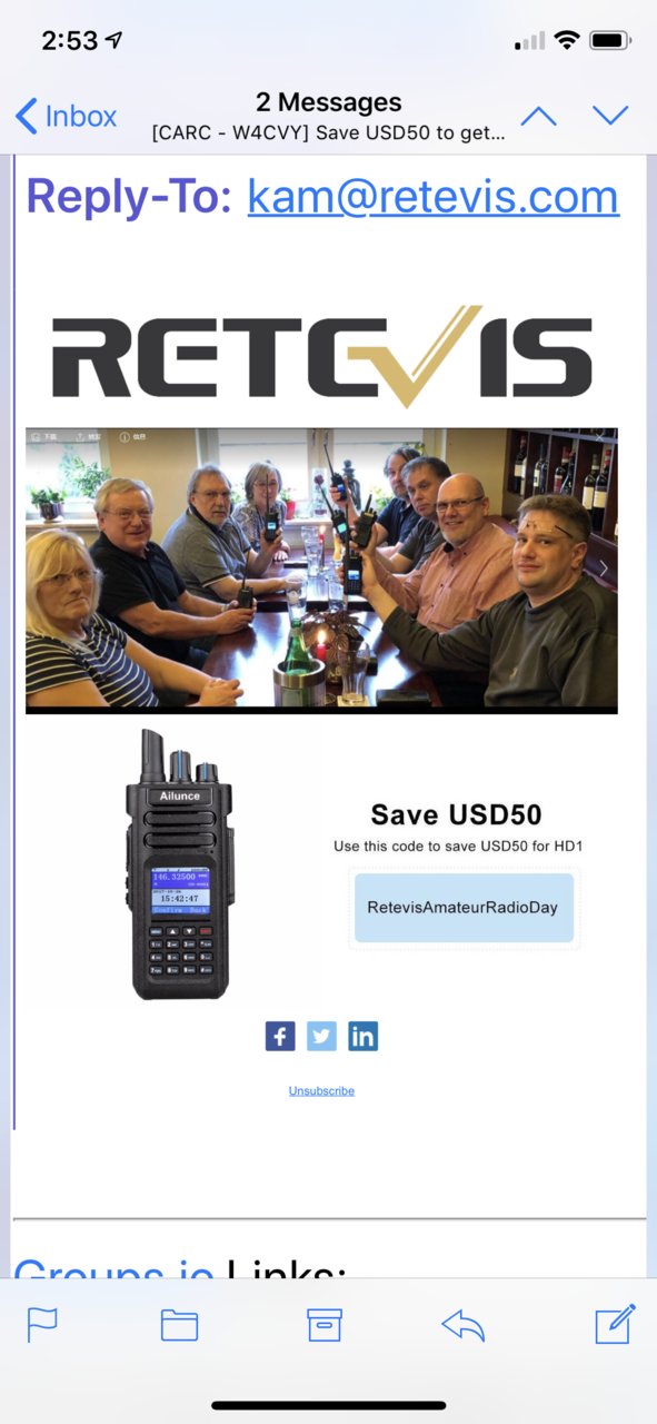

    Meh. The D710 hovers right around the same all the time. I saw it for $549 but I paid $557 for mine in Sept last year. Seems like it's always right around that area. Unless you're seeing a deal I'm not? Regardless I love my D710 and it's worth every bit of that price. Great do just about everything rig. Also most people won't go for the price of the D710 so there's that.
    Probably a good thing I didn't go by HRO today when I was 20 minutes away because I may have come home with another radio from there. :anonymous:
    But since we're talking deals if anyone want to get into DMR with a discount there's a deal running on the Ailunce HD1 right now for $50 off. Use code: RetevisAmateurRadioDay
    I don’t have one but @m603holden really likes his. One other local guy has one and likes his also.

    X2.
    The hd1 is one tough, waterproof nugget. With front panel programming !
