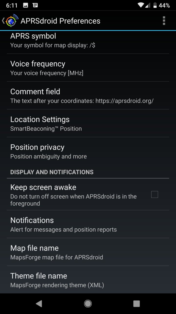

    Why would you need to choose a different map than what you were using a month ago?
    Seriously sounds like you didn't download the OSM APK, even though you thought you might have. I just tried it and it works fine. The option is Map File Name in the most recent version... (screenshots below)
    If you did download the OSM APK, what's the URL of the APK that you installed?

    I had exactly what you described happen to me. The map file preference option disappeared. I remembered that the play store version didn't allow the use of offline mapes and sure enough, the version of APRSdroid installed was the latest version of the app being offered from the play store.
    The fix of course was to remove it and install the OSM version.
