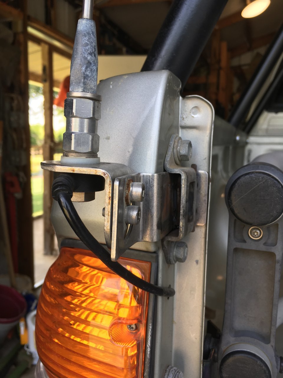

    Hey guys, I know this is a CB question but I thought you might be able to help me out.
    I have a 102” whip antenna on a Firering coax cable. The radio picks up very strong static interference at times and it goes away when I touch the antenna. Does this mean I need to add a ground wire to the antenna? I read online that with this type of mount that’s not necessary but I’m not convinced. The reason I have this mount is that at first I was running a Firestik NGP antenna. Any advice is welcome!
    Here’s a photo of how I have it mounted

    I'd toss a ground wire on it and see if it gets better. If you touching it improves it, it sounds like that's the issue.

    I've never used that particular coax connector, so don't have much advice for it. Make sure that the shield of the coax has a good ground to the bottom side of the mount, and have someone with an Antenna Tuner check your SWR.
    A 102 whip is going to receive immensely better than a firestick. Pulling in much weaker signals, and more ambient static. You'll hear blinking red lights as you drive under them even. If your SWR is good then make sure your Noise Blanker and Auto Noise Limiter NB/ANL functions are on and set your squelch.

    My SWR is something like a 1.2 on all channels last time I checked it a while ago. My radio only has an adjustment for squelch, and the static will break the squelch when it’s turned all the way up. It comes in as strong as 4 by 5 on the radio sometimes. My radio has no adjustable RF Gain...something that I think I would benefit from being able to turn down.

    Sounds like another source of interference. With a true quarter wave at 1.2 SWR your ground does not sound off. Run the power direct off the battery with the truck shut off and see if it goes away.
