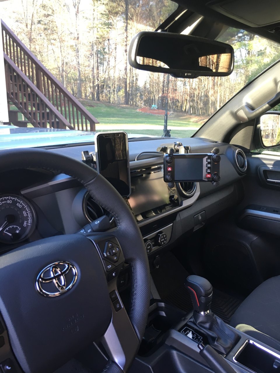

    Congratulations on your license; now the purchasing fun begins! I run a Yaesu FTM 400 which meets your requirements. The detachable faceplate is secured via the Ram mount which is secured to the DMM mount. I'm very happy with my selection and it does not restrict viewing of there Entune display.

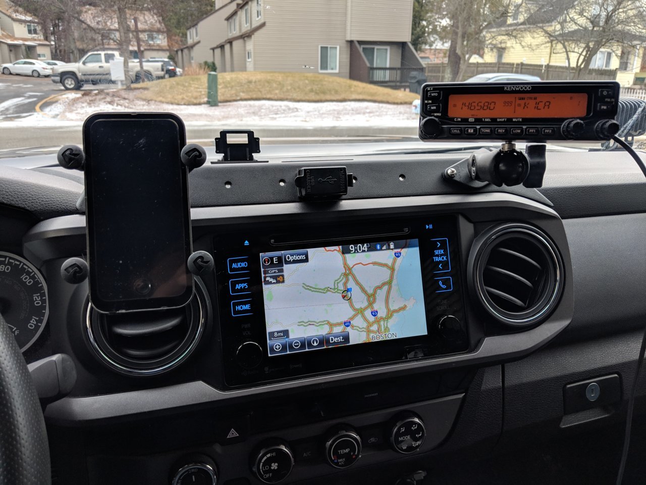

    Kenwood has the best APRS solution in a bottle. The TM-D710ga is the most simple radio to get APRS running with minimal fuss and good performance.
    The TM-V71A is another great radio. You can easily add APRS with a mobilnkd TNC and an Android phone. Just about any modest used phone from eBay will work. It's a little more fuss to get operational, but not too bad if you buy cables rather then build them. you'll have a color moving map display of the other APRS stations near you.
    The FT-8900 and other options from yaesu are excellent radios. It's not practical to add APRS to them like you can the Kenwood's. The FTM-100dr has APRS built in, but doesn't dual receive. So you can't do FM voice and APRS at the same time. It's one or the other. The FTM-400 seems like a nice rig if you're into YSF. However, it's lack of full duplex capability disappoints me. I find the TM-D710ga more intuitive and simple to use.
