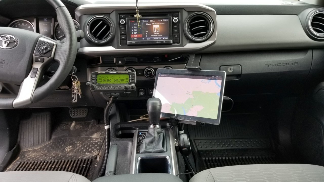

    What is everyone's preferred method of mounting a mobile radio like a yaesu ft857d in a gen 2 tacoma? looking for something that make it look like it grew there.

    I like to keep the head units low, out of the sun and sight, so I use a seat bolt mount from Lidomounts.com
    I run it from the seat mount along the center console, and up to position near the center console button pannel. It comes with a U-bracket that holds it secure to the center console to eliminate a lot of movement.

    Mine looks the same as his just on the passenger side. Same radio also. Believe the 857 has a remote mount for the head also.
    If you don’t mind cutting the back of the center pocket you could put it there in one piece probably. Unless the airbag box thing is back there. I don’t remember from the last time I had the dash apart.

    with the Lido Mount you can rig it and add a second radio head on there too. It’s a great option without having to drill or cut anything.

    In fact I need to go out there and change mine around to face the opposite way. I keep hitting bumps and it slides back and falls off. Need it to be locked in the rearward position.
