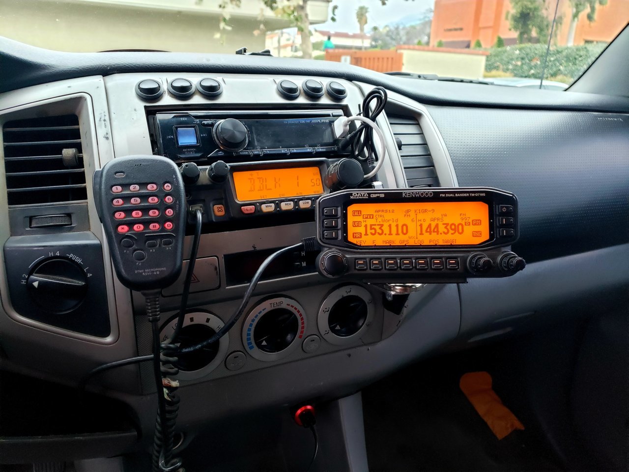

    Cudgel
    Cudgel “Tonka”
    Mar 28, 2017
    #214640
    4,315
    Live in: An Ocean of Plastic Trash
    2017 OR DCLB
    ICON8 Lift -285s. upTOPoverland rack.
    Gen3 overhead console mount here. Check out the clean installs thread.
    www.tacomaworld.com/threads/clean-vhf-cb-radio-installs.415584/

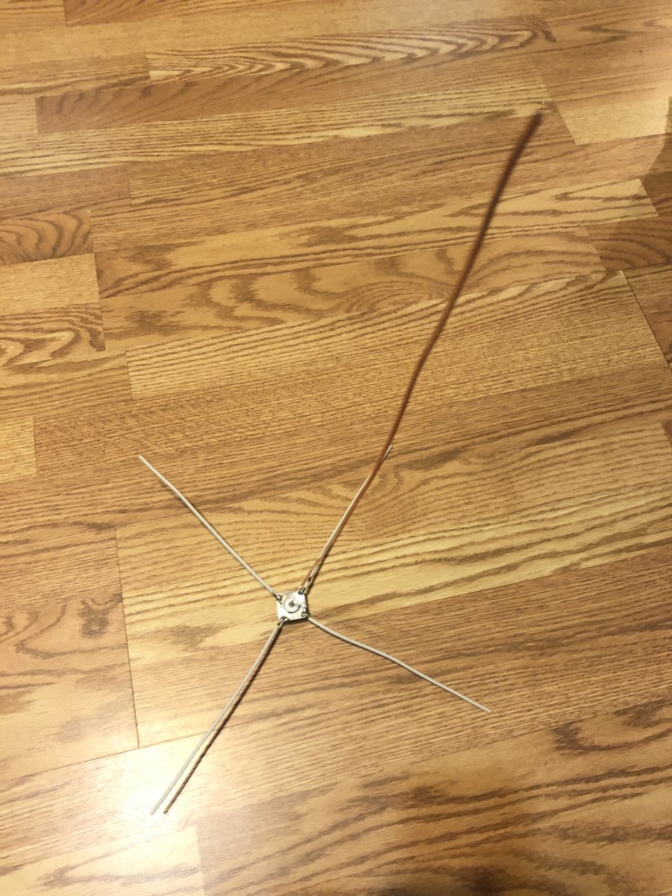

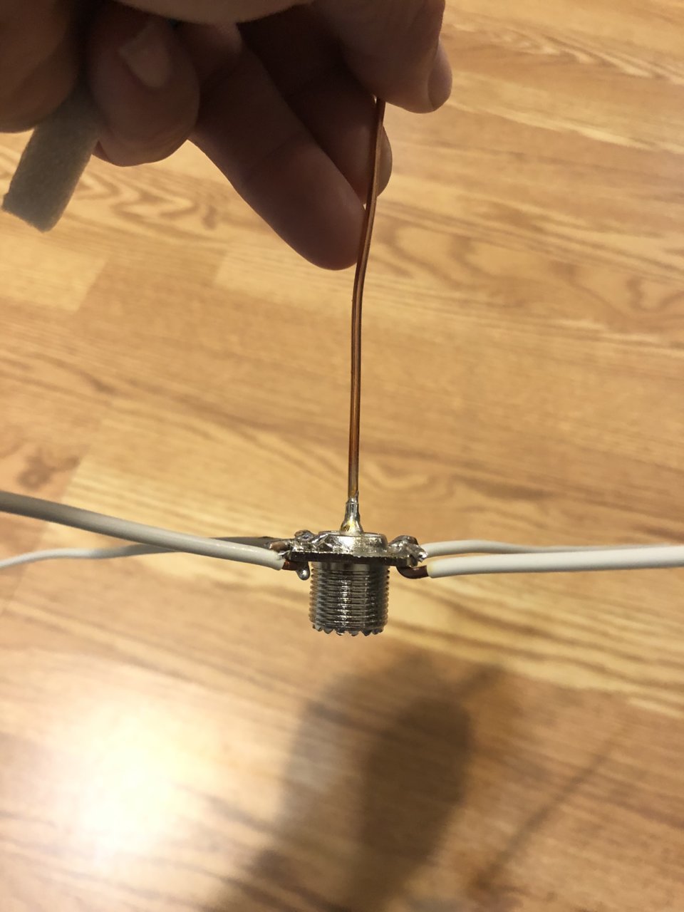

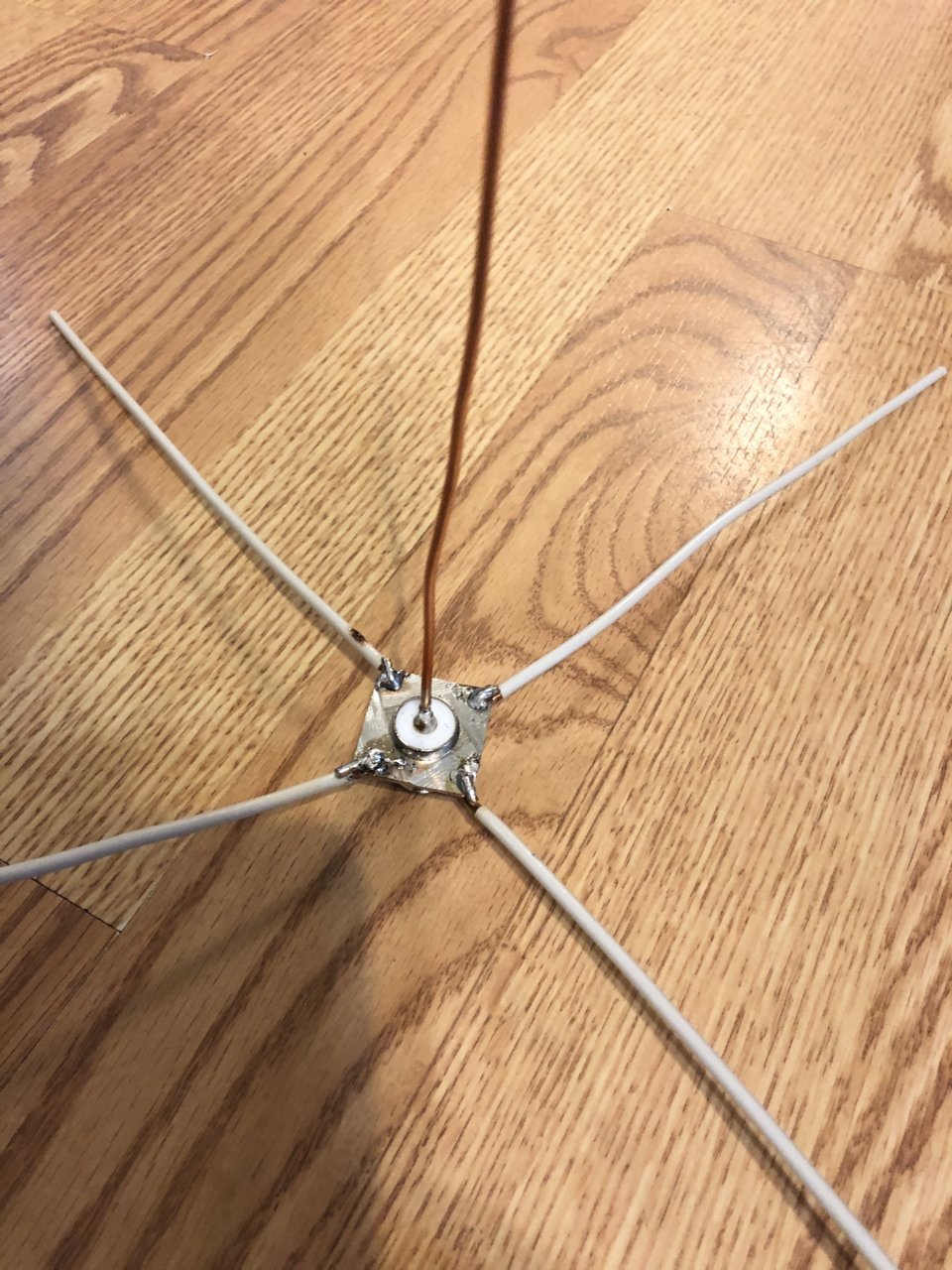

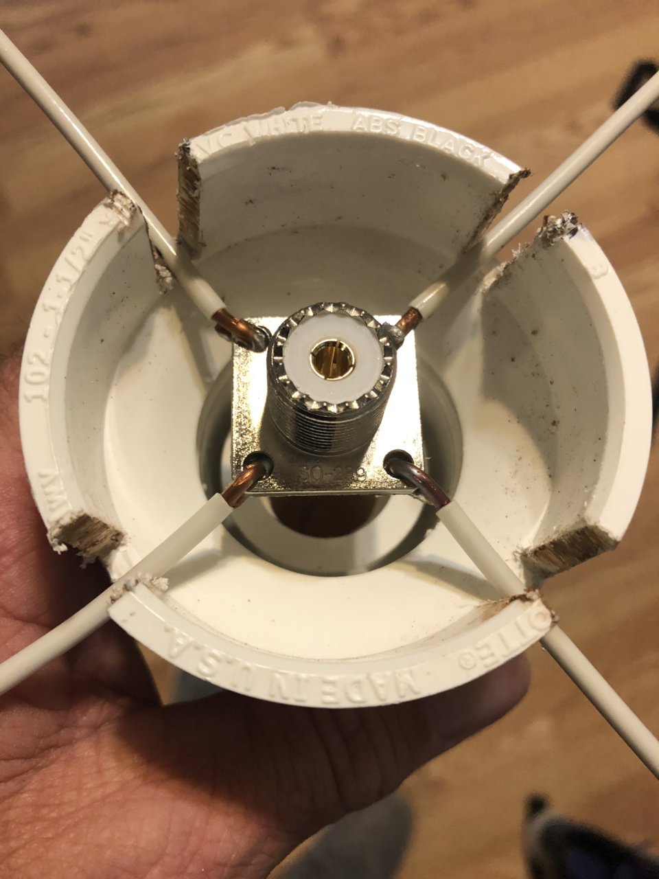

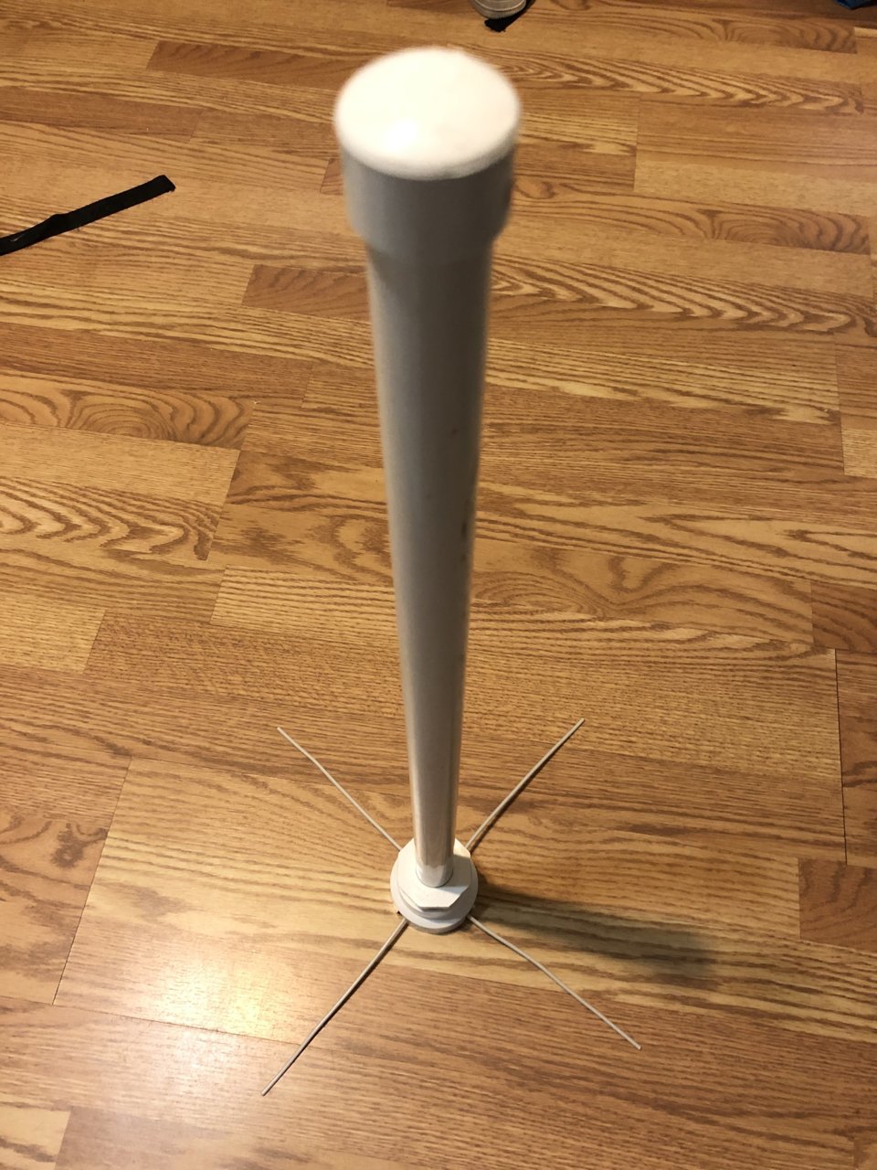

    medic2230
    Oct 13, 2008
    #9942
    63,971
    Murph
    Bama! Roll Tide
    Built a dual band base antenna for the house this afternoon using a SO-239 chassis connector, some 12ga romex and pvc pipe and fittings to dress it up.

    Marteeen
    New England
    2017 Tacoma DCSB OR MT
    Lots of sail boat fuel
    Gonna talk to space ships with that right there.

    Should be excellent into the new repeater about 50 miles away with it.

    maineah
    maineah Well-Known Member
    Mar 24, 2011
    #53641
    6,811
    Tim
    Maine
    4X4 SR5 V6 6spd
    Your going to want to bend your radials down at about a 45* angle,yes it will "work" on 440 but not real well.

    Oct 13, 2008
    #9942
    63,971
    Murph
    Bama! Roll Tide
    Yeah I knew about bending them down. Was waiting till I got it outside to bend them when I was mounting it. It’s just something to use till I recoup from the 991a purchase. Haha
    Going to build a 6m dipole also.
