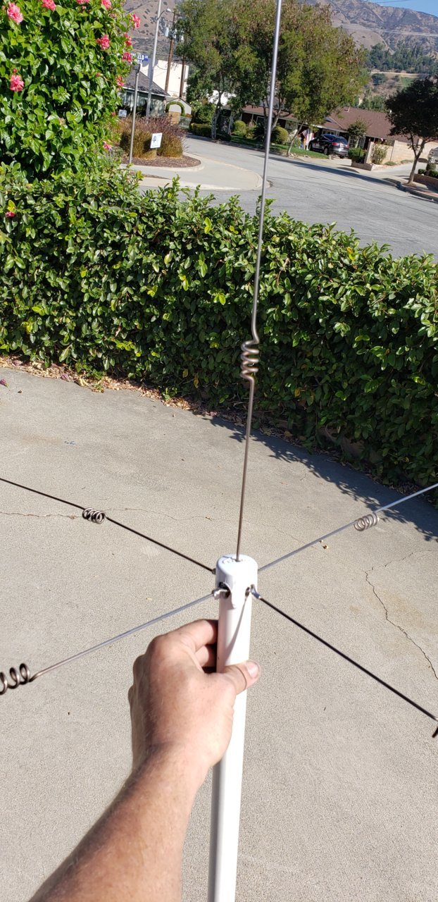

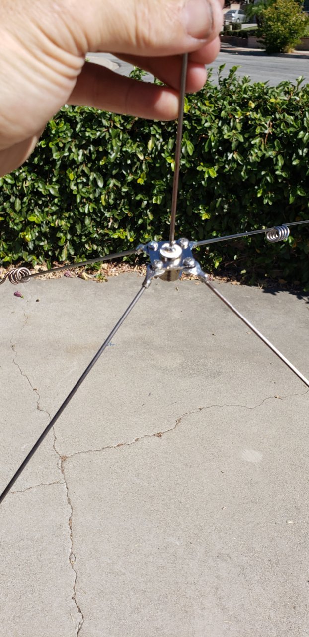

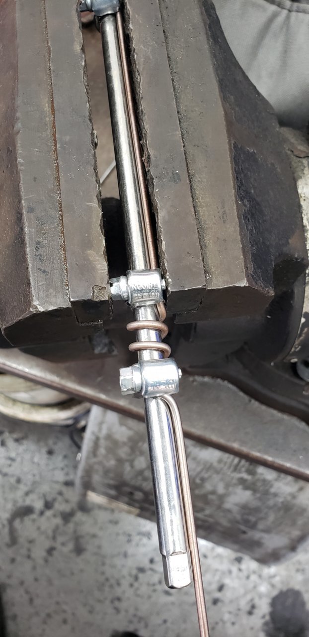

    I made my own 2m/70cm ground plane antenna using 3/32" welding rod and a SO239 chassis connector.

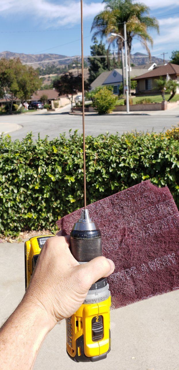

    I found an old tube of welding rod that's been sitting in a corner since the beginning of time. Too rusty to be used for welding so I made good use of them.
    A drill and a 3m scotch pad took care of the rust, good enough to use as radials. I'll probably need a tetanus shot because I didn't wear a mask, I breathed in more rust dust than I should've.

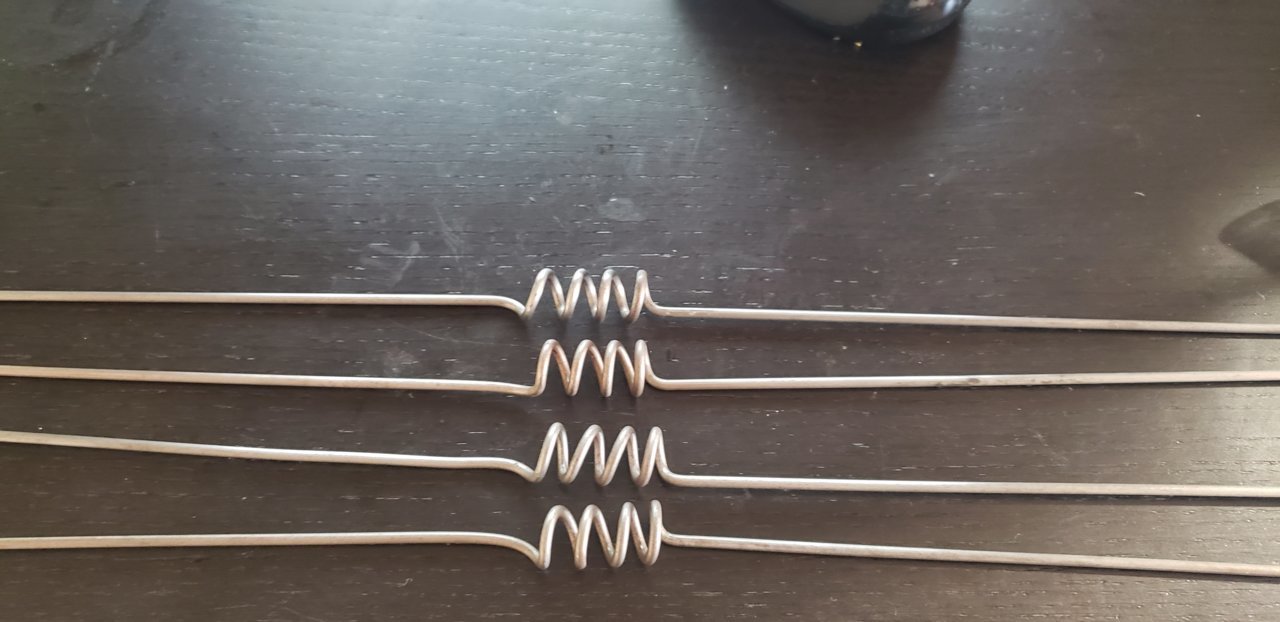

    Used a 1/4" extension as my dowel to create the coils. The length of the coil is about 1-1/4" with even spacing in between each wrap. I made a few and picked out the best of the bunch. The 2m side is 9-1/2" long, and the 70cm side is 6-3/4" long.

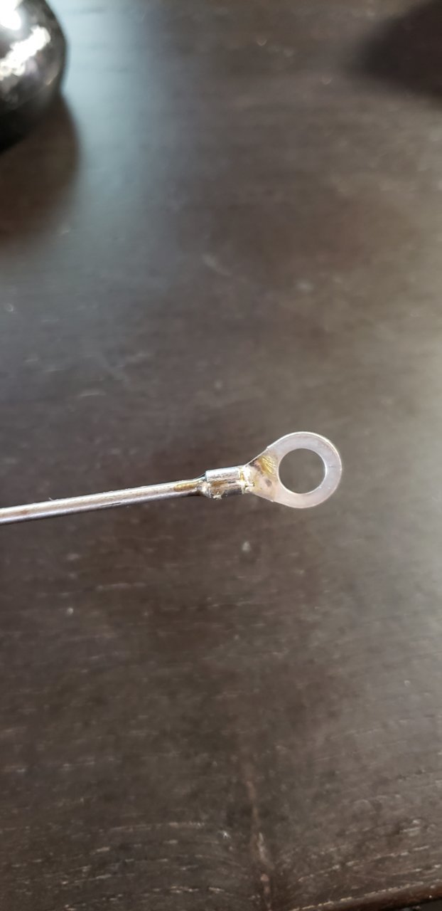

    Soldered the short 70cm side to ring connectors:

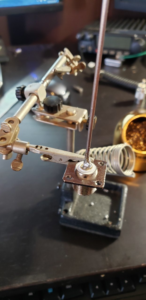

    Vertical radial soldered in place to the SO-239 connector:
    And the mostly finished antenna. I just need to figure out how to weatherproof it:

    Mine didn't turn out too hot. Receive is fine but I can't get into the 70cm repeaters with it. Works fine on 2m though. Think it's probably just a bad combo of using third harmonic for 70cm and the crappy 100 ft of RG-8x coax I'm using. Not t mention it's on a 10 ft mast. Going to work on it tomorrow some more and if no joy probably go with a Comet base antenna to be sure I'm in on everything around me.

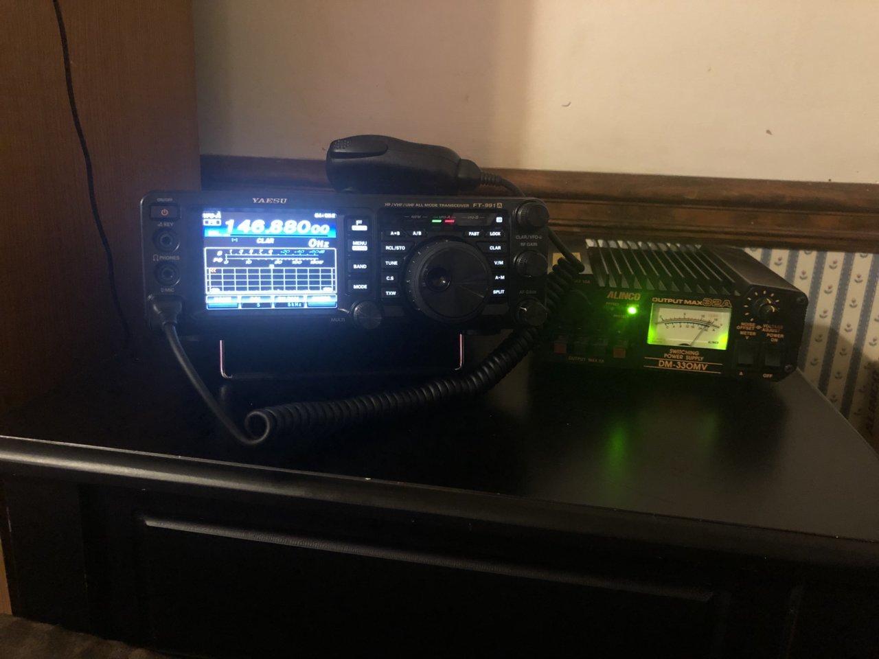

    but good news is I finally got the new rig out of the box and hooked up and running. Going to work on a 6m dipole next for it.

    you need to create coils. the coils act as an RF choke separating the two bands.

    Your's was the first one I've seen with coils made like that. Might need to try that then instead. Thanks!

    You'll achieve what your looking for. You essentially made a 2m ground plane antenna.
