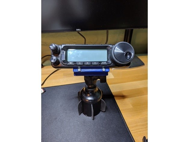

    :anonymous: it's in the works haha. Here's a sweet cup holder mount though. And I'll be mounting the Atas to a prinsu rack

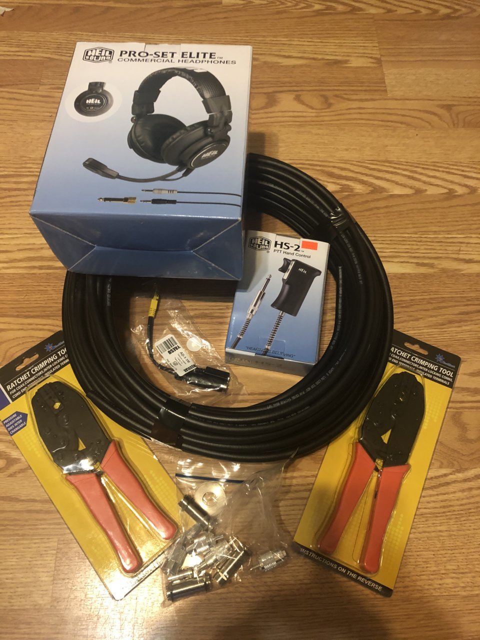

    My haul from Hamfest today.
    Heil Pro Set 6 with Yeasu adapter and PTT hand switch, 2 coax crimpers, 4 PL-259 connectors and 3 pass through connectors. Then 100’ of RG-8 from Wireman.

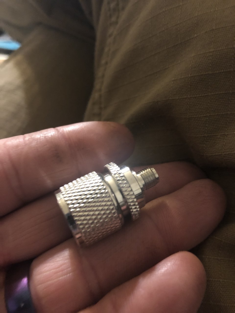

    And...a SMA to UHF adapter.
    Along with a year of QST back issues a guy was giving away. Lol
