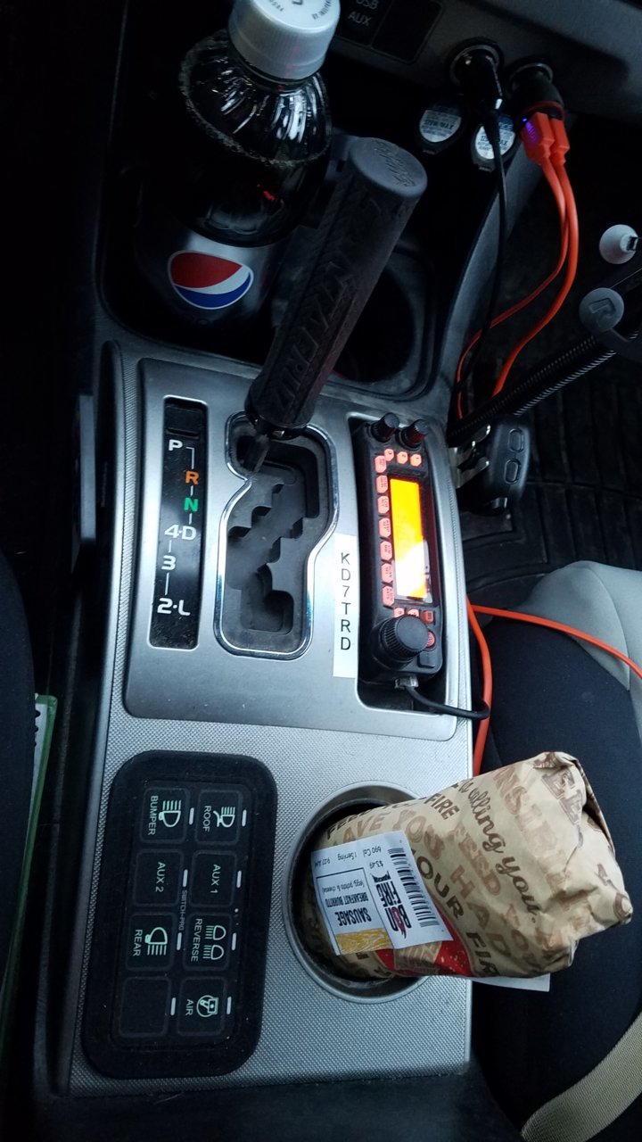

    Yaesu 8900 fits like a glove in the pen slot.
    Edit: This was the older 7900 model before I upgraded

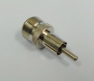

    You could. You can also use an adapter the Motorola Plug to perhaps a PL259 UHF to use a standard antenna mount, too.
    https://www.ebay.com/itm/NEW-Female-UHF-Jack-to-Male-Motorola-Plug-Adapter-/261236428363
    Car radios are odd in that car radios expect their antenna feed lines to be about 100Ω (give or take, could be anything from 93Ω up to 125Ω). If that Larsen is designed for a mobile installation it might be designed for 50Ω mount so there could significant mismatch.
