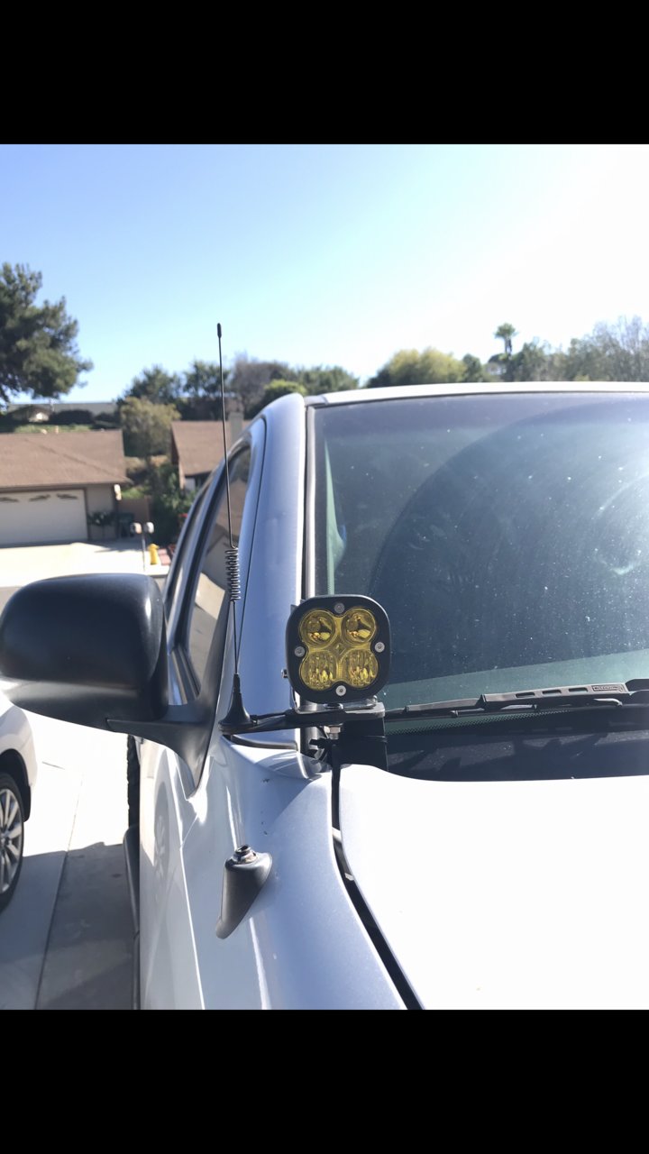

    How would I find out if it is 50? I bought a used fender and the mount was super messed up and stuck, so I used this super small AM/FM antenna. Doesn’t work too great. I am going to be adding some VHF antennas to the roof in the near future so I thought I might as well see if I can use a NMO antenna for FM radio. I have had a kenwood tm281 for a couple months. Just waiting until I test to get everything installed.

    You can measure but it would take some test equipment. Larsen will probably list the specs for anything they sell.
    ETA: Looking at Larsen's page they just say it's a 1/4λ whip so it'll technically be 36Ω. That's not unusual and typically no matching is done to 50Ω anyway because the loss is acceptable (about 3%). It'll be more if the characteristic impedance of a car radio really is roughly 100Ω, but still perhaps a VSWR less than 3:1, which for reception isn't going to damage anything even if there's getting to be considerable loss (about 25%).
    Coax should have a manufacturer and type printed on it. My feeling is even if there's a mismatch in impedance it'll still work better than the majority of stock commercial radio antennas.
    The NMO model is NMOQ88C.
    https://www.theantennafarm.com/catalog/larsen-nmoq88c-3198
    There's a cheaper Larsen Q88, too.
    https://www.pulselarsenantennas.com/product/q88-2/
    https://www.theantennafarm.com/catalog/larsen-q88-8075
    https://wingsandwheels.com/q88-antenna.html
    It looks like to me the cheapest version is an LM, which appears to be a simple threaded stud.

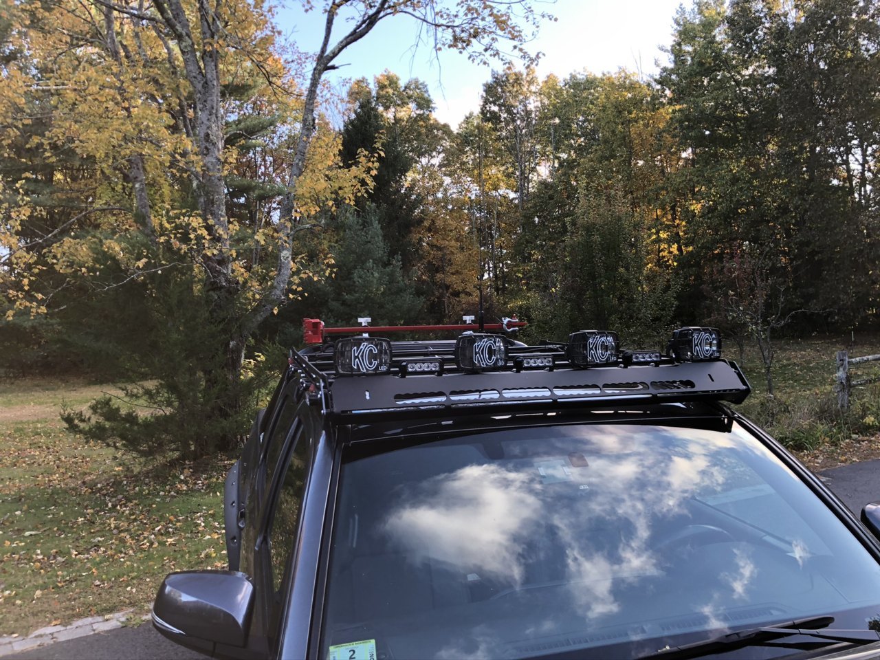

    I need to make one for the hf antenna

    1/4 wave on 6 meters is damn close to 60" FM band is around 1/2 that. So bottom line either way it's not going to work worth a hoot. The shortest thing you can get away with is a 1/4 wave antenna no matter what frequency you intend to use. The antenna you have without measuring is probably is a dual band 2/440. Measure it, it should come out to like 19"
