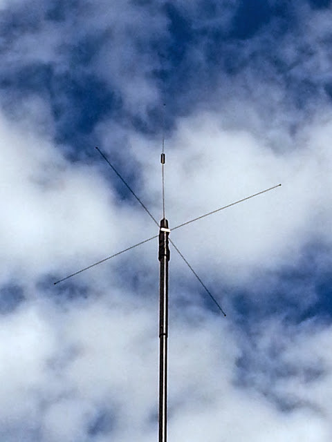

    I do have a portable install (20' mast) which consists of a 10' section of steel pipe and a 10' aluminum pipe. They go on the roof rack, must be guyed out in order to work. For my antenna I use Larsen 2/70b dual band antenna with base station kit (Ground plane radials). I use ultraflex-240 for feed-line. At home I connect it to a hand held and run 4W power and talk just fine in 45 mile radius.
    I would recommend to you to use Ultraflex-240 coax (or equivalent) for your feed-line. It's a great balance of lightweight, portable, and flexible. It's affordable too!
    Picture of antenna:

    That's a nice setup.
    I hate those fiberglass poles. I think I going to get the pole BenMara reccomended. I had already found them online. I am going to built a drive-on plate myself, they are basic and shipping from anywhere would just be expensive. Thanks for the advice on the feedline. I think I am looking at about $300, plus the base plate to do it. More than I was originally thinking, but still within a doable range.
