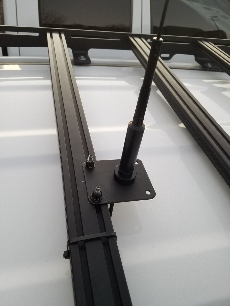

    Cross reference from another thread so hopefully I can get more responses.
    Glad this thread came up. I’m taking my test this weekend after missing the last two and making the best of my time and continuing study. I decided since there’s no extra cost Im going to go ahead and go for my general license just because why not. I still have a lot of learning to do. I currently have one of the baofang Hand helds just so I can get used to the radio.
    can some suggest another unit for my truck? I don’t want to spend big bucks for something like the Kenwood 710 but something comparable would be nice.
    Also second part is I want to go a hard nmo mount in the roof of the truck but I have a roof rack similar to the prinsu. Am I going to run into any issues with that ? I really don’t want to tell my wife, “hey you know that really nice roof rack we just installed..... it’s gotta go.”

    I'd bolt a bracket to the room rack and install the NMO in that. Get a "high frequency" NMO as they're weather proofed better on the bottom since it would be exposed.

    So you drilled into your roof rack instead of the cab ? If that’s so I’d rather do that then the truck cab. I didn’t know if the breaks in the bars would limit the ground plane

    I drilled the cab. I don't have a rack.
    Check for DC continuity. If the resistance is low it will work fine. If it's high, then add ground straps.

    That's what I did and I have no issue hitting repeaters or simplex use even way out in BFE.

    That’s exactly what I would want to do. Did you just buy a plate and drill
    It or did you find a pre drilled plate?

    That's the plate backer from an ARB air compressor I had laying in the scrap / spare parts bin. But it's just a piece of 1/8in steel about the size of a playing card. Drill an NMO sized hole in it and good to go. It was handy because the bolt holes in the corners were already 1/4 inch.

    Awesome. Thank you.

    You can also just get a lip mount for the side of the rack if you have a prinsu. Allows you to easily rotate the antenna down if need be
