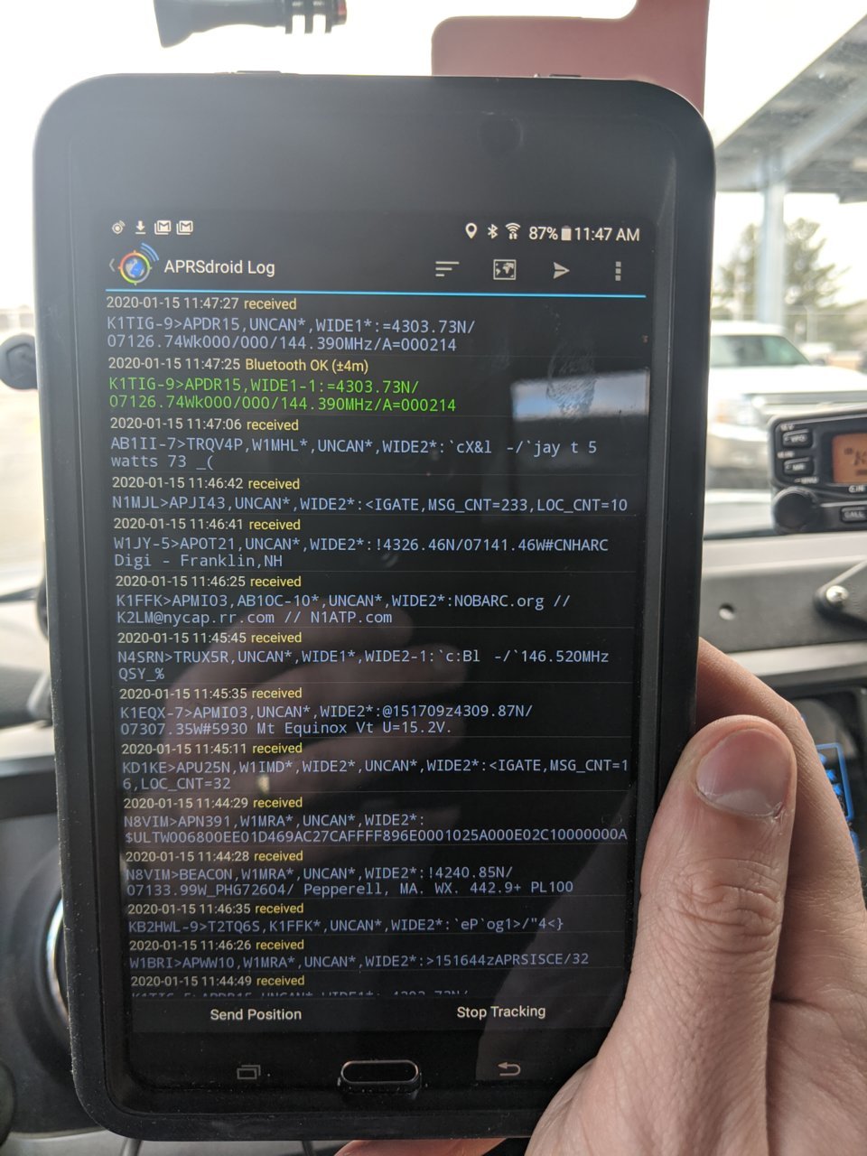

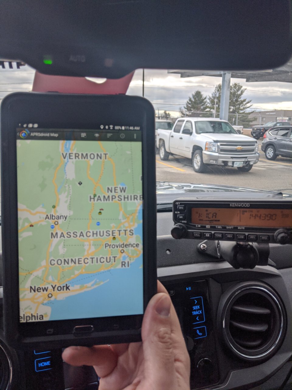

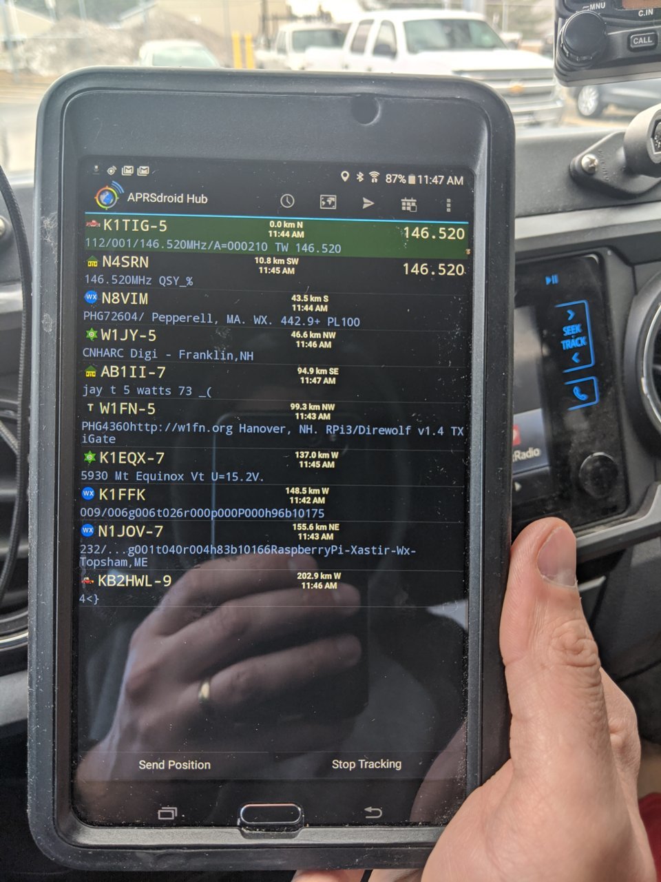

    Basically you sacrifice a good satellite rig, some digital modes from a computer (non voice), and the ability to run a real time map like this (beyond a GPS Garmin or what not).
    MVIMG_20200115_114656.jpg MVIMG_20200115_114712.jpg MVIMG_20200115_114738.jpg
    Phessor and DaveInDenver like this.
