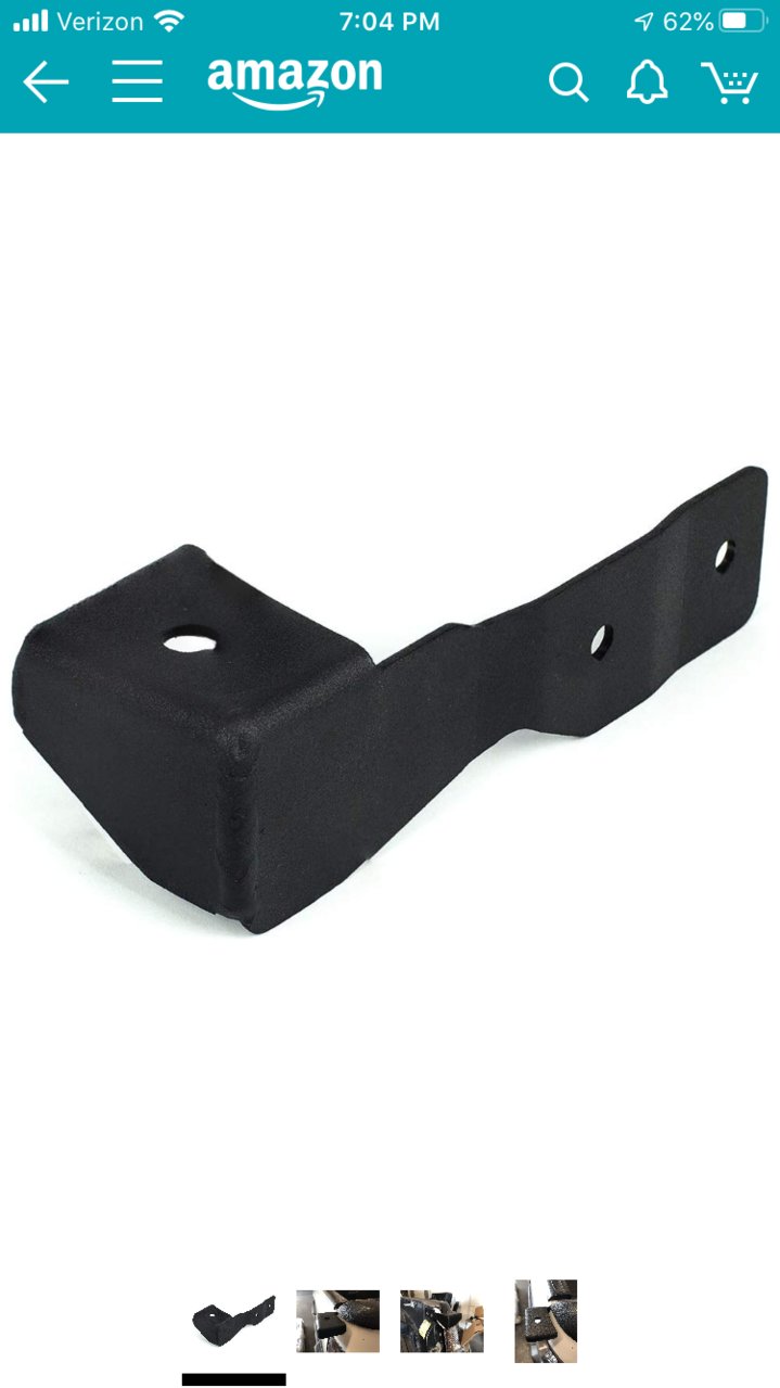

    Planning a mobile VHF/UHF install in a 2010 Tacoma with a shell. I like the antenna mounting off the rear, similar to the attached pic. All my research says a no ground plane 1/2 wave or 5/8 wave...any recommendations on an antenna for this use?
    Thanks!

    youd better run copper braid for a sup par ground.... I cant emphasize how important a ground plane is in any antenna system.... www.k0bg.com read up!!!!

    I’ve spent some time on that site...would you recommend not going with that location, or think I’d be ok with bonding it?

    Personally... if you cant drill a hole in middle of roof or no bed shell to drill a hole in center with sheetmetal under as a ground plane... yes... just do as K0BG states for grounding body to frame.....

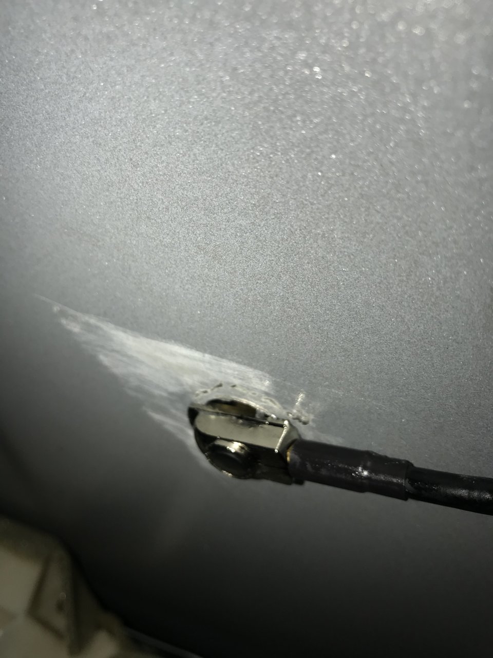

    Anyone ever had trouble with water leaking after a roof NMO mount? I installed mine today and made sure everything was proper, and when I tested it with some water it leaked a little bit. I thought that single o-ring was suppose to keep water out? I could also see some “light” from outside. I removed it and added a little silicone and now it does not leak, but still.

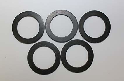

    I do still have these for the outside

    Did you over tighten the mount? If you tighten it too much, it will cause the o ring to deform and let water in. It just needs to be snug

    I used a pretty small adjustable wrench and just went snug. Definitely didn’t crank it too much.

    I have never seen one leak. How did you make the hole? The single o-ring should do fine. I always take my antenna off through the car wash, and that's the only gasket.
    If the hole is mangled or too large, this may work for you:
    https://www.breedlovemounts.com/nmo-roof-mount.html

    I added an aluminum backing plate to the underside of the roof, and put a bead of silicon sealer around the underside of the roof (it also held the plate to the roof while I was installing the mount)
    The forward mount is and NMO, the rear one is a K40.
