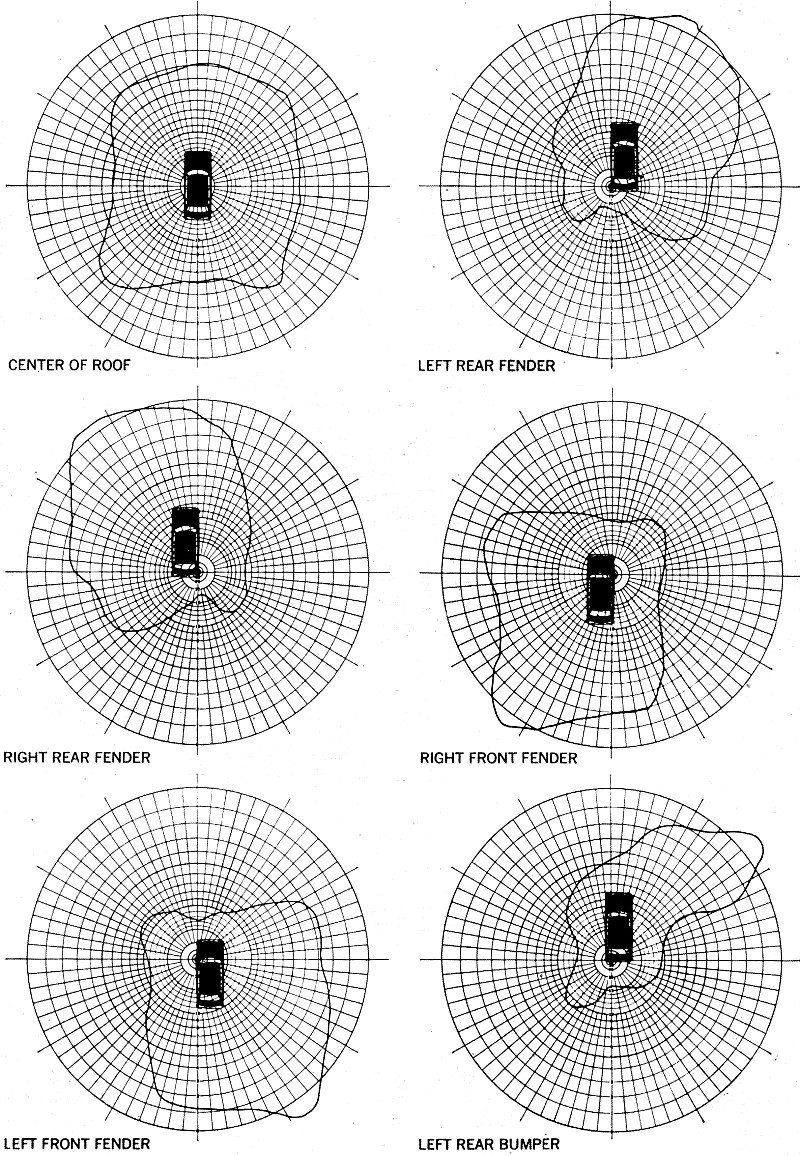

    Good morning! Thanks @Cudgel for pointing me to this thread. Seems like y'all have a wealth of knowledge here.
    I'm looking for the best reception for a GMRS setup (haven't made the leap to HAM, but I do have my GMRS license).
    I'm "missing" or not hearing some radio traffic, and am not 100% sure why, but I'd like to mitigate it. Photos of my current antenna setup are on the bottom.
    Radio is the Midland MXT275
    If possible, I'd like to keep the same location, but maybe change to this antenna. It's 5" longer, so should reach a bit higher over the truck.
    https://midlandusa.com/product/micromobile-mxta26-6db-gain-whip-antenna/
    Or I could change to this:
    https://midlandusa.com/product/micromobile-mxta25-3db-gain-ghost-antenna/
    I could mount that to my Prinsu rack, probably to the side of my sharkfin antenna, between my camper shell and the cab.
    I prefer the first version, but if the second is likely to give me much better communications, I'll do that instead.

    I'd suggest a bracket on the roof rack for an NMO and a simple 1/4 wave.

    Yes.
    pickup truck
    2 antennas that close together physically = extremely NG
    Zip tying coax together is sub optimal.
    Skinny VHF coax = super mondo losses.

    I’m assuming this is showing “dead zones” around my truck based on antenna location?
    Does it matter that part of the antenna sticks above the roof, or is it more important that the majority of the antenna is blocked?
    So basically everything about my setup is bad. :(
    When y’all are talking “1/4 wave” antennas, is that length of antenna relative to signal wavelength?
