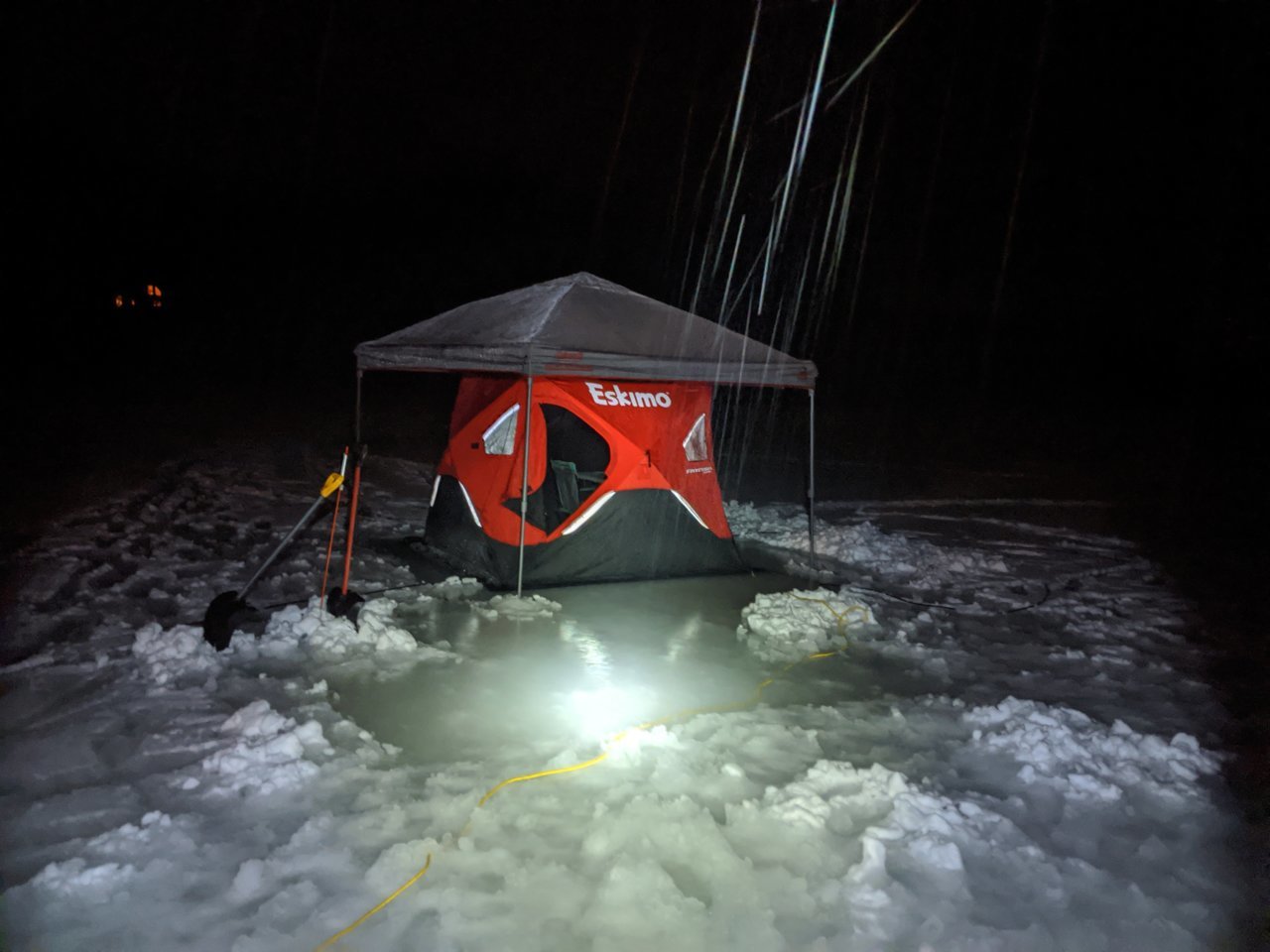

    That's hilarious, because that's the exact shelter I was considering. I was also looking at a cabelas branded hub shelter. I do lots of portable operating, it'd be my shack.
    Your photos confirm a suspicion I had: whether those hub ice shacks are water proof. I was speculating no one uses them in the rain and I'd need some sort of rain fly.
    Looks like you had lots of fun. Embodying the spirit of the contest. Where were you operating from?

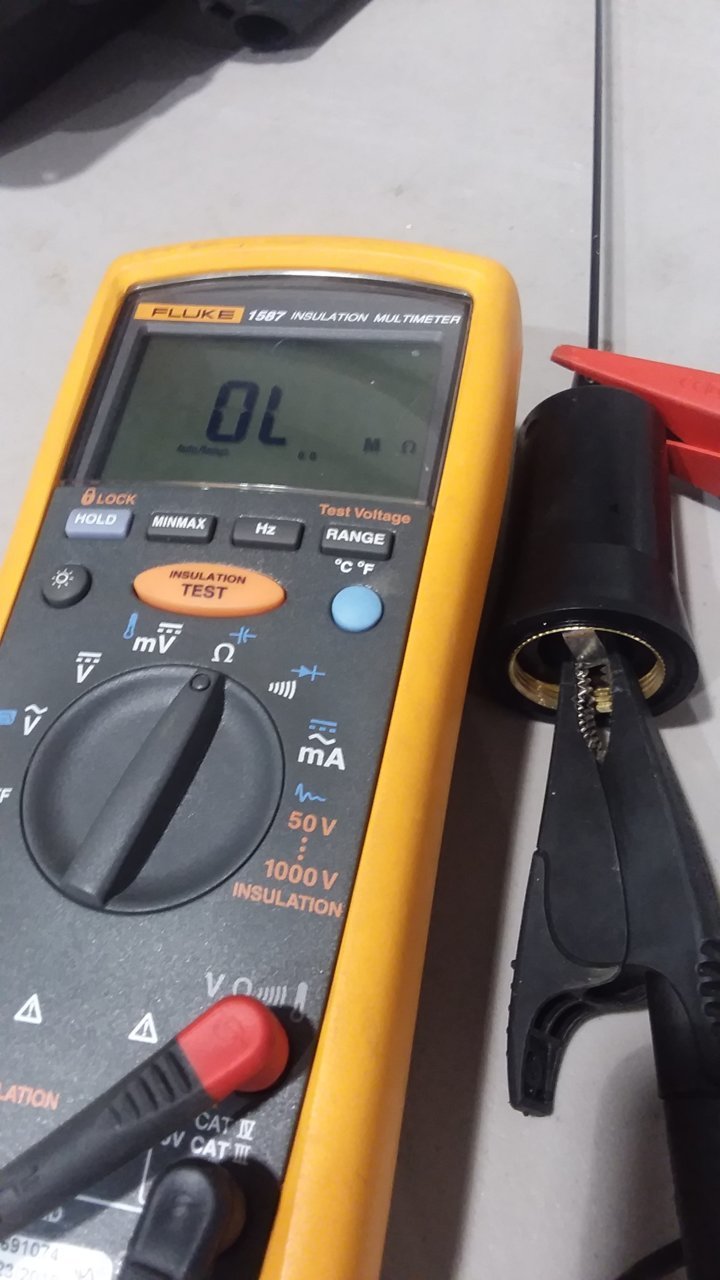

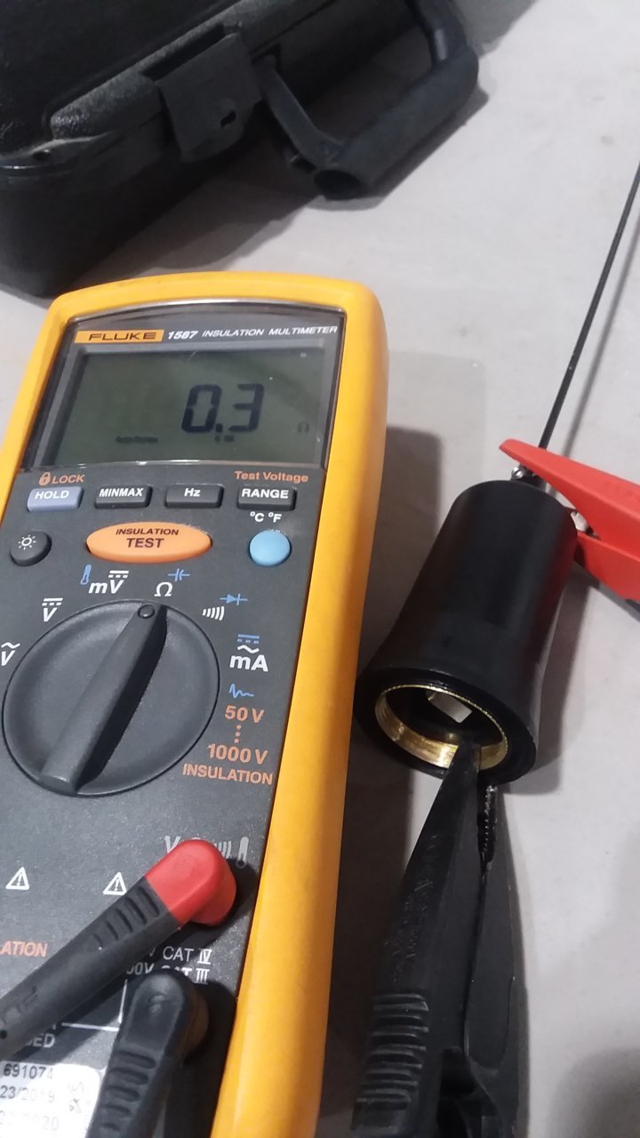

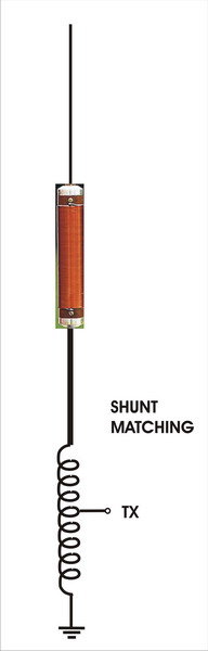

    My Larsen antenna is jacked. Tell me if I'm wrong but... isn't the center post on the NMO Larsen supposed to go to the radiator? Mine is wired backward. The threaded sleeve is connected to the radiator.

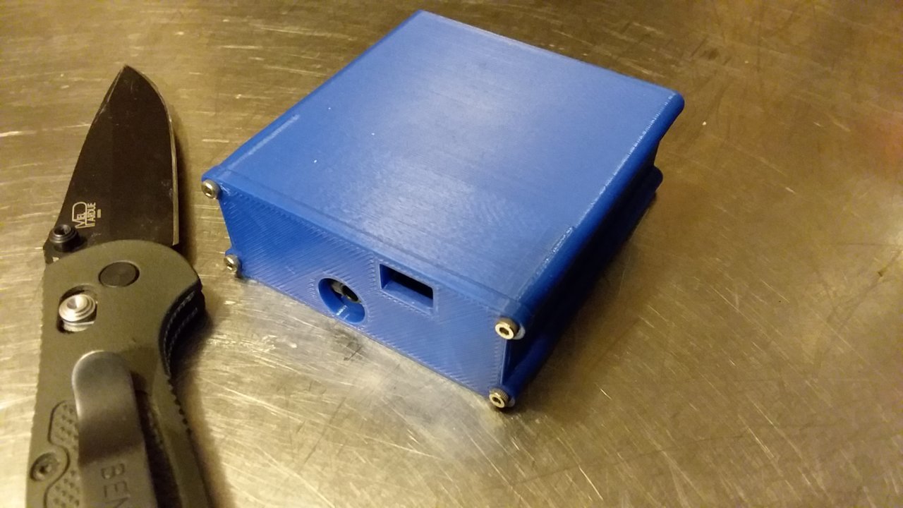

    APRS is up and going. Home brew TNC1 is working fine after setting the correct baud rates between the bluetooth and microcontroller. Printed an enclosure for it to make it nice and tidy.

    Which Larsen is it and how did you conclude it is backwards?
    Short answer is this might be correct or it might be shorted. If you're using DC resistance on a multimeter then what you're seeing might be right. Remember that the antenna is designed for RF, e.g. AC, so an inductor will look like a very short wire resistance but will have an intended impedance.
    The only antenna that has a characteristic impedance close to 50Ω is 1/4λ and as a result they do not need an impedance transformation. Other antennas, especially 1/2λ antennas, need to make their impedance match the radios and so will have matching networks (meaning a circuit with capacitors and inductors) that might look odd at DC if they are inductively coupled to ground.
    IIRC I noticed this on my Larsen 2/70 and so I just assumed they used a shunt in the network. This is a highly generalized idea but a matching circuit like this will look at DC pretty much like the whip is shorted to ground, although if you measure it'll actually have a few Ohms of resistance.
    Also, if there's capacitors in the network they will look like opens at DC, not to mention might be polarized. So if you reverse the leads a cap may conduct for a while until it's charged.
    Now if you've swept the antenna with an analyzer and it appears shorted then it could be faulty.

    It is the dual band larsen NMO (NMO2-70B).
    I understand some of the weird theory of impedance and inductance but this still seems backward.
    Isn't the impedance of 50 ohms generated between the radiator and ground plane under load? I don't expect to see 50 ohms across the shield and core with a multimeter but I do expect the center post to be connected to the radiator.

    You will generally never see 50Ω measuring RF devices at DC. It sometimes happens if there's a resistor in the circuit but that's an exception. With antennas you will typically see either an open or short with multimeter, so it's one data point. You should never see coax with unterminated ends measure anything except open with DC, though.
    What I mean by DC is 99.999999% of handheld multimeters (should be all, but I can't say for sure) put a DC voltage on the circuit then measuring current to find resistance (this is Ohm's Law). Impedance isn't resistance.
    An impedance meter can do it but that's going to be a specialized piece of test equipment because the impedance is frequency dependent. That Larsen will present about 50Ω at 146MHz and 440MHz but at any other frequency it will be something else, hopefully very high impedance. So what you use and how you use will be more involved than just setting a DMM dial.
