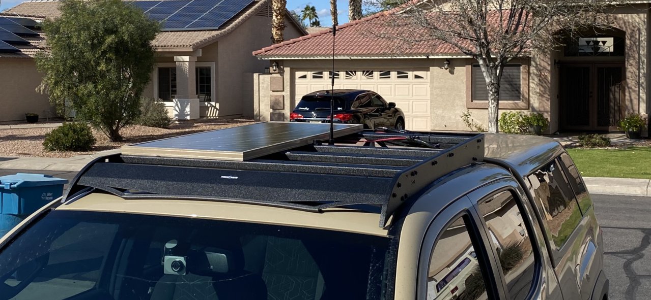

    you can pick up agm deep cycles for pretty cheap. $50 for a 35ah on Amazon. Figure out what the true amp draw is on receive, add in what it is on TX at the actual wattage you need for event, and figure out AH needs. I went big and put a deep cycle behind my rear passenger seat and installed a solar panel lol. Or at first I just had an 80 watt folding panel I’d setup to help reduce the battery discharge.

    Here’s mine!

    The 100 watt solar panel was $79, not Renology but I’m sure it’s all from the same place lol. It produces 4-7.5 amps at 14.2 volts in the winter AZ sun.
