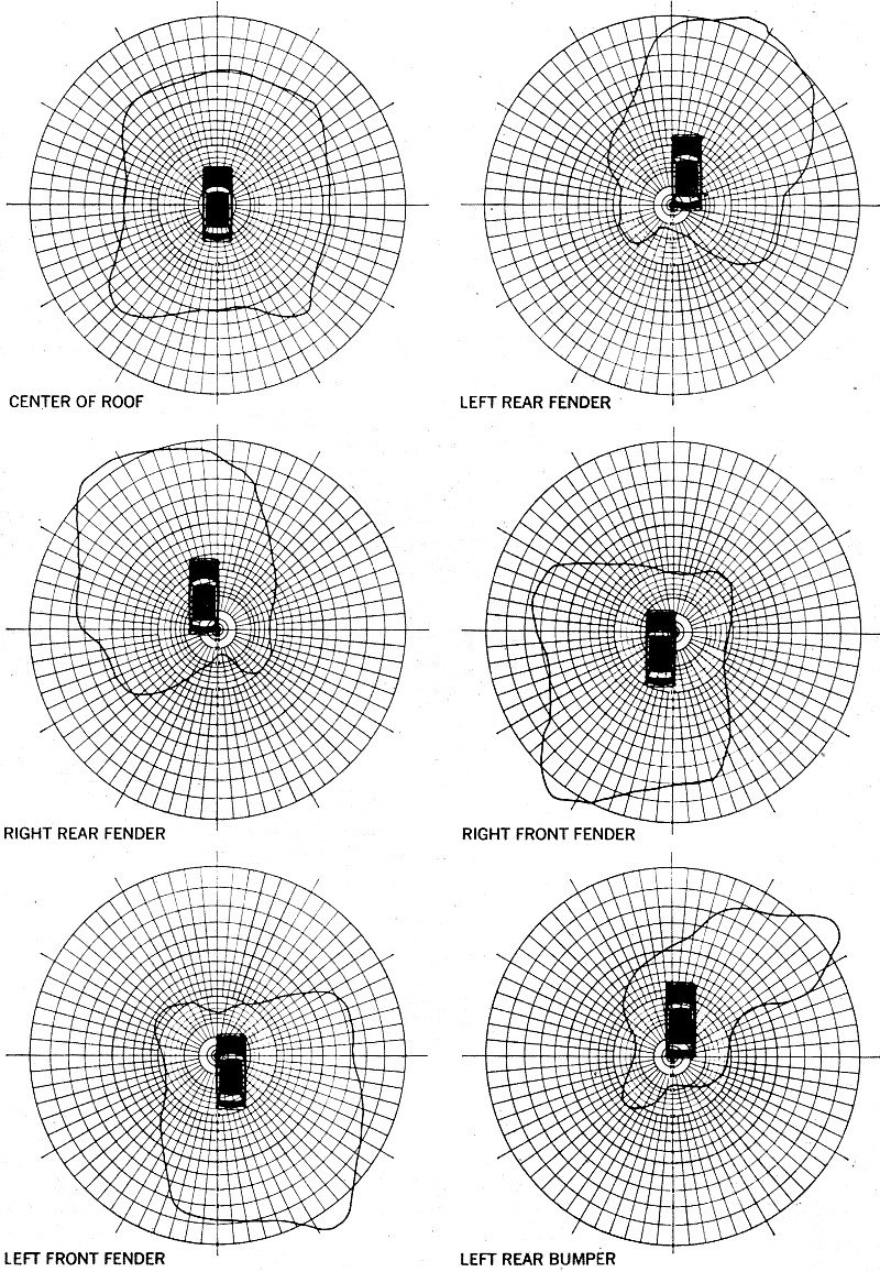

    ok so I sold my roof rack. Ordered a new one but I don’t want to do center roof again. Anyone got a pic of the lip mount they used ? I don’t need one with a cable just a lip mount. Also would it be better since my cb is on passenger side to have the 1/4 wave on the driver or does it matter ?

    Which way do you want the radiation pattern to be stronger?
    While this is geared towards a transmitter with a bit more push, theoretically a CB will have similar lobes. In reality get your SWR clean and anything on the roof will be about the same as you’re governed by the frequency/mode/wattage limits.

    One if the biggest issues with any mobile antenna is ground loss not ground plane but ground absorption so don't sweat the ground plane myth too much.

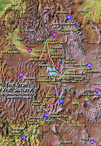

    Cool man! Once you get on the air, we can totally get a conversation going over the intermountain intertie. Basically a connected net of repeaters that goes from Vegas / Northern Arizona up to Montana. Hit one, and we can hear you on all of them.
    Print the below PDF and stash it in the truck. Good for if you get stuck and need help a ways from anywhere.
    http://rexburghams.org/assets/IntermountainIntertie.pdf
