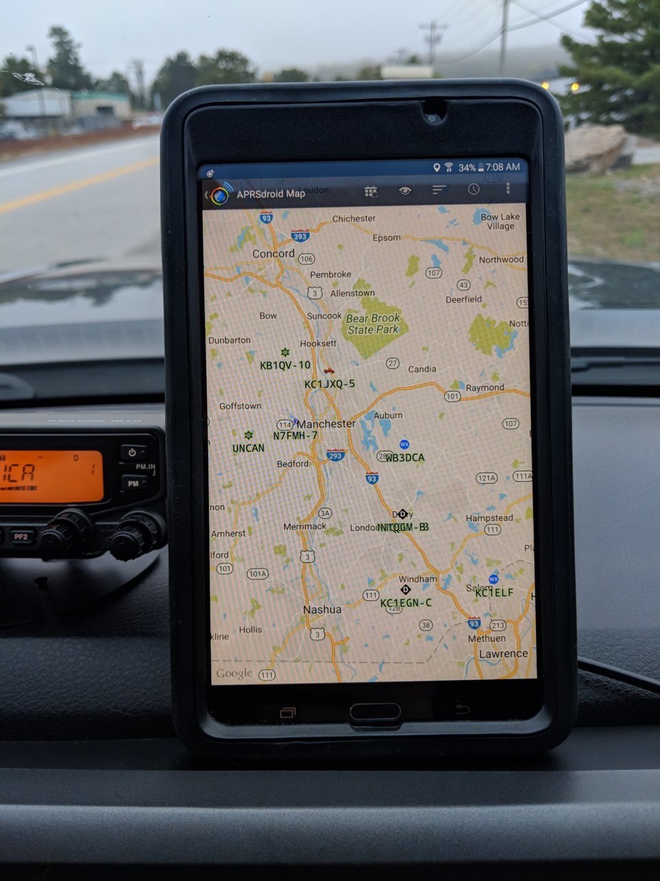

    Yup. The real dividing line is if you want to be able to use it with a tablet, phone, or computer. That's the only way you'll be able to get a map with that info, instead of just a callsign, with a frequency and heading.

    I have a Yaesu 8900 in the truck, but since they dont do external data, I have a Baofeng with an audio cord connected to my tablet. APRSDroid and Gaia run on that. It goes to a separate antenna. That way I can dual monitor comms, and have a dedicated APRS feed.
    Chipskip and m603holden like this.

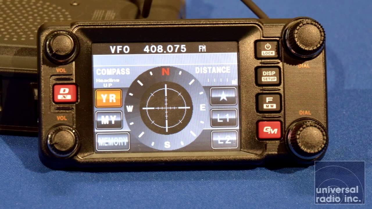

    @Old Marine Cal, and all others who are looking at aprs. I'll try and make this somewhat of a clear outline on APRS rigs and the options you have to weigh. I'll work from the top players down, to show what you lose as you go down the list.
    All rigs have 50w power
    Yaesu Ftm-400 - $498
    Has: Digital voice, wires x (for talking through the internet), fusion, cross repeat, Dual monitor, APRS*, and beautiful touch screen. I also love the way the stock audio sounds out of it. Very rich.
    *APRS in this rig is only self contained. Nothing can connect to it . It has no maps. Just a heading, shared data like speed, distance, monitoring freq and messaging.

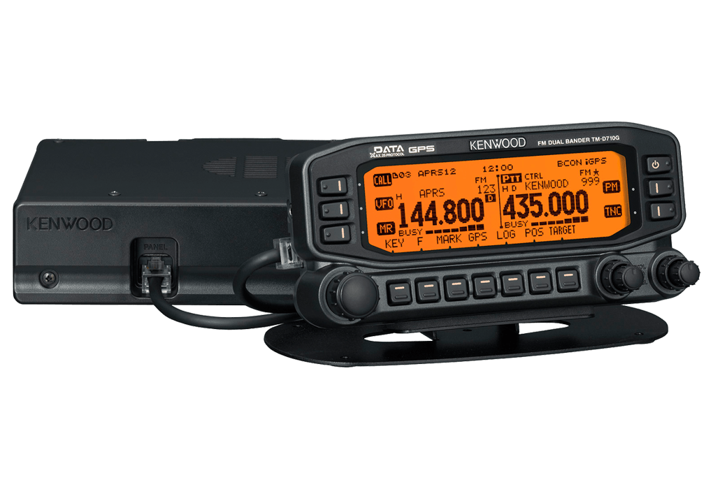

    Kenwood D710 - $530
    Has: Cross band repeat, Dual monitor, Full APRS*, echolink quick setup
    It's missing the Yaesu digital items, but that's all relevant to if folks around you are a big Yaesu community. This is your purpose built APRS and x repeat rig. There's a reason why ARES uses the heck out of this rig.
    *to add a map you'll either need to connect it by cable to a laptop, tablet or Phone. Can be as cheap as a $12 cord or up to $65 for this device which allows a wireless connection between the radio and anything with Bluetooth.
    Kenwood Tm-v71a - $344
    Has: Cross band repeat, Dual monitor, echolink quick set up.

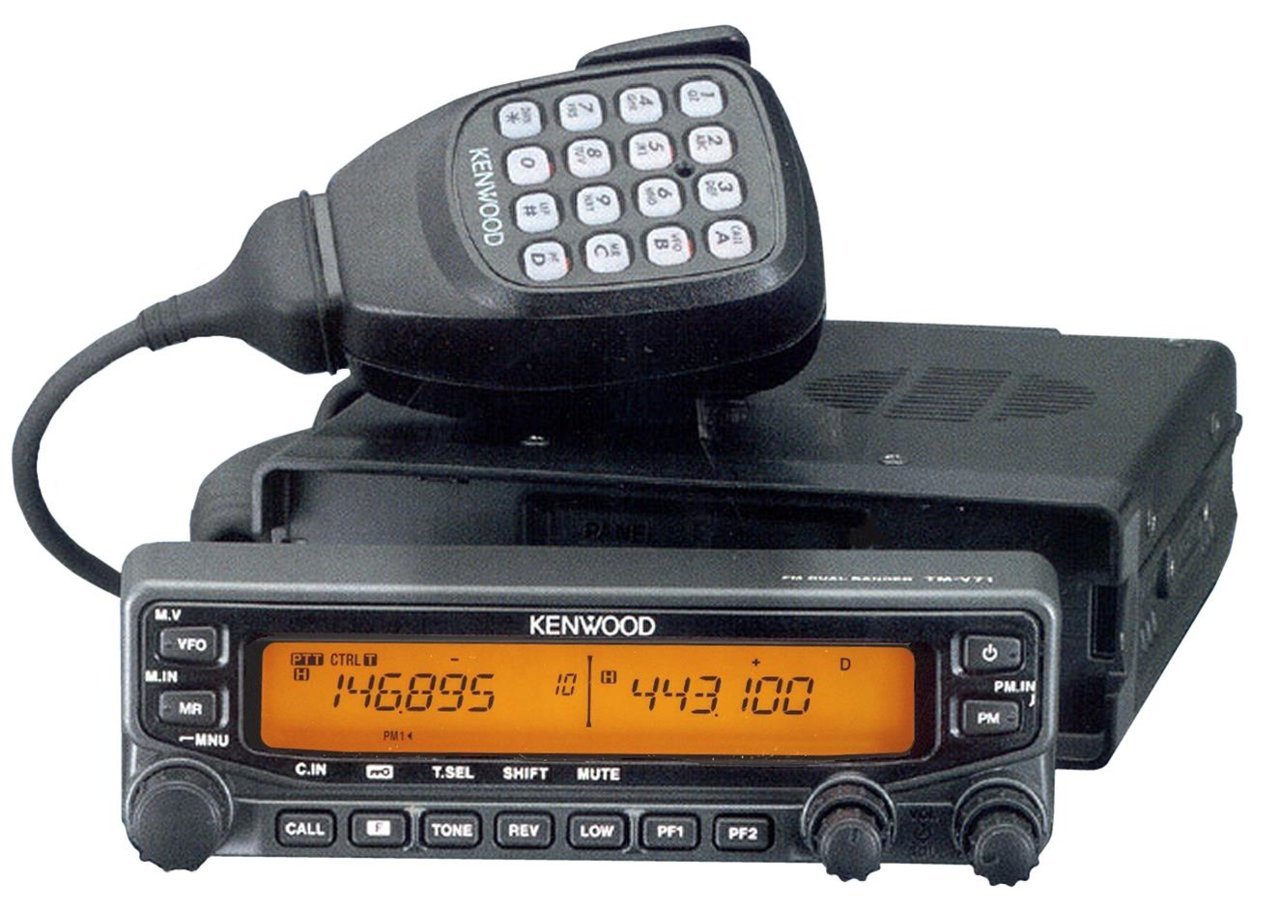

    The Tm-v71a does not naively have APRS. But with the addition of the Mobilelinkd device you now obtain that ability, including the ability of the map which the D710 has as well. These are the only two that can have a map. This is what the screen for the set up looks like. Here.

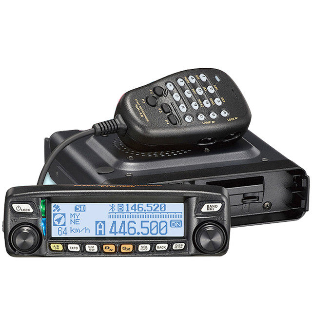

    Yaesu Ftm100 - $275
    Has: Digital voice, wires x, fusion, same type of APRS info as the ftm400 (no map).
    The FTM100 is not dual monitor. It will scan and check back on another frequency every once and awhile. All other radios on this list can listen to two frequencies at once. Which if you offroad or travel in groups is a must have in my opinion. Either set as the travel freq + APRS, or the group freq + calling. I always check the calling freq at the top of the hour in case anyone is in need of help. Bottom line, both frequencies need to be on, 100% of the time if that's the type of operator you are.
    The Yaesu radios do have some neat locating features with other Yaesu rigs. But again, entirely depends on your community and if you'll use it. A handheld can most likely achieve the same thing and is an excuse to buy more radios.
    Also worth noting that the large majority of digital voice stuff is done through handhelds.
    This is a light overview. Maps matter to some people who need to outline trails for a lagging group, or to see exactly where folks are. Others just want their aprs signal to go out and be heard by others and don't need a map. Some live in areas where Yaesu's digital voice is huge. Would be a great reason to get an ftm. This area of radios is full of compromise and its just a matter of prioritizing features. What will you either use the most, or what serves your most desired feature the best.

    @Old Marine Cal I have the FTM-100 and while I think it's a fine dual band unit it's almost useless when it comes to APRS. Not being able to dual transmit makes it a pain to constantly turn the aprs transmission on/off. The FTM-400 is an even better unit because it will dual transmit but it is unable to connect to an external devise so that you can actually use the information you are sending/receiving over aprs.
    I know some will disagree but if you are truly serious about using aprs the only real option is the TM-D710G. Having a data port that goes directly to a TNC and to the screen of your choice is the deal breaker. Anything less than that and you will just be annoyed (as I constantly am).

    But there's nothing the D710 can do which the Tm-v71a can't do with a mobile linked. That's $530 vs $410. Which at that price there are things the less expensive Tm-v71a can do that the D710 can't . To be equal the D710 at the cheap side would need a laptop and $12 more, but most likely a cell Phone and $65 which apples to apples has the grand total of $595 vs $410 for two rigs that now do the same exact thing.
