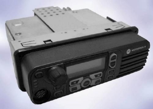

    Whether it's a bad idea or not kind of depends on how you use the radio. Motorola makes DIN mounts for many of their mobile radios because it's a standard that is easy to build radio cabinet around and not all up fitting uses face separation kits. So the key to mounting is knowing you need air flow, especially if you're one who likes to hold that PTT down a lot... It's definitely important to consider it.

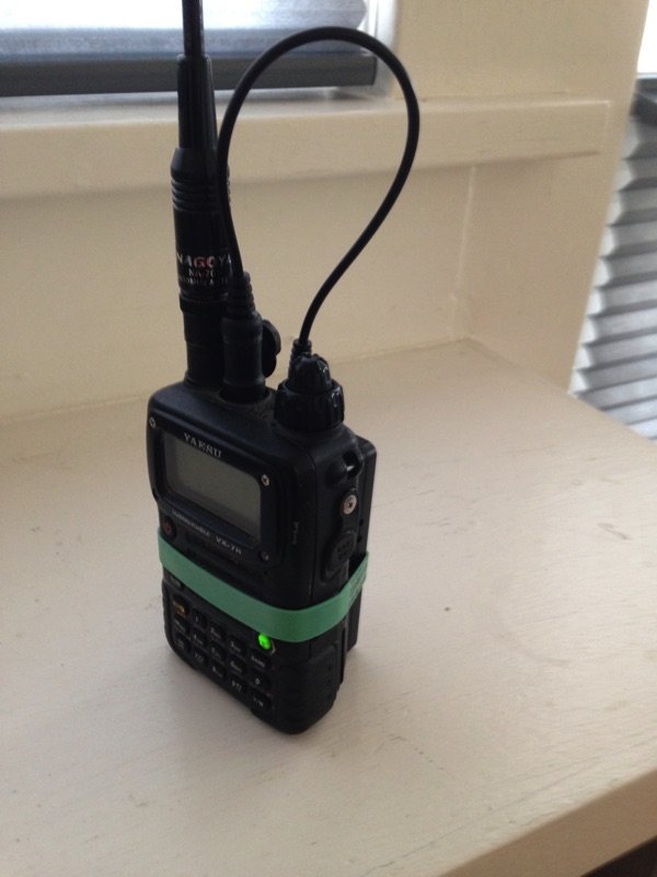

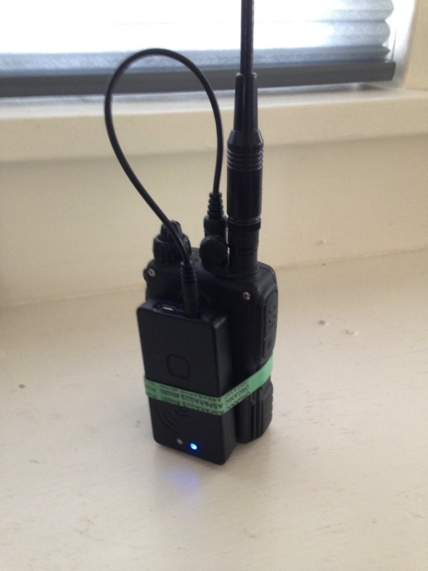

    If I'm not mistaken the FT-70 has the typical Yaesu 4 conductor (TRRS) speaker/earphone/mic plug (similar to a FT-60R, VX-6R, etc). If so it should straightforward to interface a TNC to it.

    You'd use the radio like a plain analog radio (not C4FM/Fusion). This is what a Mobilinkd TNC3 looks like connected to a VX-7R through the speaker/mic plug. I don't think the FT-70 has any built-in TNC or APRS, right?

    Yeah, most police/fire/EMS radios are crammed into cabinets with less air flow than the dash. I would be worried if using it for heavy transmitting like packet or APRS (not setup properly), but for normal trail talk, or net traffic during the morning commute, it should be fine.
