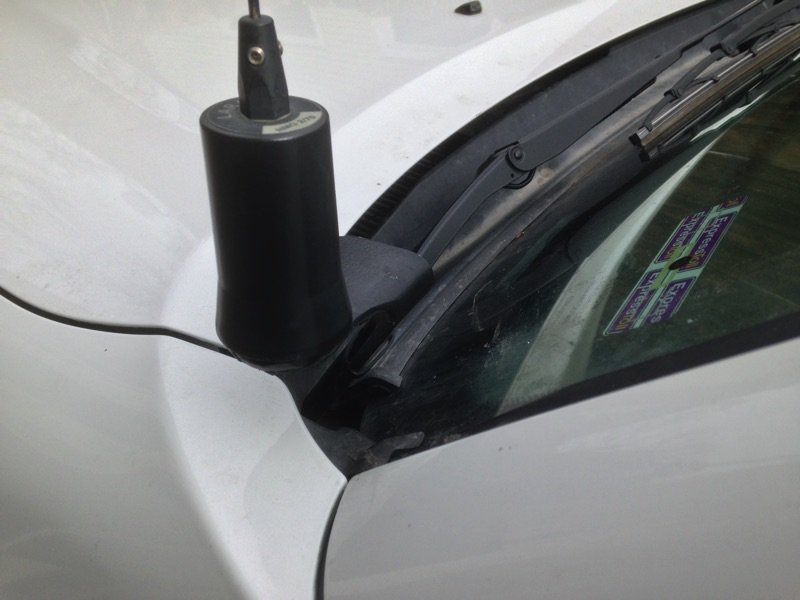

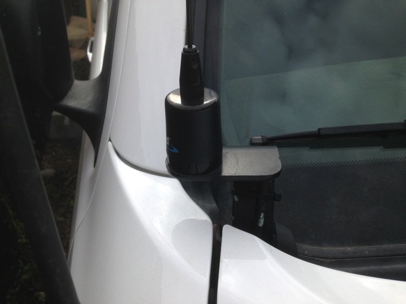

    Yeah, forgot about those! I put them out of mind. That's what I used to get antennas on my truck at first until I could determine how much work it was going to be to get them on the roof. That ended up being a couple years of procrastination and finding better things to do than break a ton of plastic clips (which I did plenty of)...
    I didn't care for ditch light bracket antenna mounts. They're always in view, hitting every tree branch, pack in with snow and it's impossible to get a counterpoise (ground plane) so only 1/2λ antennas tune worth a darn.

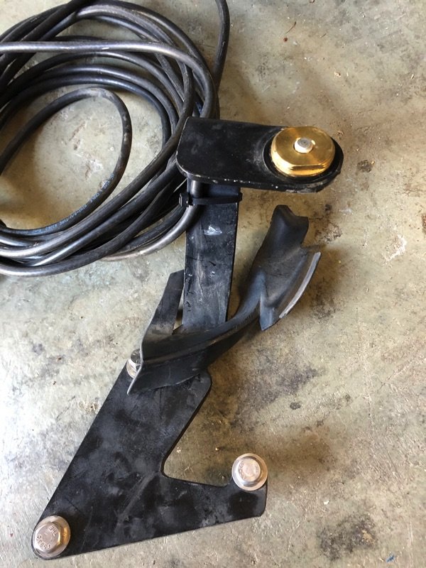

    Now that I've done such a good job talking them up, I do happen to still have them and am thinking of selling them. They are CBI brackets. Don't remember if I drilled them out to 3/4" or used 3/8" NMO mounts. The cable is RG-8X so I may have drilled them out and used NMO mounts I had since it would seem I re-cabled them. OTOH they must be thick surface NMO so maybe not. Dunno. What I do know is cut slots in the corner window trim to go around the brackets to make it looks less half-assed.
    Laird antenna bases fit like they're supposed to be on them. Larsen work OK with o-rings but not their regular rubber washers.

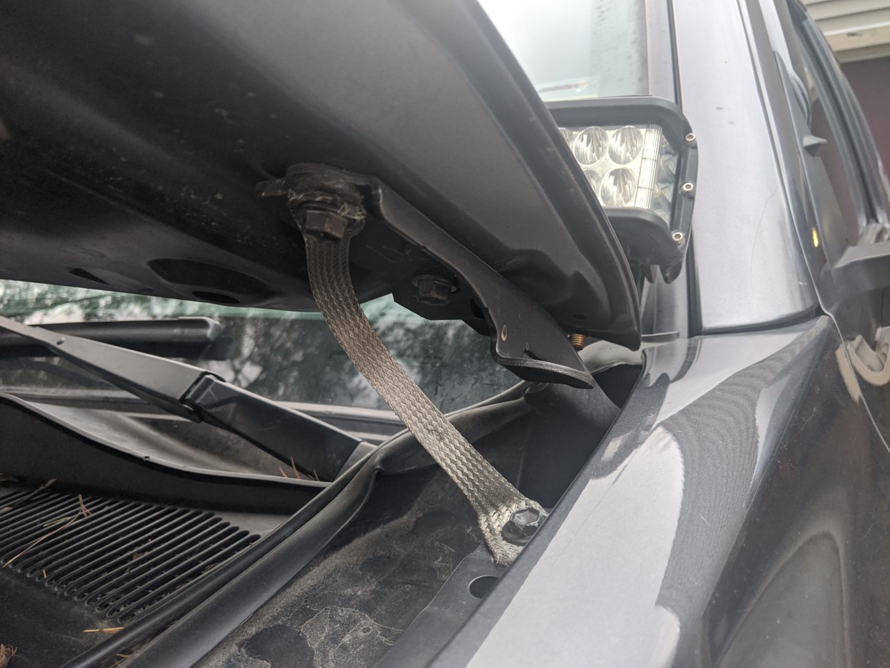

    You can do it with about 10" of strap right through the hood latch bolts ez pz

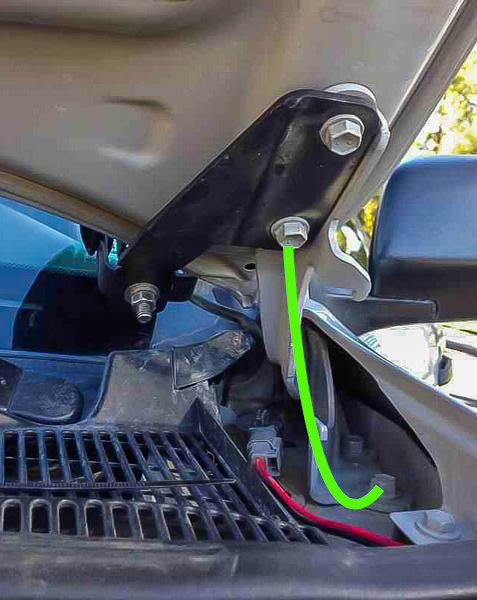

    He's just talking about a loop with an eye under one of the ditch bracket mounting bolts to one on the hood hinge.
    This is a Relentless ditch light bracket so it's already mounted on the hood but the bonding strap would be like this.

    The difference being is mine is for bonding, like you said though. I'm relying on the strap going right into the screw threads, not the bracket surface itself.

    One post up. I use it for general panel bonding. But that screw is uncoated where it touches the scrap and goes straight into female threads. More than enough surface area.

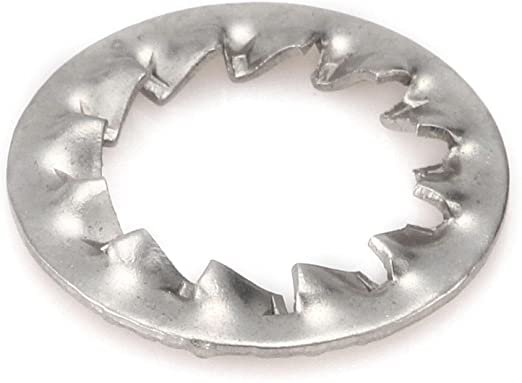

    Serrated washer. The paint has a cathodic mix in it. It'll essentially heal itself around the edges that dig in.
