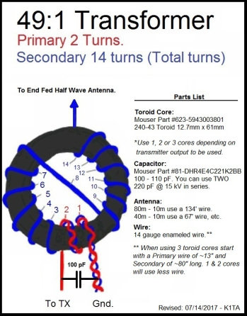

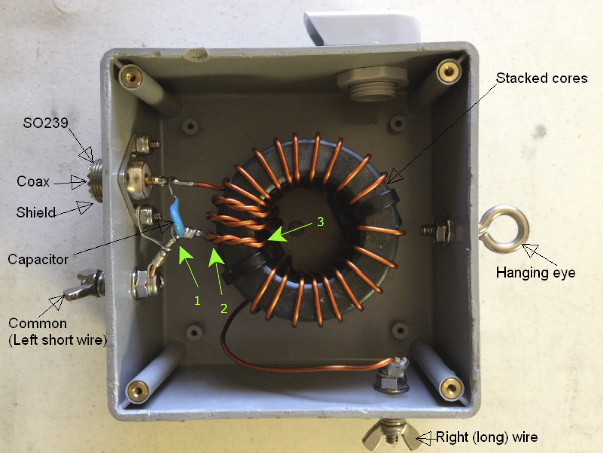

    Has anyone built a transformer for an efhw? On the primary winding, if the wire breaks at the point where it's doubled over, does it really matter? I feel it doesn't because it's getting soldered anyways but I figured I'd ask in case there's something I'm overlooking. Lower right side.

    What do you mean doubled over? Where is the break? Sounds like at or near where I indicated #1. There won't be a problem for sure. If it's where I've indicated #2 or #3 it might not matter as long as you can still twist the primary and secondary together and keep them insulated. T
    Took the image from a presentation by Mark Mladejovsky, WA7ARK.
    http://hamfest.w7yrc.org/wp-content/uploads/2019/06/EFHWslides.pdf

    Yup. I keep coming across literature that instead of taking two separate wires and twisting them together, they fold it over and twist. I should have reworded my question as is there any benefit to it.
