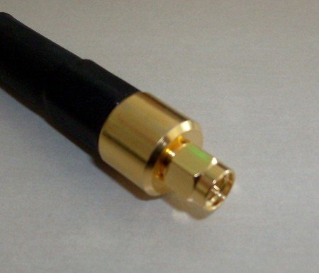

    Amphenol actually makes an SMA connector for LMR400/RG8, part number 132333. The Anytone probably uses the reverse SMA so I assume you're thinking adapter but seeing the big ol' fat LMR400 going into an SMA is almost comical. In real use I wouldn't recommend anyone do this for an HT, it's likely to break the connector. A 6" LMR100/RG174 pigtail with an SMA to whatever is more kinder to the radio.

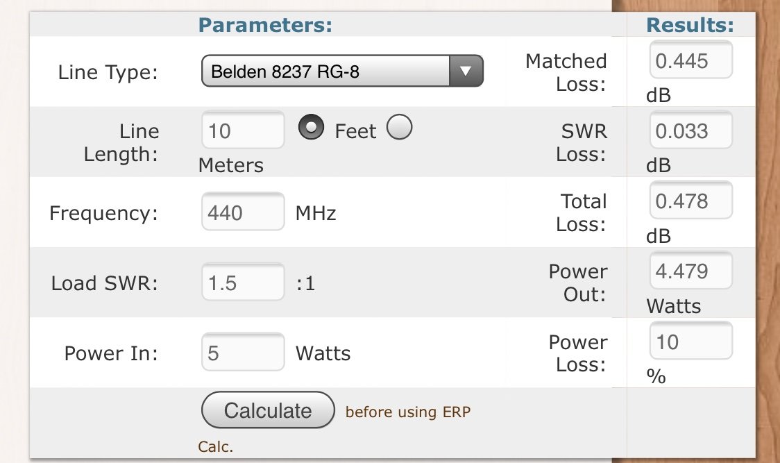

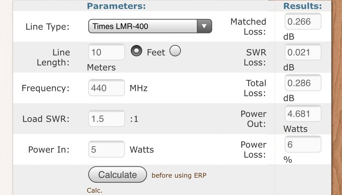

    I'm hip to your tune but I'll mention that for a dual band radio that covers UHF it's not completely nuts. At 440MHz RG-8/Belden 9913 will lose about 1/4 dB even at 10 feet, so 5 watts in gets 4.7 watts out. Compared to 10 feet of RG-174, which loses in 10 feet 2 dB. Meaning 5 watts in gets 3.1 watts out. That's just 10 feet, not a typo. At VHF it's not quite as bad. Again 5 watts in, 10 feet at 146 MHz RG-8 is 0.15 dB loss or 4.8 watts (essentially lossless) out and RG-174 loss is about 1 dB or 4 watts out.
    It's always a trade-off between cost, ease of use and loss. I ran RG-8 for my house 2m/70cm, which ended up about 60 feet, because it's just not practical or cost effective to run heliax or even semi-rigid coax. But this gives about 1.6 dB of loss, which means 50 watts at the radio only delivers about 34 at the antenna on 70cm.
