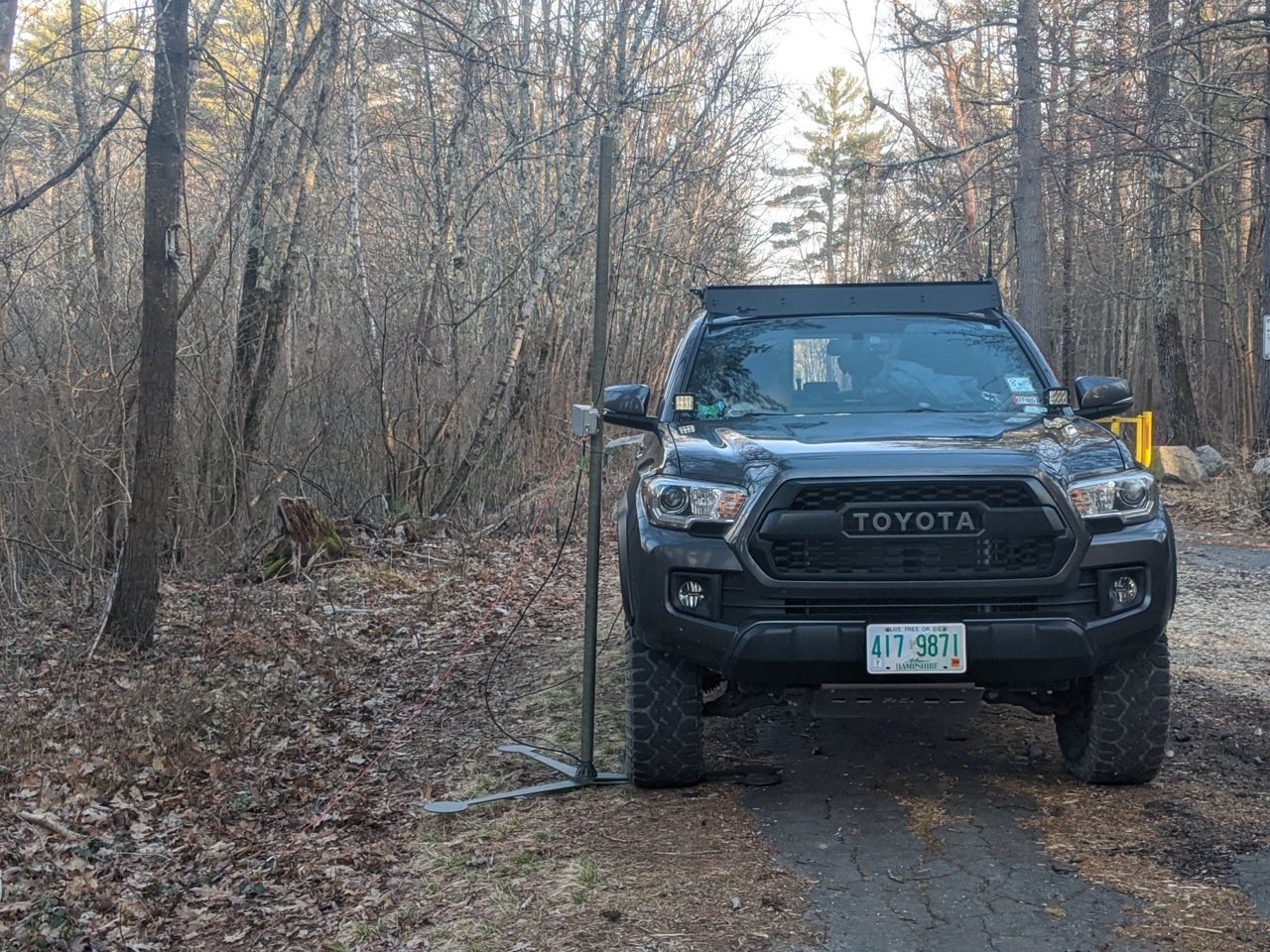

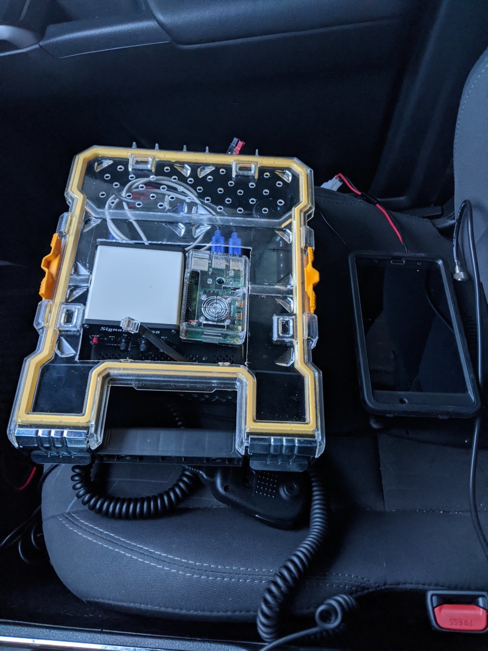

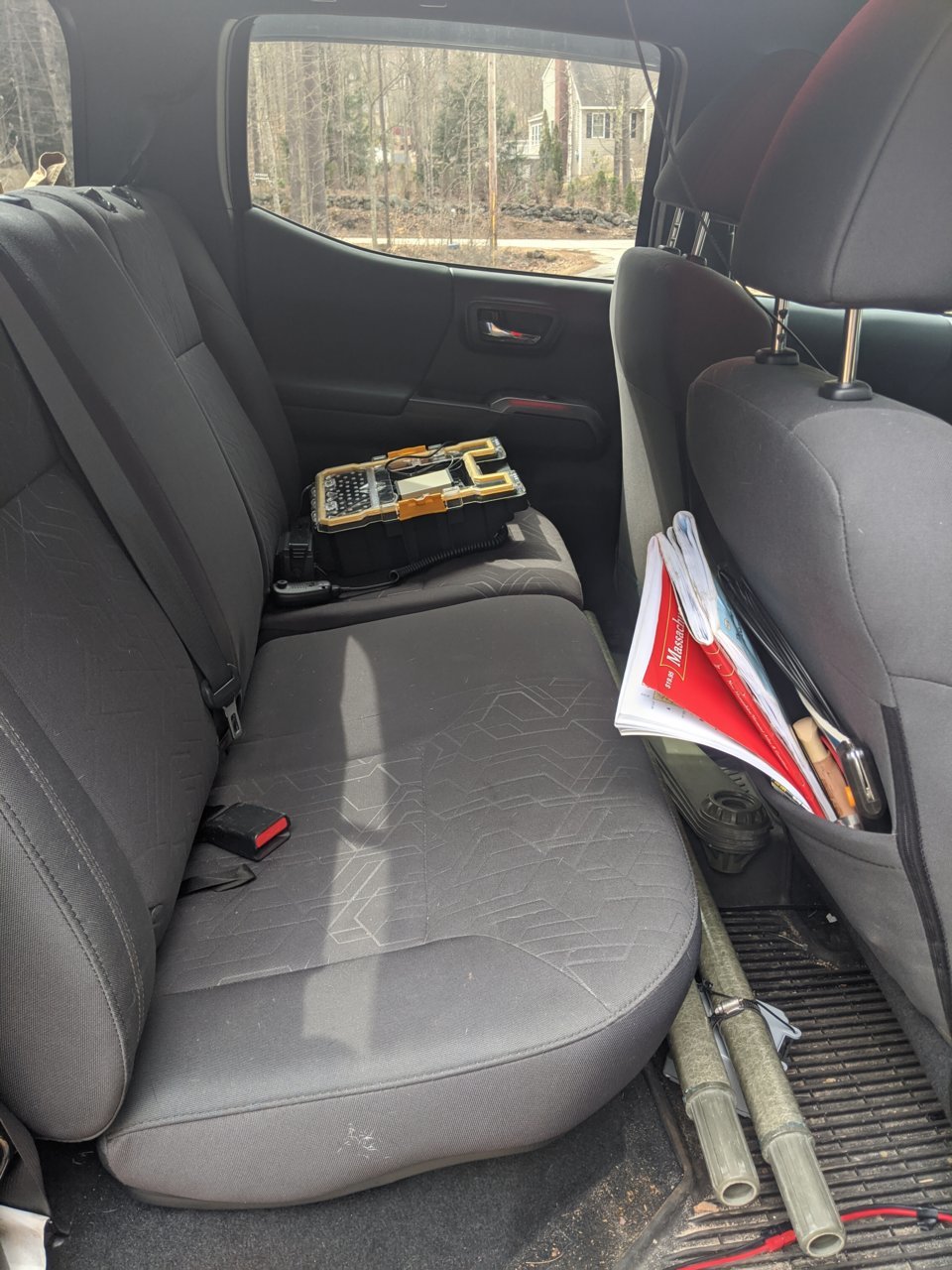

    My mobile is my truck. The nice thing about the box is you can just disconnect the cables to leave in the truck, and then I just put the box on a table with the short cables and it's done in two minutes.
    It'll be this set up this time. A mix between my mobile roof antenna (atas-120) and my endfed while portable.

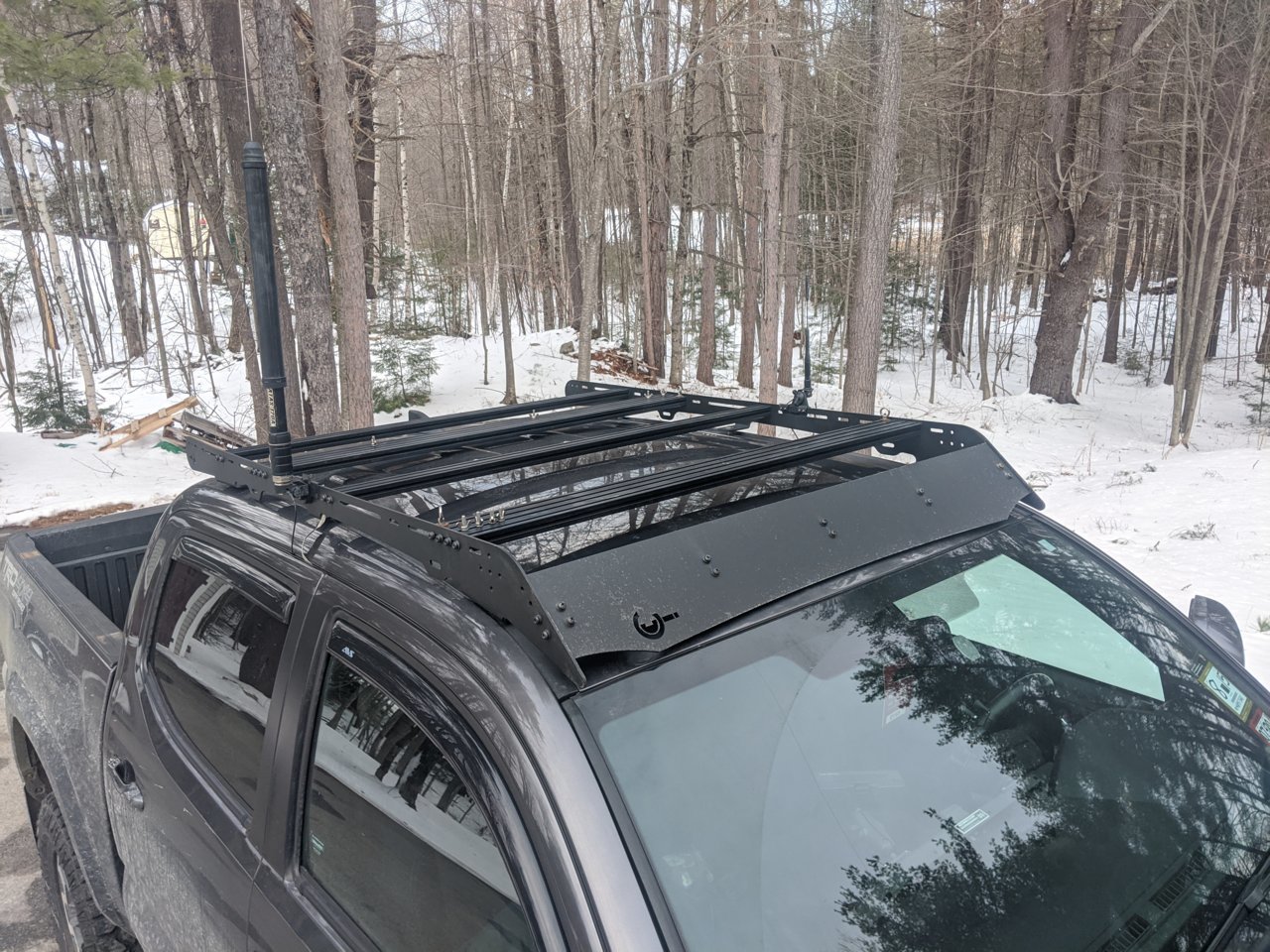

    Last Pic shows the atas

    Thanks! Gets the job done. Works really well when I stack them 36' high on the ice during the winter. Lots of ropes for that one.
    I might still look for a different solution that involves either a bracket on my roof rack or one in the bed.
    I need to play around and see if there's and adverse effects with the length of the grounding wire being too long, within the range of the trucks height.
    Then again some folks put these transformers in trees so we will see

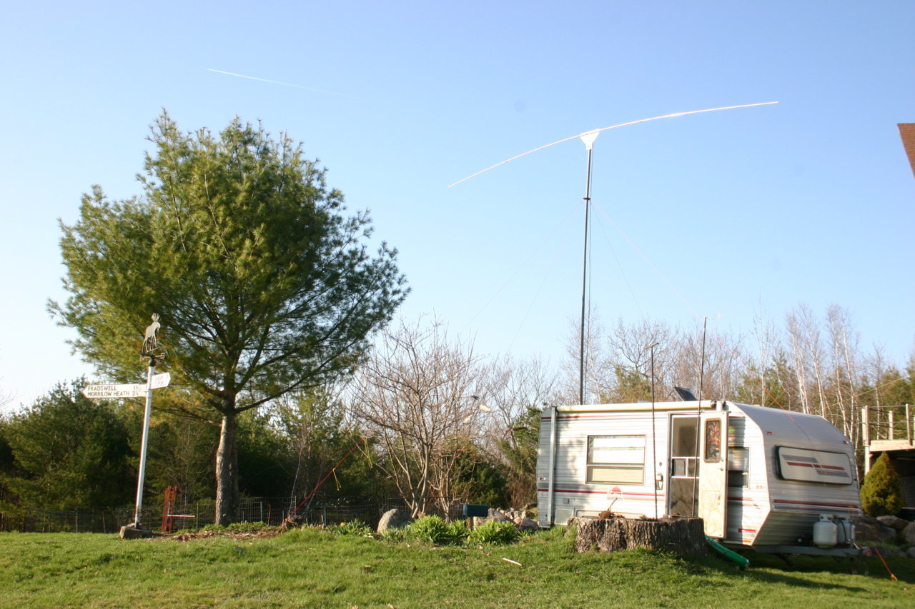

    15 meter beam on fiberglass poles. The aluminum element tubes fit inside one another gives me 10-15 meters, 20 won't cut it unless I build a truss to support the elements it just too long. It is somewhat directional so I can turn it from the ground level. At the back of the camper is a hinged mount on the rear bumper that allows me to assemble the whole thing walk it up and put the pin in to hold it up right it is guyed also because it's 20' up. I built this for ARRL field day to be used as the GOTA station (get on the air)

    Well. Tonight was an adventure. Had a lot already. But finally tally.
    Grounding.
    • Front corners of cab to front panels
    • Rear corner of cab to bed sides
    • Bed sides to Frame
    • Rear cab to Frame
    • Front cab to frame
    • Headers, front and rear of cat, in front and rear of muffler to frame
    • Front panels to hood
    That achieved me a drop from S9 to S5. Progress, but still have a ways to go. Next im going to try and bond each individual cross bar to the side plates of the roof rack to see if that helps as well.
