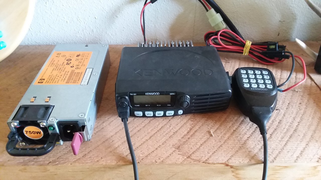

    Anyone use a server power supply as a base station radio supply? I picked up two for $20.

    I'd be fine with using one of those while I'm right at the station.
    But when I'm doing digital work I'll walk away and just let the scope observe the qso. When it comes to some electronics I do favor having a UL stamp.

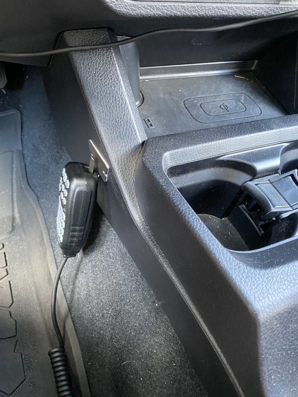

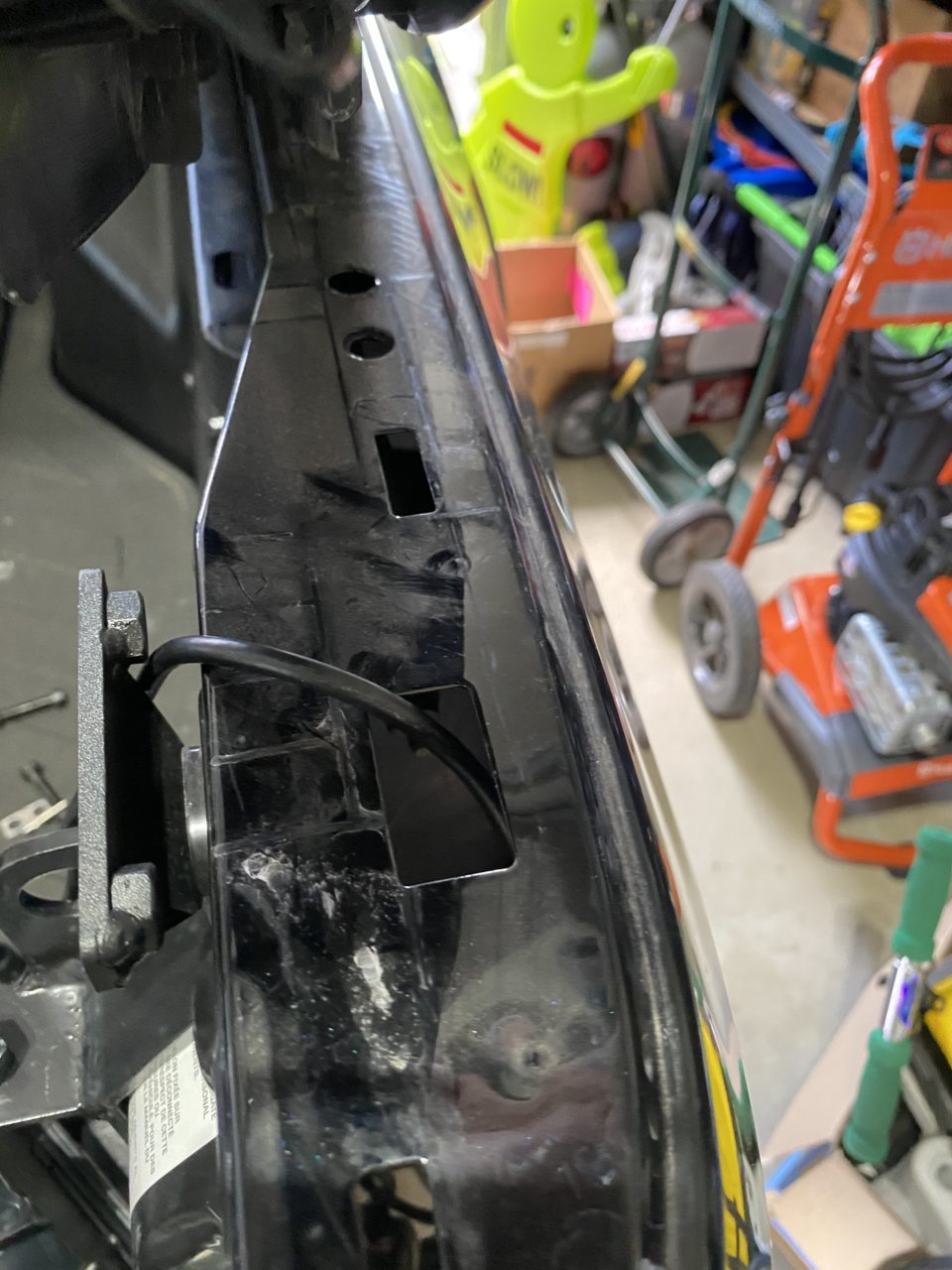

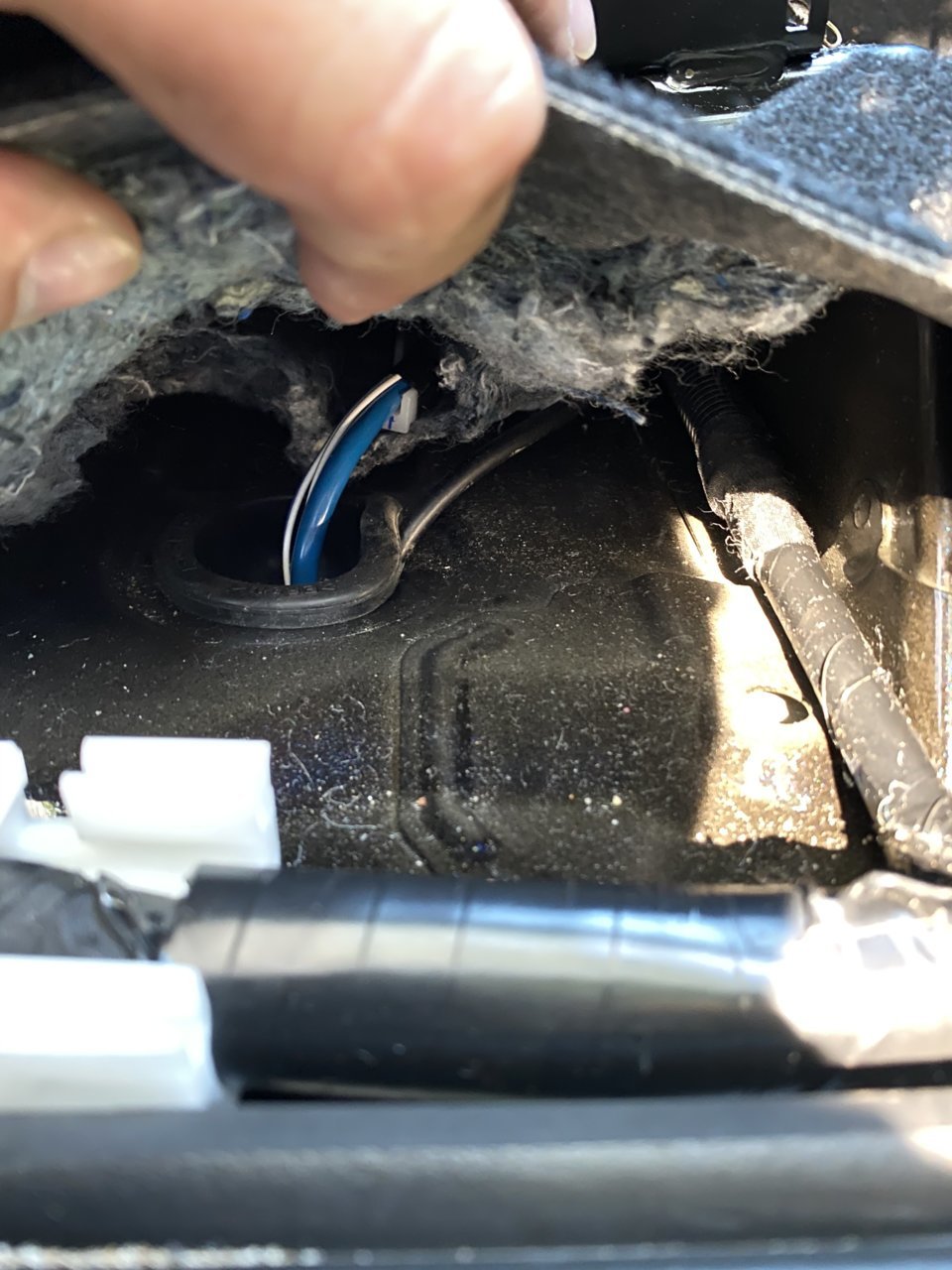

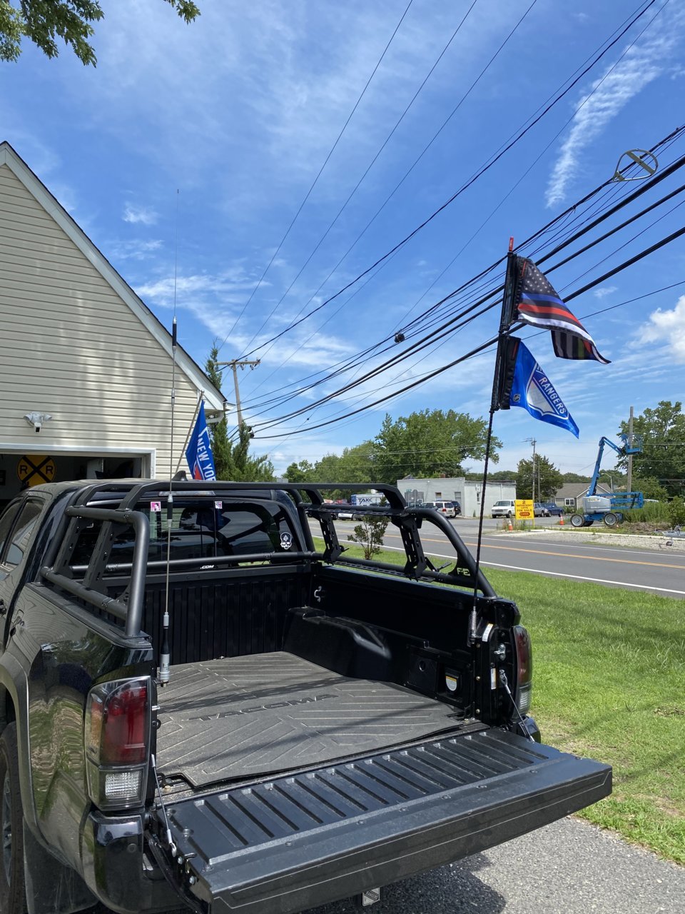

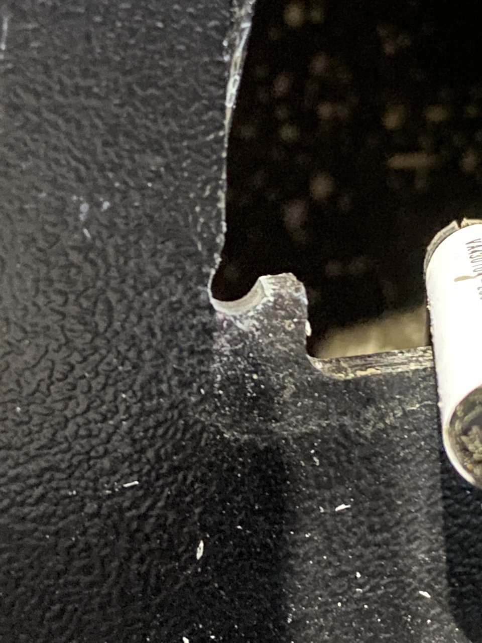

    Minor stuff.
    Installed my phone holder, ham radio and CB yesterday and finished up today.
    For the CB, I have a fire stick antenna and ran the fire flex coax under the bed rail cap, behind the tail light, over the wheel well to the passenger grommet. JUST had enough cable to reach the radio on the dash. Mic wire is ran behind the radio and is attached to the antenna wire with a Velcro strap. Keeps it from hanging in front of the stereo. It’s held to the accessory mount with a magnetic mic holder.
    For the ham radio, I have a Diamond SG7900 and ran C213SMA cable. Was a little worried Because that cable is only 13.5’ long. But wired it through a small grove I made behind the bed light, over the wheel well to the driver’s side grommet. Had just enough to reach the head unit which is under the driver’s seat. Mic is set up next to the e-brake. So far everything sounds good. Might want to put an external speaker on the CB cause the internal one isn’t so loud. Might do the same with the ham radio since the head unit is under the seat.

    I figure with its use in servers containing lots of valuable data, and the CE listing, it's probably okay. Neither my MacBook or Kenwood radio have UL listings either.
    I'm going to design a switch and plug enclosure for it so it looks acceptable on the shelf.
