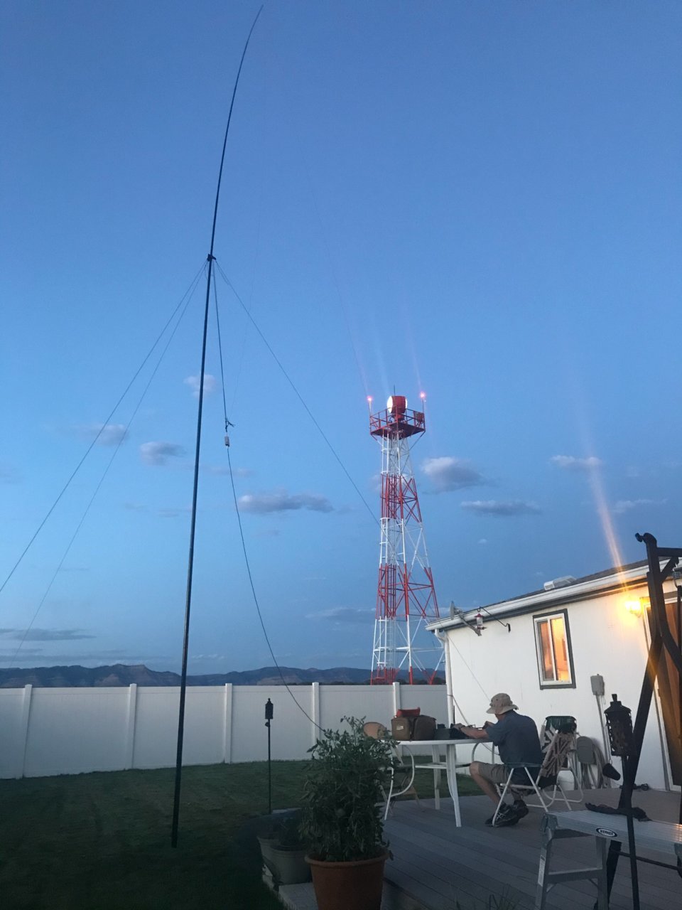

    Better get a Spiderbeam mast while you are at it. I love this thing. 38796.jpg

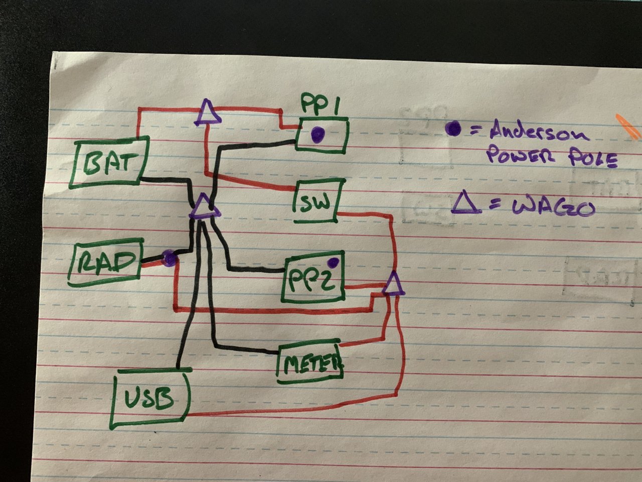

    Your diagram looks good. I did anderson poles between the radio and everything else so I could use other power sources if I wanted. Right now it's sitting on my desk with the radio connected to the desktop power supply. Also, if I needed to use a 12v plug and power in the car or RV I had the option.
    I use a Battery Tender brand charger for the battery. I love them for my motorcycles, so figured they would be good for this. They have smart charging, so they can be plugged in and left for years without damaging the battery. One of my two power poles are directly connected to the battery for charging and one is switched. This was just a personal choice, you could run another set off the battery for charging. The Battery Tender comes with SAE connectors, which are nice too (Although I changed them to anderson poles).
    Going to be ham-sexy when you are done.
    If I get a chance I will draw up my diagram to show all I am talking about, not sure if it will confuse more or help.

    I hope this helps too.

    What is that red and white tower next door?

    Rotating beacon for an airport. I fly and mechanic for work and a few nights a week I spend away from home running UPS next day air. Our company uses a house on the airport property so I am set up in the back yard right now.

    This is helpful, thanks.
    I'm going a similar route. A constant APP for charging the battery and then a switched APP, but I'm not sure how that would work, if say I wanted to run the radio off a dedicated 12v power supply in my "shack". I think my current method would still work, but I'd like some confirmation there.

    I think the way you have it planned to wire is going to work. Thats also the great thing about the WAGOs, very easy to change something around without rewiring the whole thing. I think you are to the point you need every in hand and just do it. If it doesn't work right, the way you want it to, change it.
