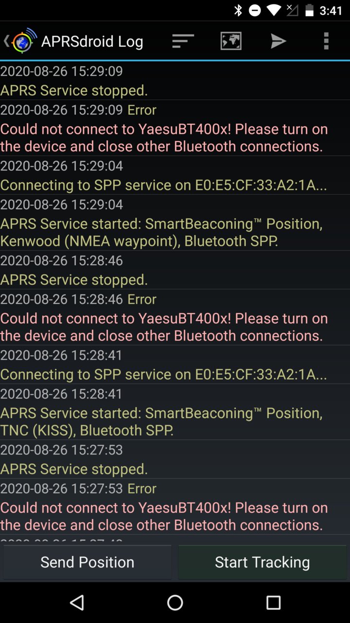

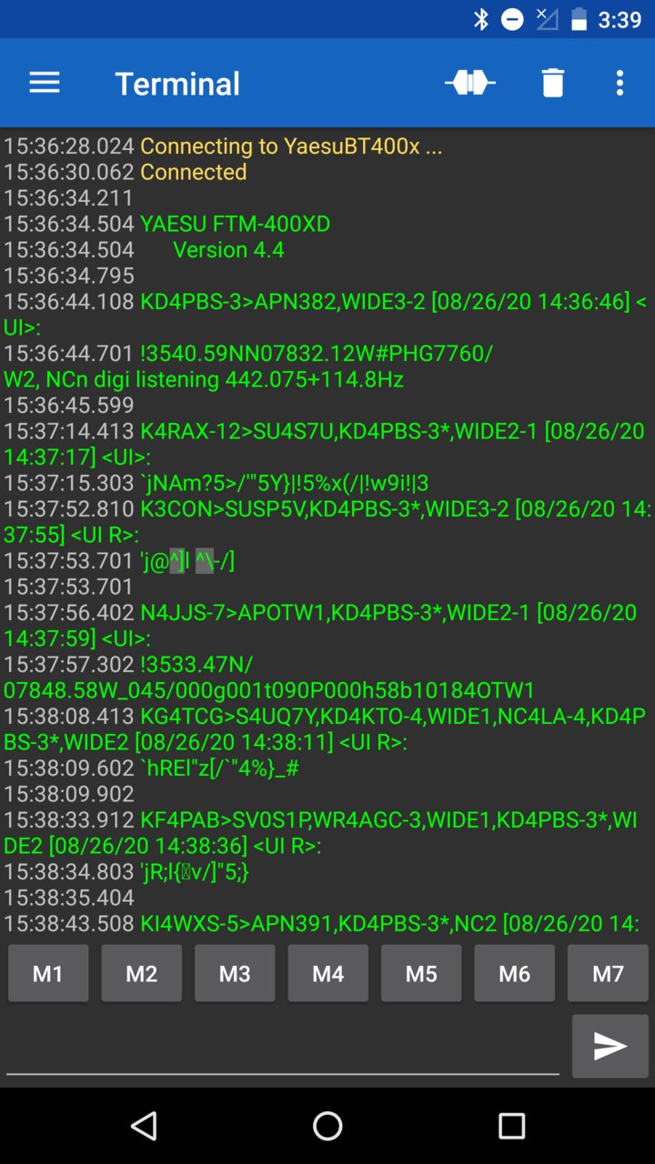

    Progress, well sort of.. To start with a boring YouTube video that I found for setting up a Bluetooth SPP device to work with aprsdroid and backcountry navigator. I'm thinking either aprsdroid does not support BLE devices or I have my setting wrong. A random 'serial Bluetooth terminal' app reads the serial output just fine.
    https://youtu.be/TerxrVD2FEg
    https://github.com/ge0rg/aprsdroid/issues/124

    I thought I had an idea but it's likely irrelevant. If I configure my TNC with the mobilinkd app then forget to disconnect from that app, I will get the same error you got. The github issue might be a better lead though.

    If my 5 minutes of phone research is anything to go by, I'd say your radio isn't in KISS mode or it isn't sending the right tnc init string.

    The video calls for Kenwood nmea9. There's no KISS mode in the radio, I was just trying the other protocols at random to see if anything would connect. Then I disconnected the radio fully and still can't connect to BLE from aprsdroid . Since the terminal app with BLE support can connect and read data, I assume that aprsdroid just doest support BLE or maybe more accurately the module doesn't support the Bluetooth SPP profile the app is looking for. I've got another module coming that does support Bluetooth SPP.

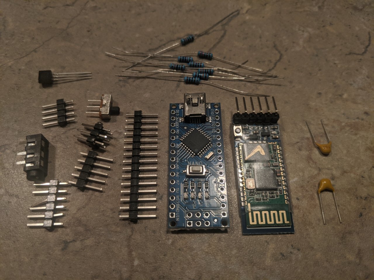

    This BLE?

  12. Aug 26, 2020 at 6:06 PM
    #7872
    Sandman614
    Oct 26, 2010
    #45273
    36,043
    Tim
    Garner, NC/Boone, NC
    '06 SR5 Off Road
    A kit haha damn, Arduino Nano and an HC-05? I went with the hc-06 for my 2nd module. Both should be good with Bluetooth SPP.

    I needed a couple of good projects to keep me busy. Haha.
