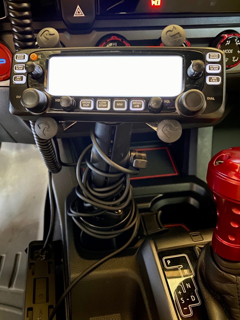

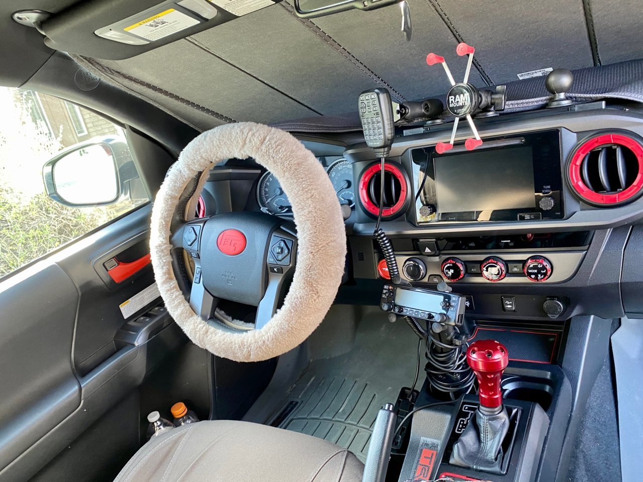

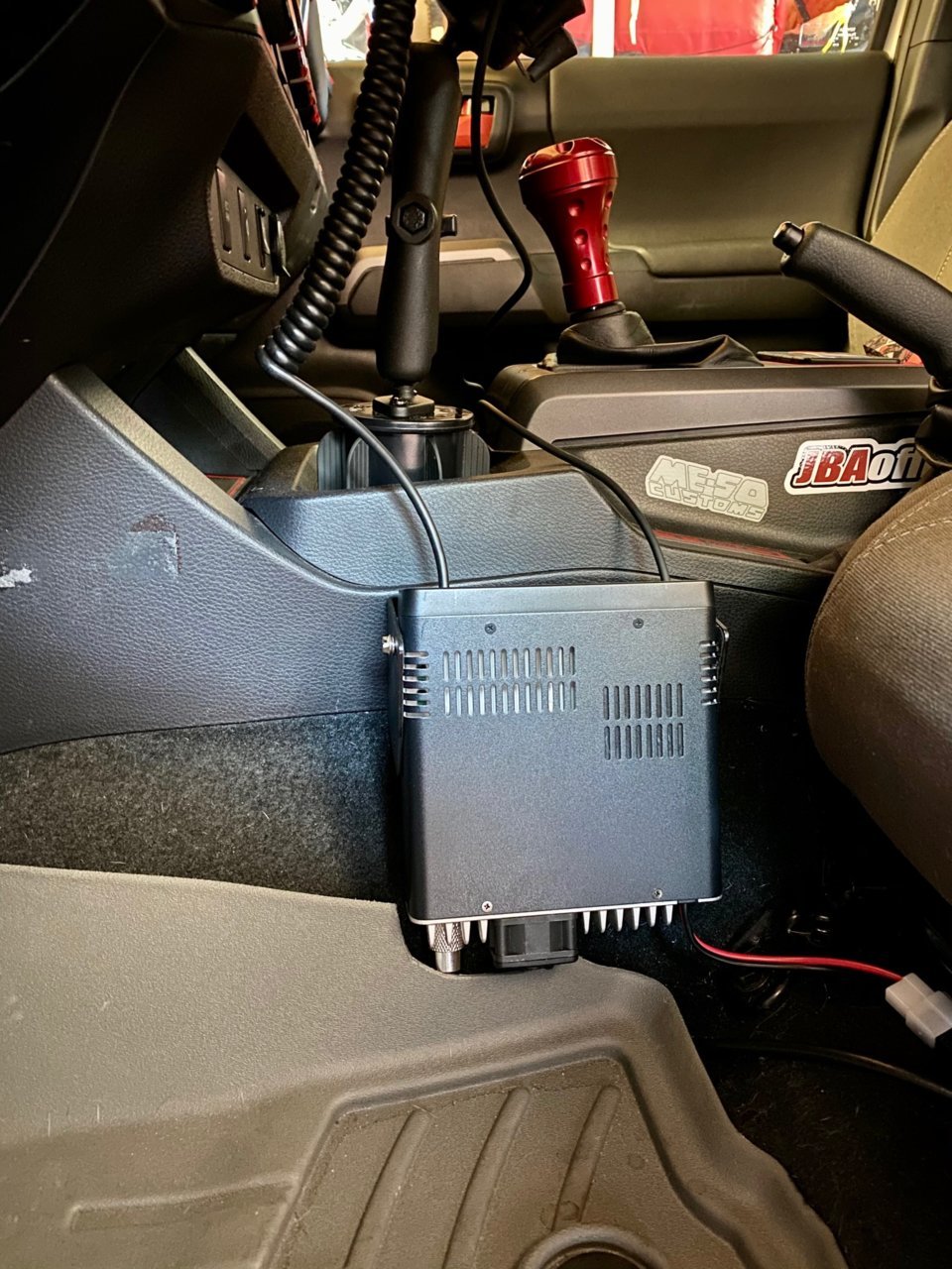

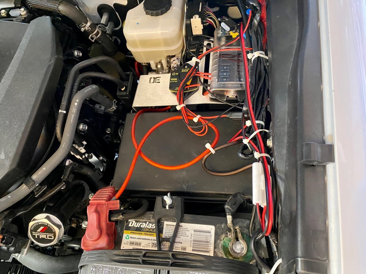

  5. Nov 22, 2020 at 6:24 AM
    #8145
    tacocart762
    tacocart762 Well-Known Member
    Mar 15, 2020
    #322179
    368
    desert55gr
    Santa Clarita Valley
    2017 Tacoma TRD Offroad Dbl Cab Long Box
    1.5in Bilstein 6112 Front,1in Alcan Leaf Rear with Bill 5100's. Battle Armor side step,bull bar, and rear step.
    @Watcher469
    New setup in the truck. I did install the Blue Sea Fuse Block and 100A breaker along with 15A fuses for each device tied into the fuse box. There are two sets Baja Designs and the ICOM Radio for now. I know it looks like a nightmare but it all works
    HAM setup is ICOM 2730A, Icom radio mount, Comet SBB5NMO antenna, Diamond K400 Lip Mount, Diamond coax extension cable, Icom handsfree external speaker, and all kinds of RAM mounts.
    The lip mount did require a bit of modification to the hood. There is a rubber strip to stop water ingress and in order to make a metal to metal contact I did strip that rubber away and now the K400 mounting plate runs the length of the cut out on bare steel. I have some dielectric grease on the way to hopefully prevent the bare metal from rusting. The grounding connect is very strong.
    I found that I can run the coax along where the windshield wiper tube runs. I also found a spot and cut out in the Rago ditch light mounts to secure the coax with a ziptie.
    I did wrap all exposed coax in white electrical tape to help shield it from the hot SoCal sun.
    This setup works well! I powered it up yesterday and the breaker did not trip and fuses did not blow so I must have connected everything correctly. As always the hardest part is running through the firewall and son of a bitch I ran the wrong ends through the firewall the first time and had to do it again. The only thing I wish I had done was spend a bit more for the Yaesu FTM-300DR so I could have access to digital as the 2730A is analog only. Do not get me wrong the 2030 is a nice radio!! So overall I am very happy with this setup!!

  6. Nov 22, 2020 at 8:22 AM
    #8146
    GarlicFarts
    GarlicFarts Bertolli Roberto
    Dec 12, 2019
    #313138
    12,922
    Lil Rhody
    2020 White DCSB TRD OR
    SOS bolt-on sliders In-cab sleeping platform J-Dub IFS Skid
    Your cab is bitchin. That steering wheel cover though....and you still have a warning sticker on your door :D
    Other than the claymore in the steering wheel airbag I want to know where you got everything.
    tacocart762 likes this.

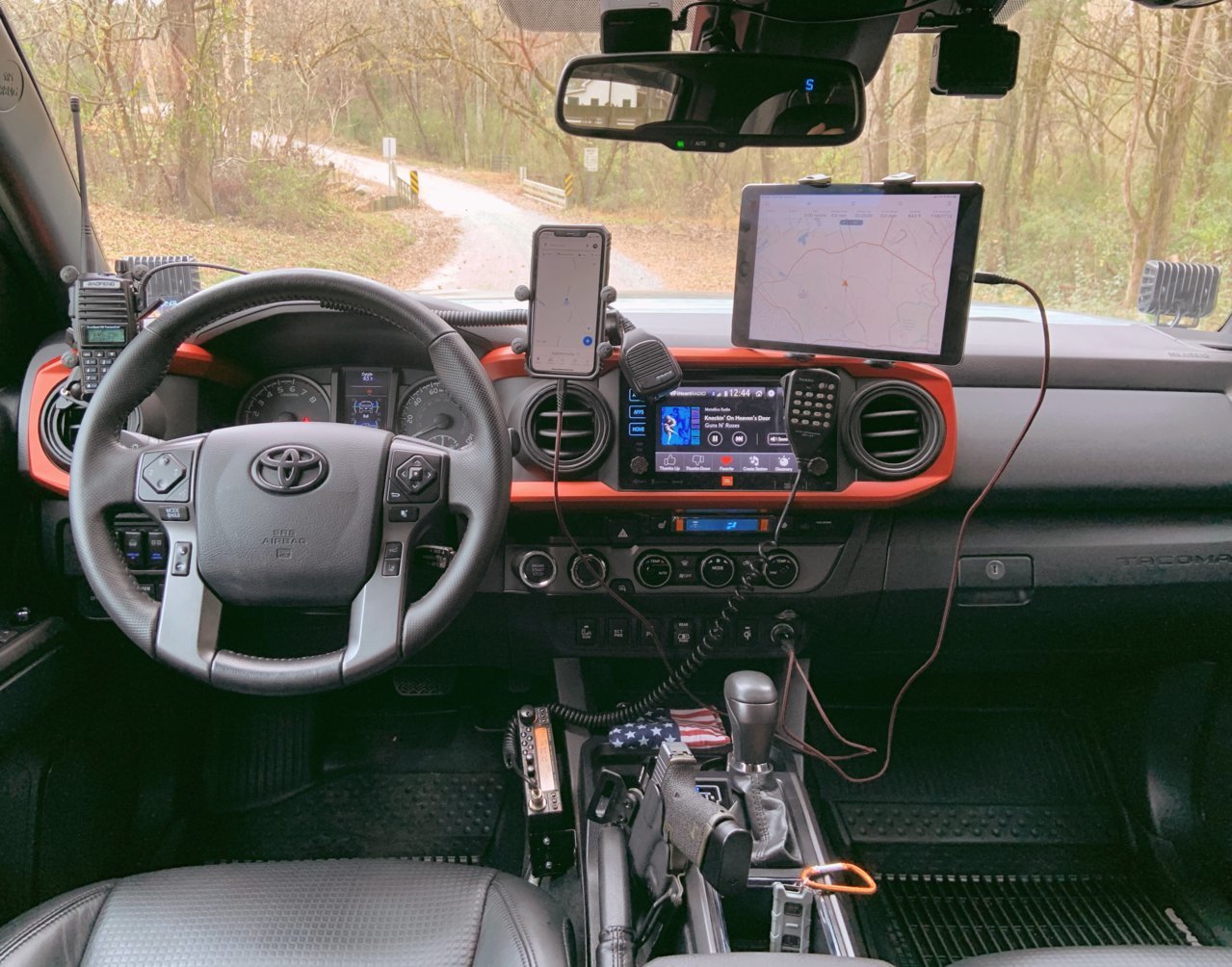

  9. Nov 22, 2020 at 5:47 PM
    #8149
    Kheiron
    Kheiron @Koditten Pirate Radio member #003
    Sep 13, 2017
    #229883
    745
    Kevin
    Powell, WY
    2017 OR DCSB QS
    Kenwood d710g, high speed pheasant mod
    Every time I listen to the traffic on any repeater when I am traveling cross country.6578BE1F-A901-43C7-8FDA-57CF10F9108B.jpg
  10. Nov 23, 2020 at 4:25 AM
    #8150
    tacocart762
    Mar 15, 2020
    #322179
    368
    desert55gr
    Beautiful! Only diff is I did the Mars/Cap Mod on my Icom to get the GMRS and FRS freq and my Glock is in my backpack. Otherwise its an exact image lol.
    Ncpi007[QUOTED] likes this.
