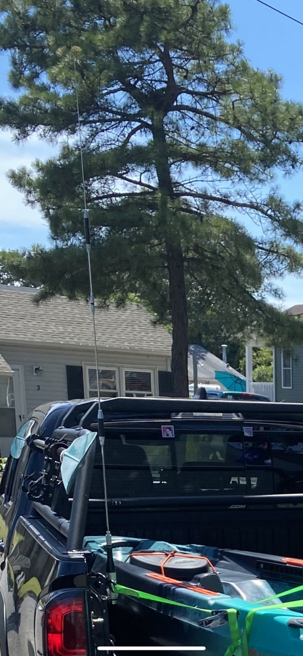

    Minor stuff.
    I attached my dual band Diamond SG7900 to my Total Chaos bed stiffeners. This is the best picture I have as of right now (it’s a screenshot). I can post another picture tomorrow as I am not with my truck right now.

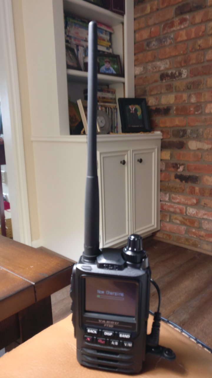

    This appeared in the mail Thursday afternoon, seems to be a great little HT for the money. I planned to use it just on my motorcycle for APRS but after playing with it for a little while I may use it for more.
    Still waiting on the new antenna, it's supposed to be here today.
