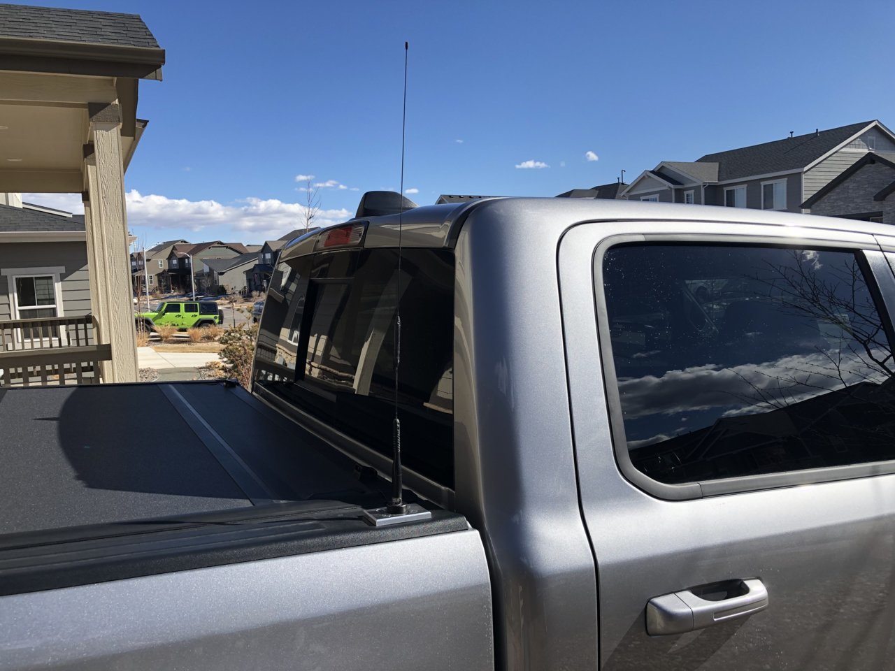

    Can you post some photos of how your antenna is installed? What frequency is your SWR the lowest? Is this a new or used antenna?

    The antenna is used, but I am the only owner. I removed it from a truck I sold and installed it on my new truck. I never did measure the SWR when it was installed on the old truck so I have no data to compare to. See below for a picture of the install. Right now it has the lowest measured SWR at 450MHz.

    Is it bonded to the bed? Hard to tell from the photo. I see the plastic cap on the edge of the bed.

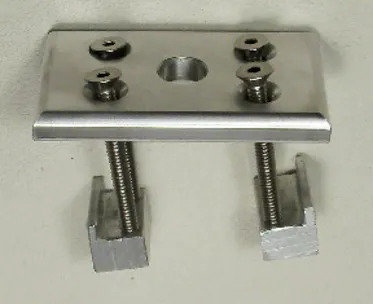

    There is no extra bonding strap/wire, but the mount makes metal on metal contact with the bed underneath the plastic cap.
    Here’s a photo of the mount so you can see what I mean.

    it might be isolated after the bed. Can you get a continuity check? The composite bed plays games for conductivity and grounding. You might be against metal but that’s against plastic again.

    That is a suboptimal place to put an antenna. Looks like it's linear loaded so might be ground independent. What are you measuring SWR with?

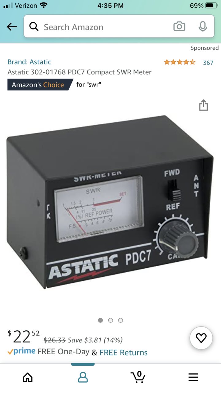

    Yeah it’s definitely not an optimal location, but I’m not going to be drilling the roof and I really don’t like fender mounts. I’m measuring SWR with the below meter. Based on the readings I am getting, and the improvement I saw as I lengthened the antenna, I believe I could get plenty acceptable SWR across both bands if the antenna just had more adjustment allowing further lengthening.

    That looks like a CB SWR meter. I wouldn't trust what it does on VHF/UHF. Check the SWR with your radio. It would also be beneficial to check SWR mounted to something else. Cab metal that close is likely to alter tuning.

    The meter doesn’t specify what band it is intended for, only that it is designed for 50 ohm impedance. Based on this I’d assume it would be accurate in this use case. Especially since it has a calibration knob that you set based on forward power measurement before each reading of reflected power.

    I would just try transmitting with it. If your rig doesn't fold back power and you can hear stuff, use it like it is.
    Although if you already altered lengths of the radiators, it may now be out of whack....
    In 25 years of ham radio, I've never adjusted tuning of a store bought VHF/UHF antenna.
