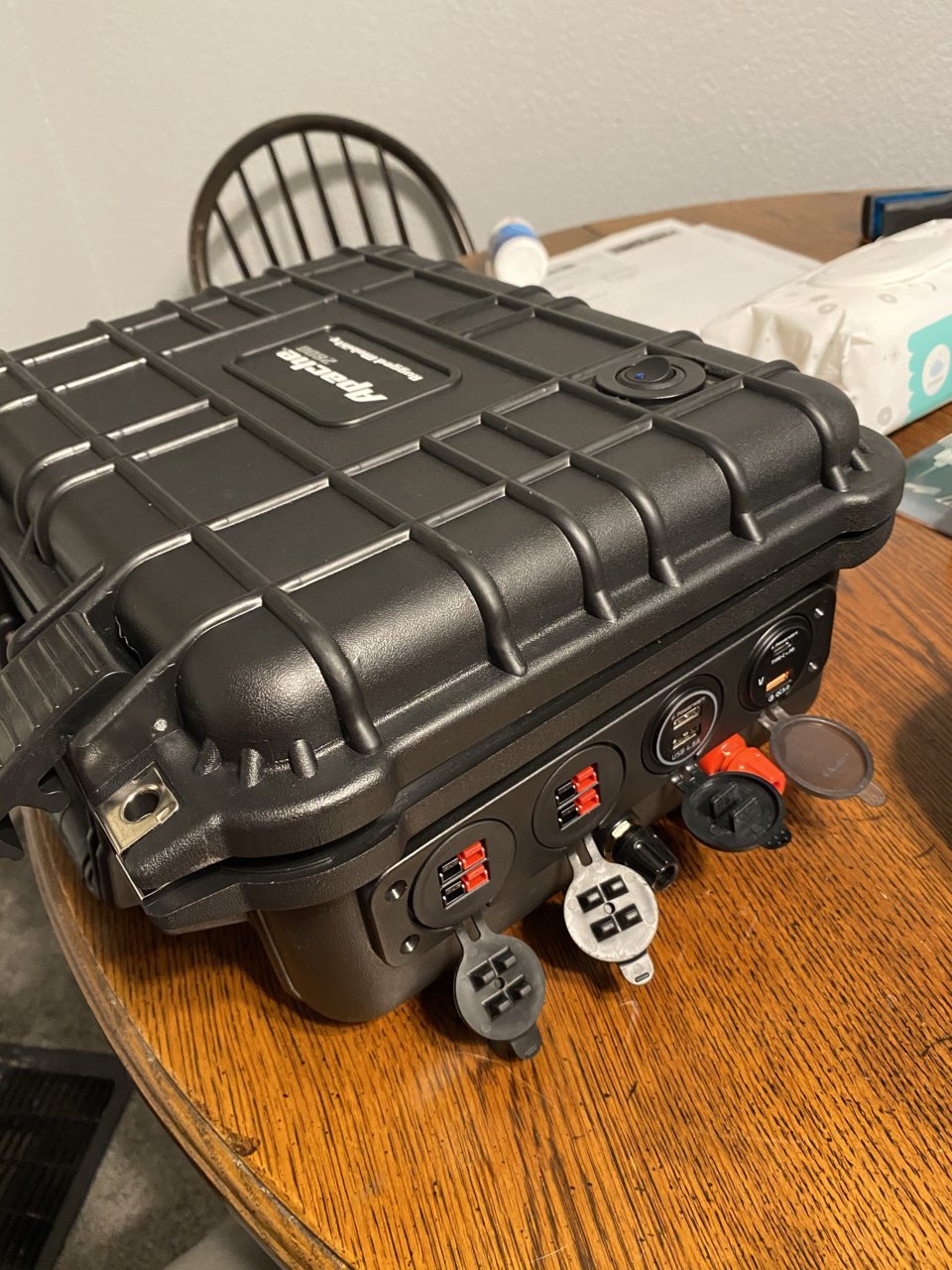

    I echo what @golfindia said. There is no reason to run with a power supply. If you want something plug and play, look into the powerwerx stuff. The make battery boxes and they use bioenno batteries.
    iK0NiK[QUOTED] and golfindia like this.

    I just got done building this after realizing how easy the Powerwerx box was to make.
