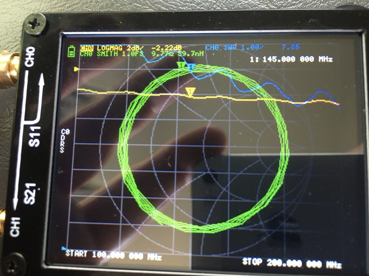

    Maybe the 1-cent fix.
    after checking coax length for shorts, bonding trunk hinge to body and body to frame and sanding off connection points, the meter didn’t move:

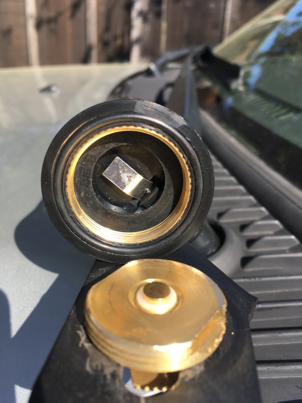

    Then I thought even though the tab in the antenna base has a mark on it that makes it look like it’s making contact with the mount, maybe the bracket is too thick and there is no contact.

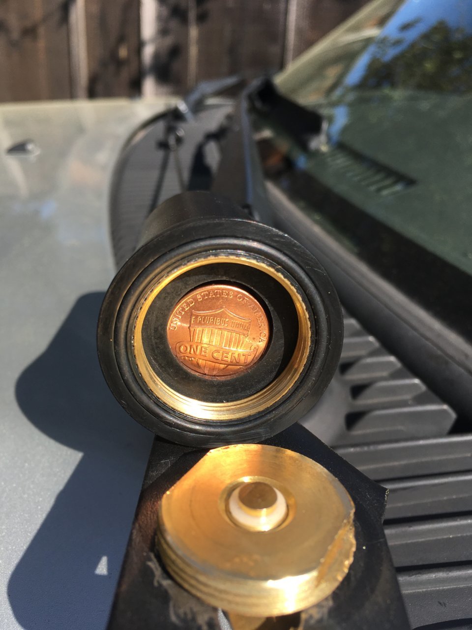

    I located a suitable conductor and slid it behind the seal.

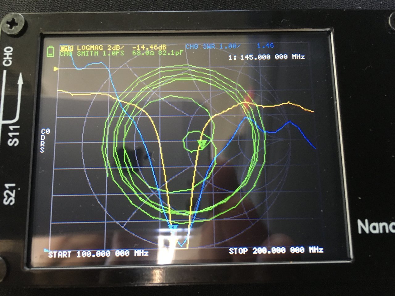

    Behold, improved numbers:
    1.46 set and 14.46db at 145mhz is much better, I think. I’m just starting to learn how to use this instrument, so . Anything I should be aware of? Think I can improve this or should I be happy with the results and just get a mount with a longer stud?

    I had the same problem with my Larsen antenna. I just bent the tab down.

    Ditch the penny bend the tab they are quite strong and stainless. Those Chinese analyzers do at least give you an ideal but don't expect miracles. Don't know about it's options but a Smith Chart is a hard one to use you are better off with a frequency sweep.

    Thanks, I will bend the tab. Just used the penny to try to get a connection.
