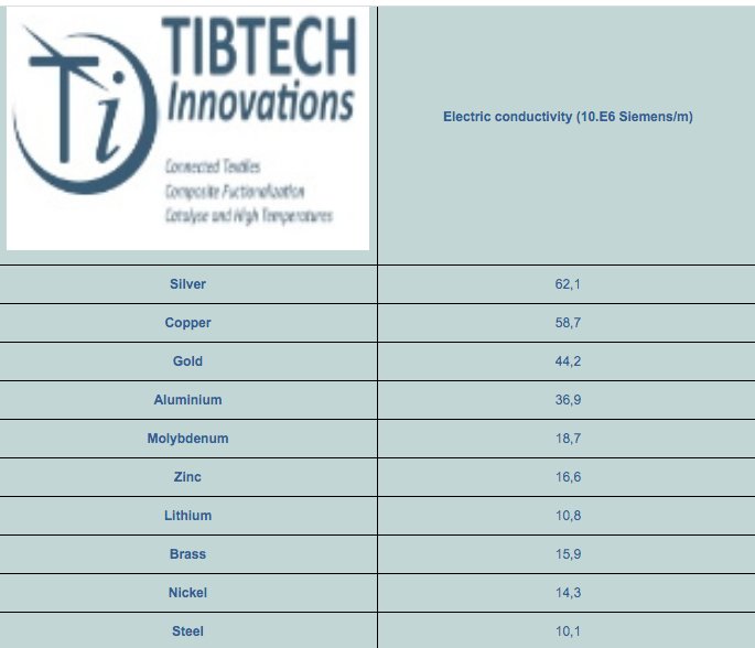

    Hey, I know the immediate answer is going to be "drill a hole in the roof", but with my roofrack that won't fly -- what are peoples thoughts on steel vs aluminum for grounds for antennas? I am going to move my antennas to the bumpers [either front or rear], but want to upgrade to aluminum bumpers for the weight. Should I just start looking for a non-ground-plane antenna instead?

    Dont bond steel with aluminum. Galvanic corrosion

    Also true, I didn't even consider that. I'll probably look at some NGP antennas then.

    I would just bond the fenders, doors, and hood. Use a puddle light mount for antenna. or use flat spot where fender meets base of A pillar/mirror

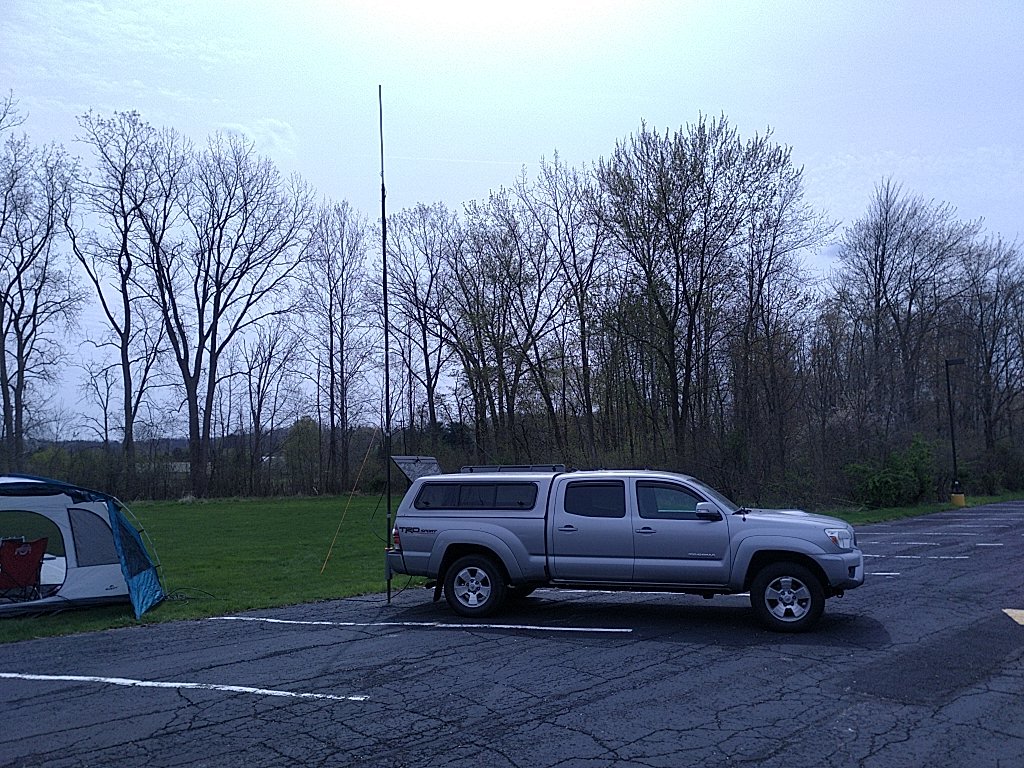

    Ohio NVIS Day. Lots of contacts!!

    Homemade or commercial antenna?

    Homemade. The one you see in the photo is a Ed Fong DBJ-1. Just beyond is a 80m / 60m / 40m turnstile dipole. I 3d printed the center insulator.

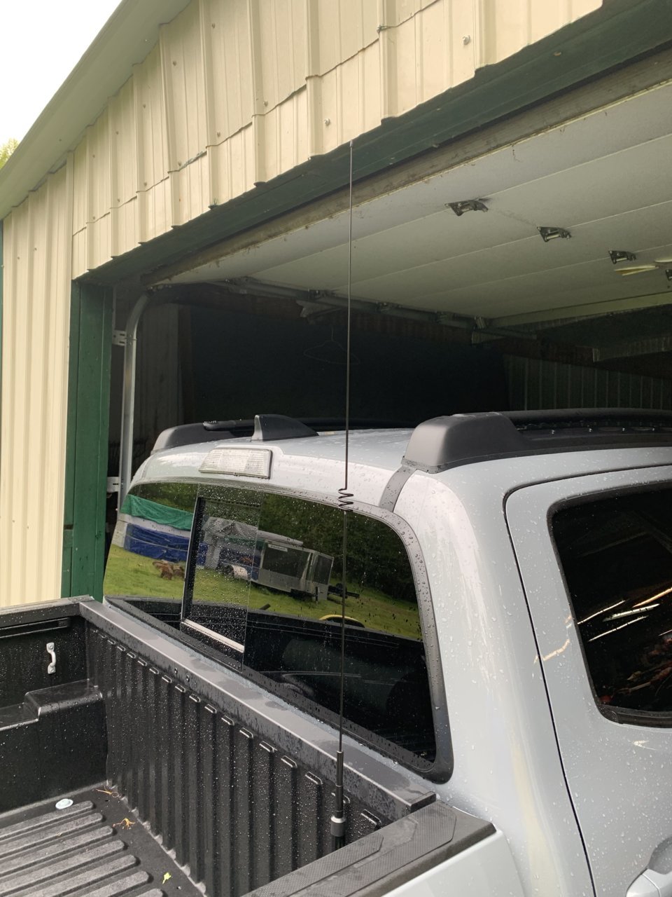

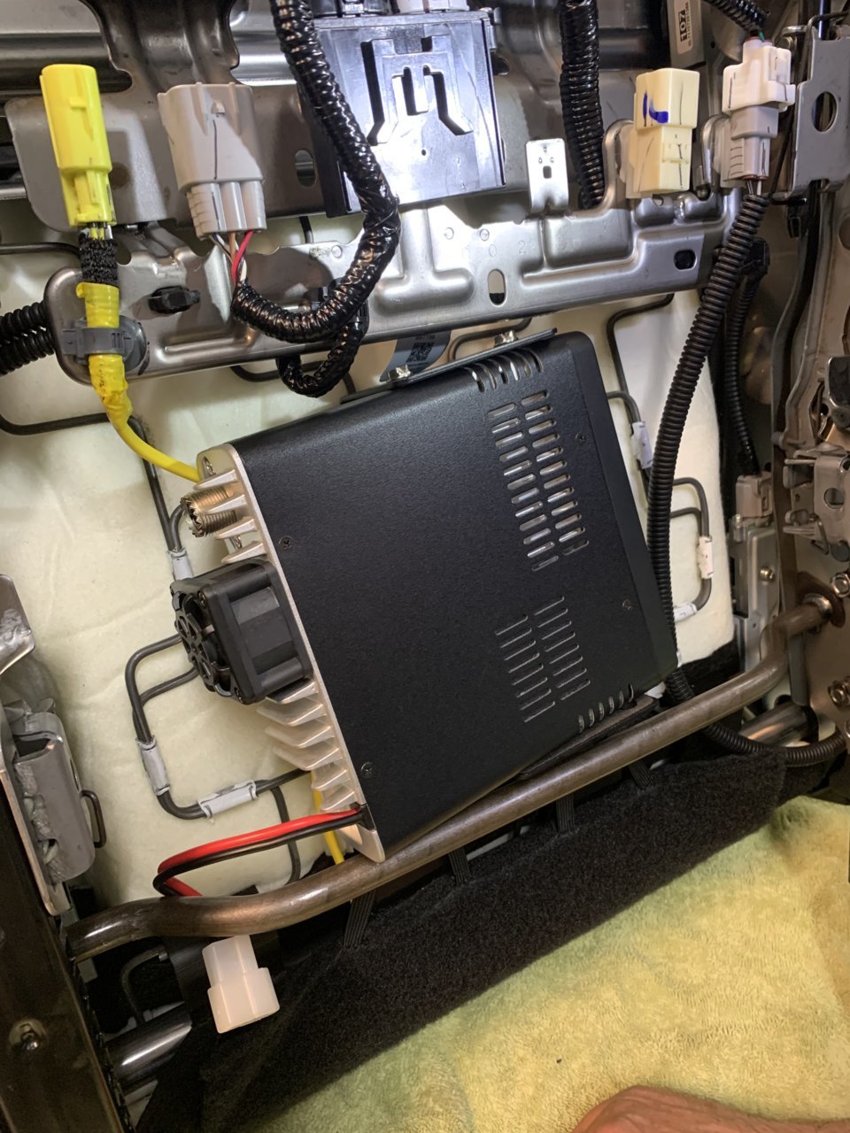

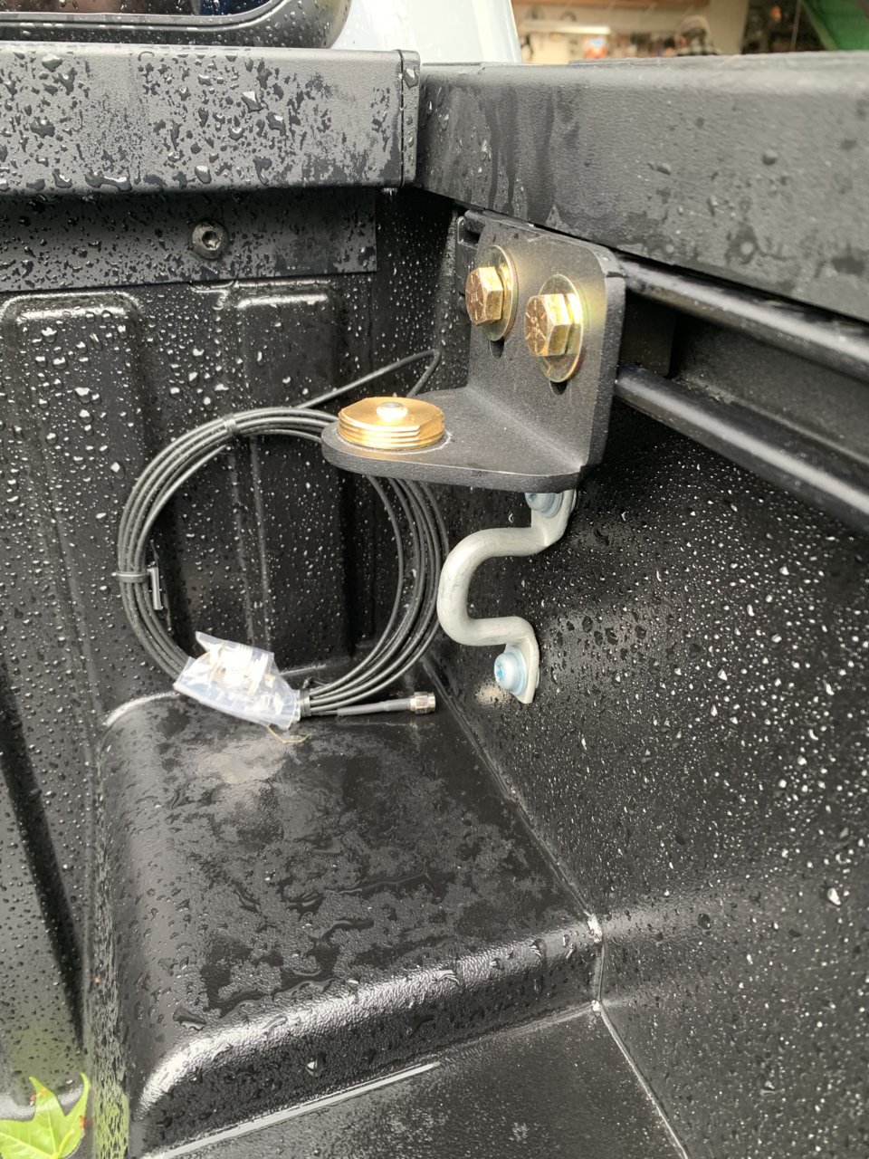

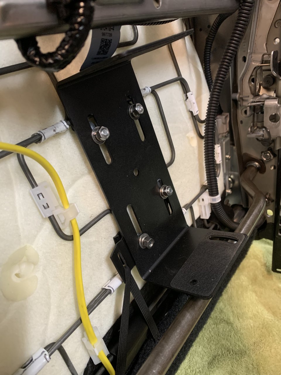

    Hi Tim,
    Great radio for sure! I’m a new(ish) ham licensed back in September 2020. I snagged a ICOM 2730A for my truck and I’m in the process of installing it now. I’ll post more details when it’s all finished but here’s a few pictures.
    I know the antenna is mounted in a less than ideal location but I haven’t really had any issues in my initial tests. I didn’t want to use a mag mount or drill any new holes. The radio itself is mounted under the passenger seat using a bracket.
    Patrick

    Comes down to if it works for you, then it's perfect. You might not get the most range, etc but if you need to talk to someone only a mile away and you can get 3 miles range, then who cares? :D looks good.

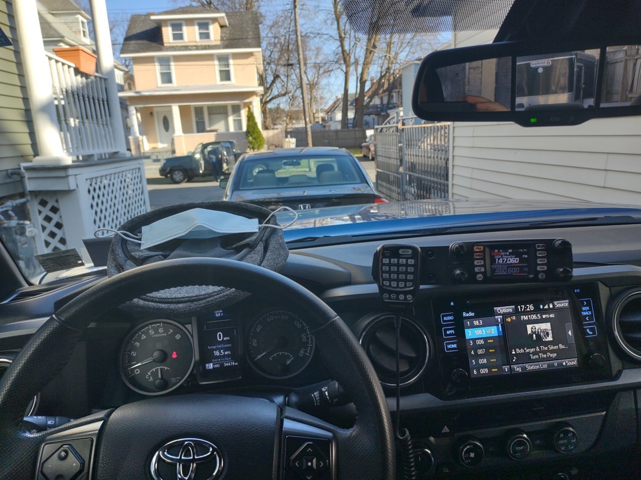

    Well I guess I'll join in here...
    I've been a Tech for 5 years now and am currently studying for my General.
    My mobile rig is a Yaesu FTM300DR using the Multi-Mount from Taco Garage. I still need to mount the base of the radio but unfortunately the supplied power connection is not long enough to reach the battery so for now I have it plugged into the cigarette lighter outlet and sitting on the floor. I should have everything I need to finish the install this week so hopefully it will be mounted by the weekend. The antenna is still a dilemma. I have it on the roof with a mag mount and the wire goes thru the back window, I know not the best but it works. I don't want to drill any holes in the roof so I'm looking for a bed mount solution but having a tonneau cover makes things difficult.
    Call sign: KD2LCH
    73
    D
