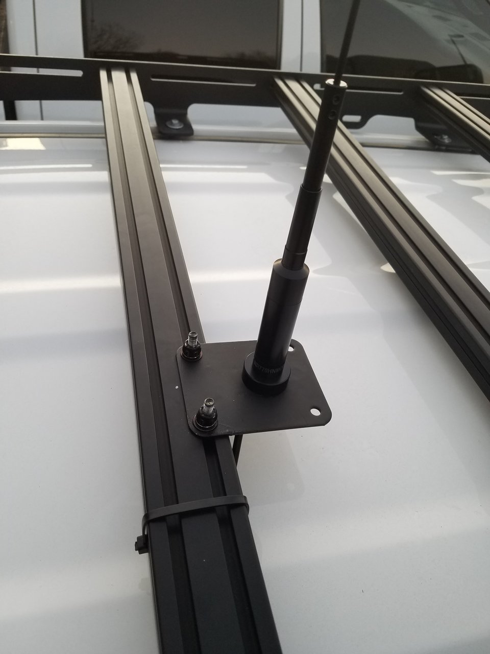

    Temporary mount until I can get a plate for mounting center mass, Comet SBB5 on a CP-5M trunk lid mount.

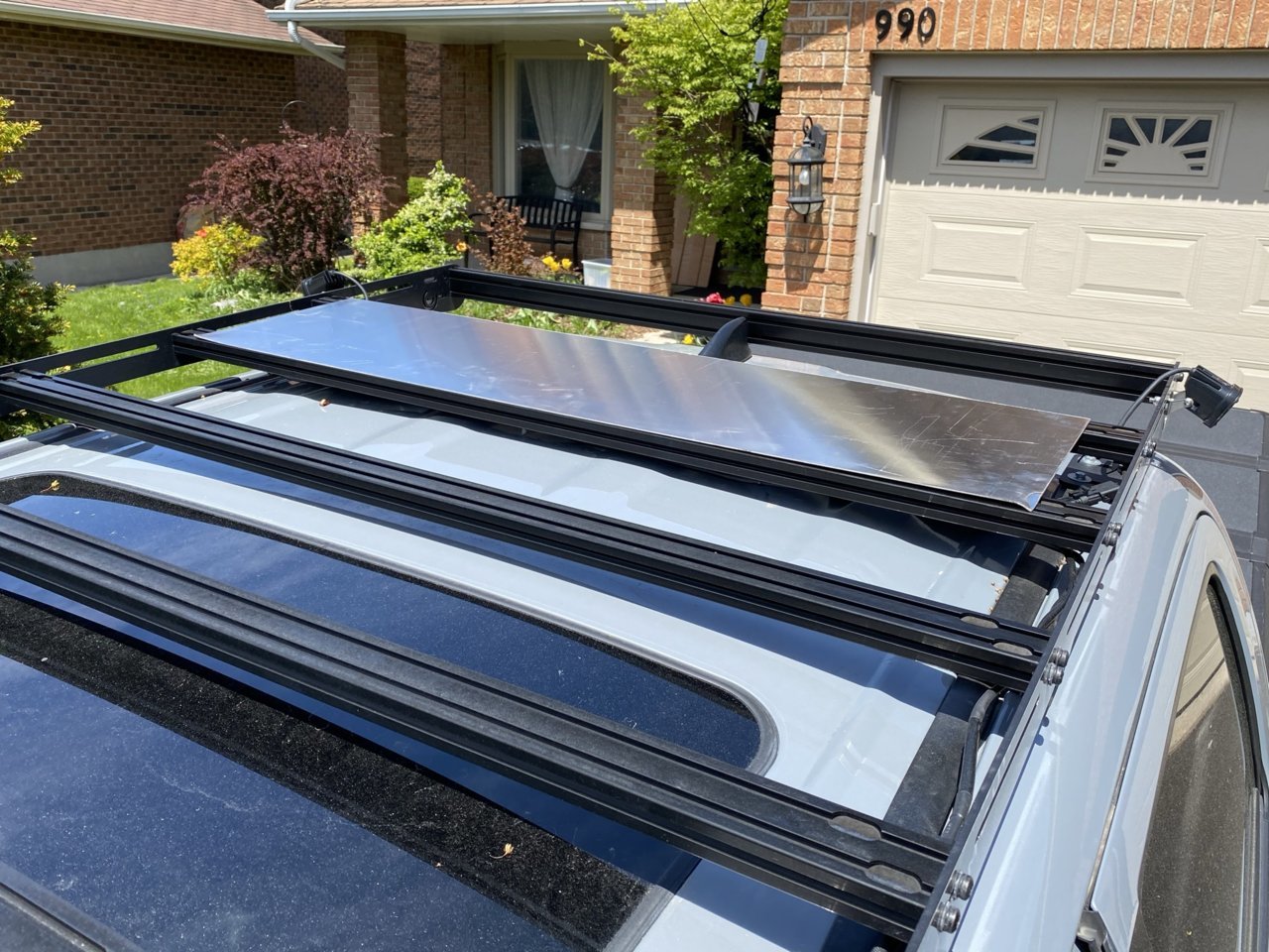

    I plan to use a piece of 63 thou aluminum sheet I bought at a metal supply store for about $30. They had a piece of scrap that I had them cut down to 11.75x43" in a shear. I plan to mount the plate on the underside of the load bars. I bought M5 stud-type fasteners from tnutz.com - I'll use 4 of them on each of the two edges. You just slide the studs in the t-slots and fasten the plate with nylok-type nuts from underneath.
    I will try to scrape away the anodizing where the plate mounting bolts contact the load bars. I might have to get into installing RF braids, but I hope I won't have to.
    If I want to carry something on the rack, I will just unscrew the antennas and put plastic caps on the NMO mounts.
    I am not sure how I will get the coax up to the roof yet. Apparently people just run it up through the door opening and close the door on the coax. Seems pretty ghetto?
    I ordered 2 x #503 and 1 x #501 Breedlove NMO mounts. I think the #501 will work and it's slightly cheaper. The #503 needs less clearance below the mount. I will use one mount for a 2m/440 antenna with my Yaesu FT3D handheld, and the other for an HF antenna for my Yaesu FT-891. I just want to have the third one on the shelf, I'm sure I'll find a use for it.

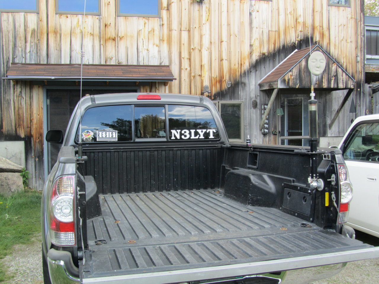

    Don't let the ground plane myth spoil your fun,IMG_4435.jpg best to get the coils above the bed but that's about it. 10-40 meters, 2 meters/440 and 1.25 meters. I literally have worked the world mobile.

    Which screwdriver do you have?

    Looks like either a HiQ or Scorpion Screwdriver antenna.... its been so long since ive seen a Mobile HF antenna

    It's a Little Tarheel with a 54" whip. I have an older High Sierra that's a lot larger I use it with my camper, the Tarheel out performs it. The Tarheel is controlled with a pre select controller kind of like selector buttons on a radio tune to the best reception push and hold to set the freq. I tune it with an analyzer to each band then hold the button to set the memory.

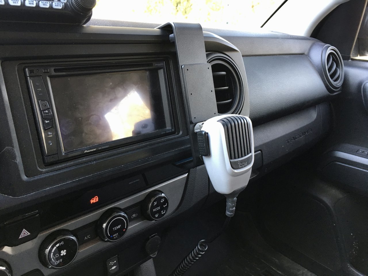

    What dash mount is that?

    https://www.proclipusa.com/
    I have had it for about a month or so. So far so good. Pricey though ($29 bucks for a piece of plastic). But seems to fit perfectly.
