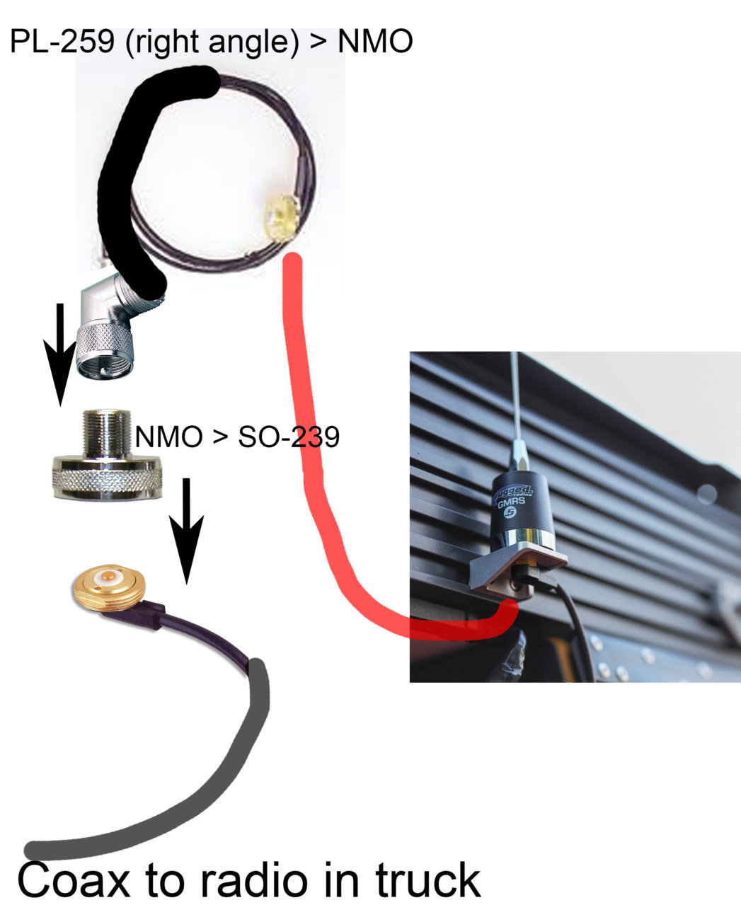

    Those two are the correct parts. You may also want a PL250 right angle adapter so your coax coming out that NMO adapter isn't bent at an angle. The new NMO with coax is unterminated (the PL259 is not connected yet) therefore you can cut the cable to length before you install the PL259. All it takes is a soldering iron.
    I would suggest just installing a new coax all the way to the radio. Mobile installs vibrate too much to trust extra connectors. You can leave the original NMO mount on your brake light kit and install this cap: https://www.amazon.com/gp/product/B004Z941MU?ie=UTF8 It will keep the water out. Then if you want to use it again someday, the connector will still be there.

    If you are going with a custom cable, make sure you bring that bracket with you. So they can run the cable through it before installing the connector. It will be a pl259 plugging into the so239 on your brake lamp adapter which terminates to a 3/8 nmo.

    Excuse the poor photoshop skills. This explains better what I am looking for. I hope the cable connectors were the correct parts. The red line will be the custom wire length which is the unknown factor until I have my GFC installed.

    If you know how to solder and use a pair of wire crimpers you can make it yourself. Connecting to the nmo base is very easy. Pl259, so239 are a little more involved. Especially the smaller ones.
    Hopefully you can find a local to test your set up before you key up for the first time. An swr meter or even a cheap nano vna ($40) will let you know if there are any glaring problems. It will also help you fine tune your antenna to resonate on your most used frequency.

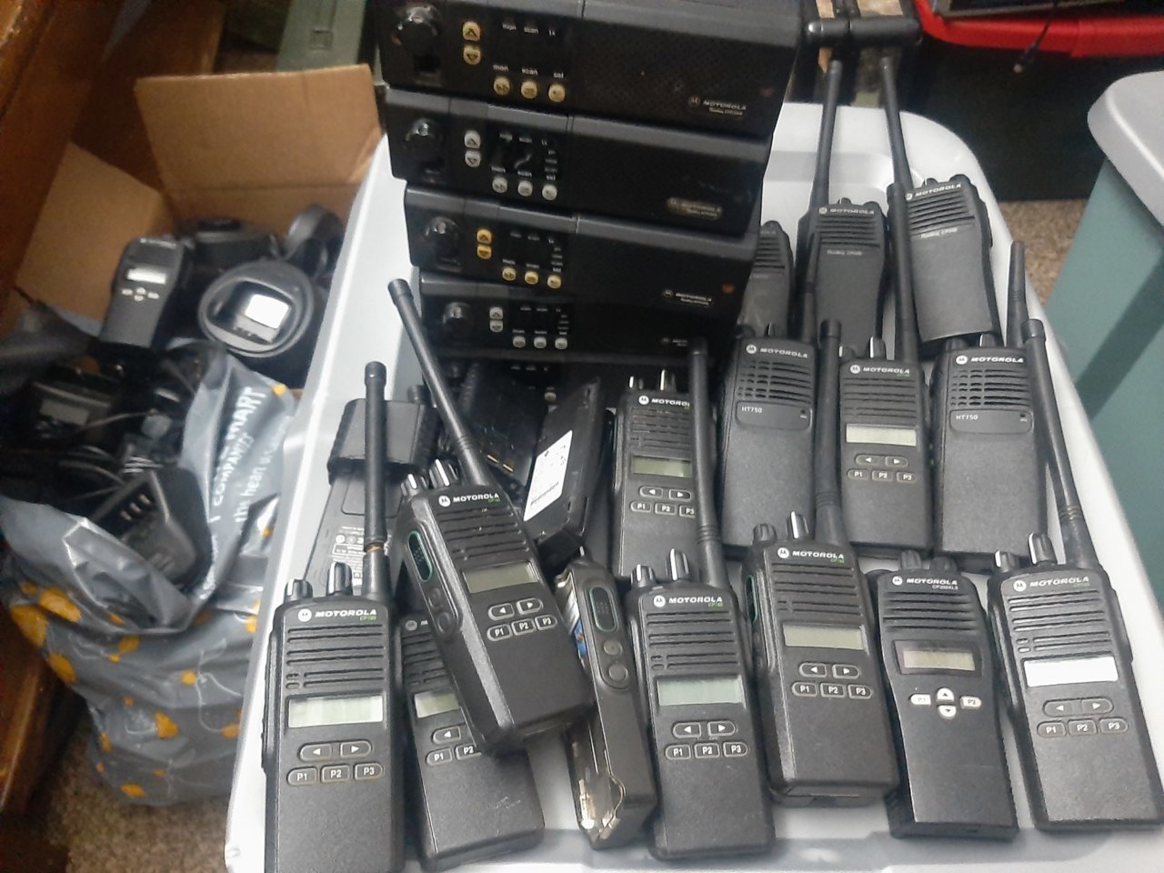

    On another note here is what im working on tonight. Stack of programming jobs, I think these are all VHF. But I know the 200xls are uhf, they somehow snuck in and I need to sell them.
    The Chinese stuff are the loaners, not bad for the price but I know I can't rely on them.

    Like I said, that PL259 connector does not come attached. You can read that in the description of the link you provided. They do that so you can run the coax through a small hole then solder the connector on. The NMO will come soldered but the 259 has to be soldered. The black line you drew will be the side you cut to length and solder. Cut the coax to length and melt it all together (accurately.)
