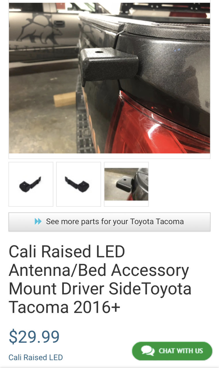

    Good to know… ya I’m looking to add this for the antenna to mount to..DD7EB42B-896C-4096-B24A-8F93DB39E38E.jpg

    That will be okay. Not great, but okay. I aim for the absolute best I can do and just do it once but I understand a lot of people don't like the idea of a hole in the top of their cab. If I ever sell this truck (which I don't plan to), I will just put a little rain cap on it and send it away.
    Make sure your bracket is bonded to the steel it bolts to. Paint --> Paint will give you poor efficiency and propagation (no ground plane). Bare metal --> bare metal is best and then seal it so it doesn't rust. I'm sure someone will hop on here and suggest an antenna that doesn't need a ground plane but I haven't played that game.
    Good luck with the install! Show us how it looks when you are done and good luck on the test.

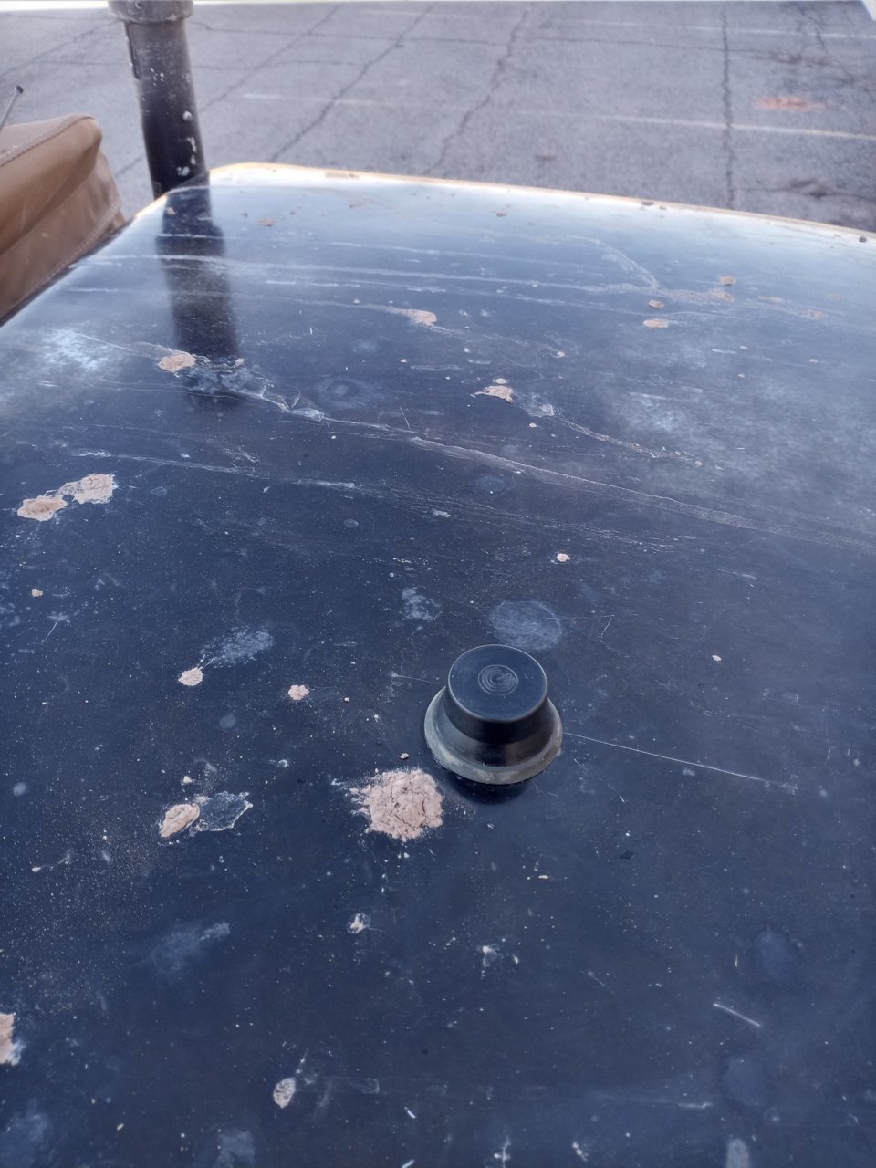

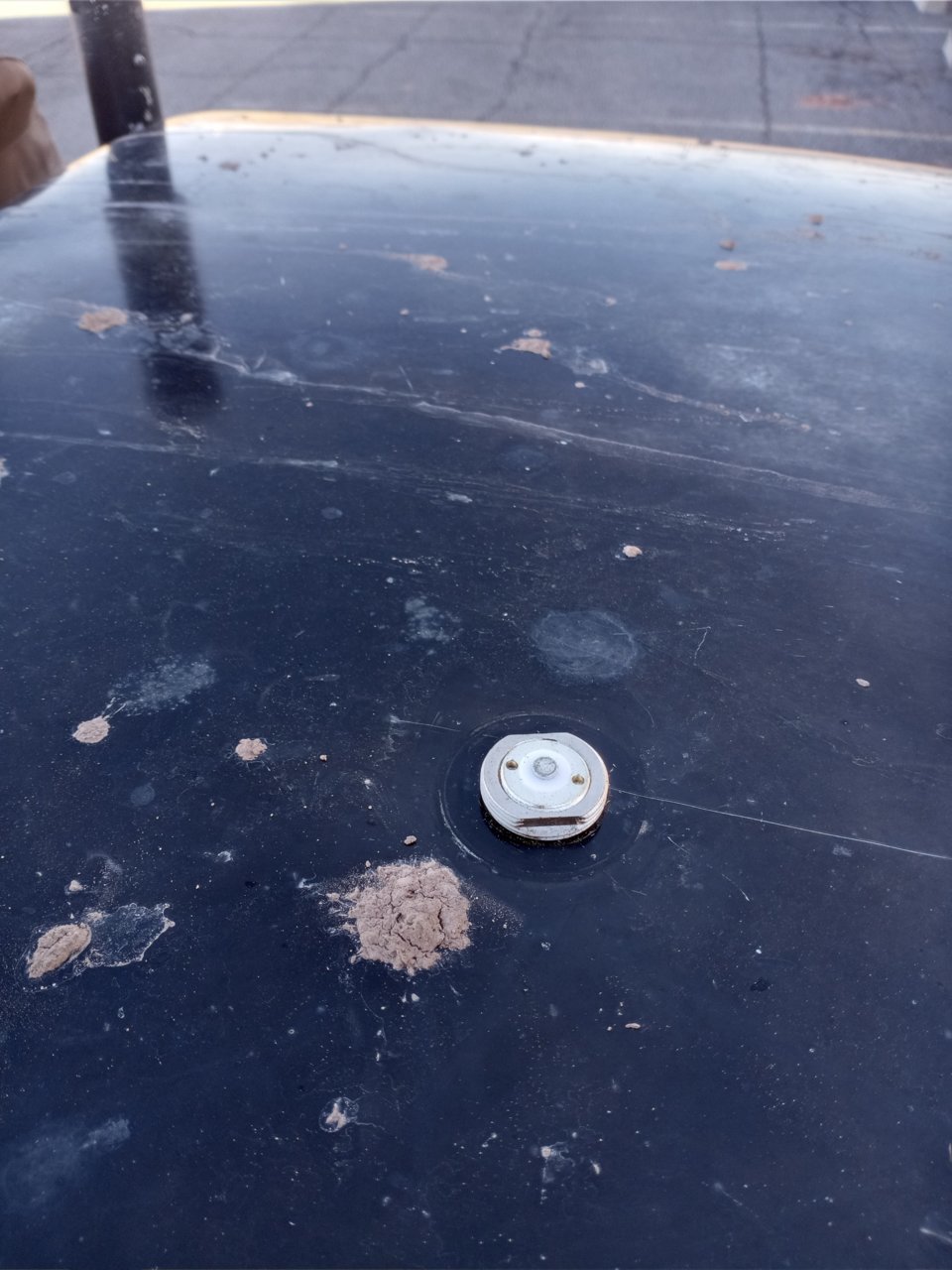

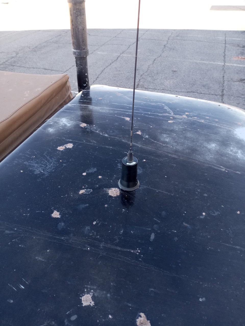

    Here are some photos. Antenna installed, NMO mount without antenna, and rain cover.

    Where are you? I have a driver side one which I recommend over the passenger side for low bridges and trees and shenanigans like that.
    If you're trying to get the best the roof can't be beat. But if you're trying to just be on the air then the tail light tag offs are good.

    I’m in Sacramento Ca the roof Isn’t going to hit on everything? Figured I’d lower my profile

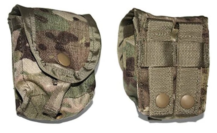

    Here's another cheap/useful accessory, for Baofeng/Anytone HTs. A military surplus grenade pouch fits them just fine. You have to cut a little notch in the flap for the antenna. A snap on the flap keeps it secured.
    They're certainly not waterproof, but perhaps splash-resistant, and will turn dust and dirt. Molle on the back lets it easily attach to many types of packs, or also works well to just run your belt through it. 4 x 2 x 3 inches, get several.
