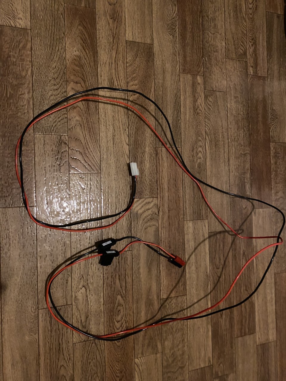

    Some time ago I bought a used Yaesu FTM-350 for my first radio. I haven’t installed it yet as I still need to take the license test :rolleyes:. I’m reworking my dual battery setup and while I have trim panels off I was going to go ahead and run the power cable for the radio to my house battery. That’s when I realized the power cable has 2 fuse holders, one on both the positive and negative wires. I’ve never seen this before and they are in a really bad spot as they will be under the door sill trim and there’s not enough room for the fuse holders.
    Will it be ok to cut them off and go with just the fuse at my secondary fuse block (positive only)?

    http://www.k0bg.com/wiring.html
    "The pictorial at right is courtesy of the ARRL. It clearly represents the correct wiring scenario, whereas the negative lead goes to the same chassis grounding point as the battery's chassis ground point. And as shown, the negative lead fuse shouldnot be removed. The reason is, if the grounding point should lose its integrity, excessive current could flow through the transceiver's negative lead. It also prevents a minor ground loop between the leads. It should be noted, that in some cases, the battery's chassis grounding point is inaccessible. If this is the case, attach the transceiver's ground connection as close to the battery's grounding point as possible."

    In an automotive application you defiantly need the ground wire and the fuse. All mobile radios use the twin fuse setup. If a ground is lost the power will use the radio as a ground not at all good for the radio hence the ground fuse.

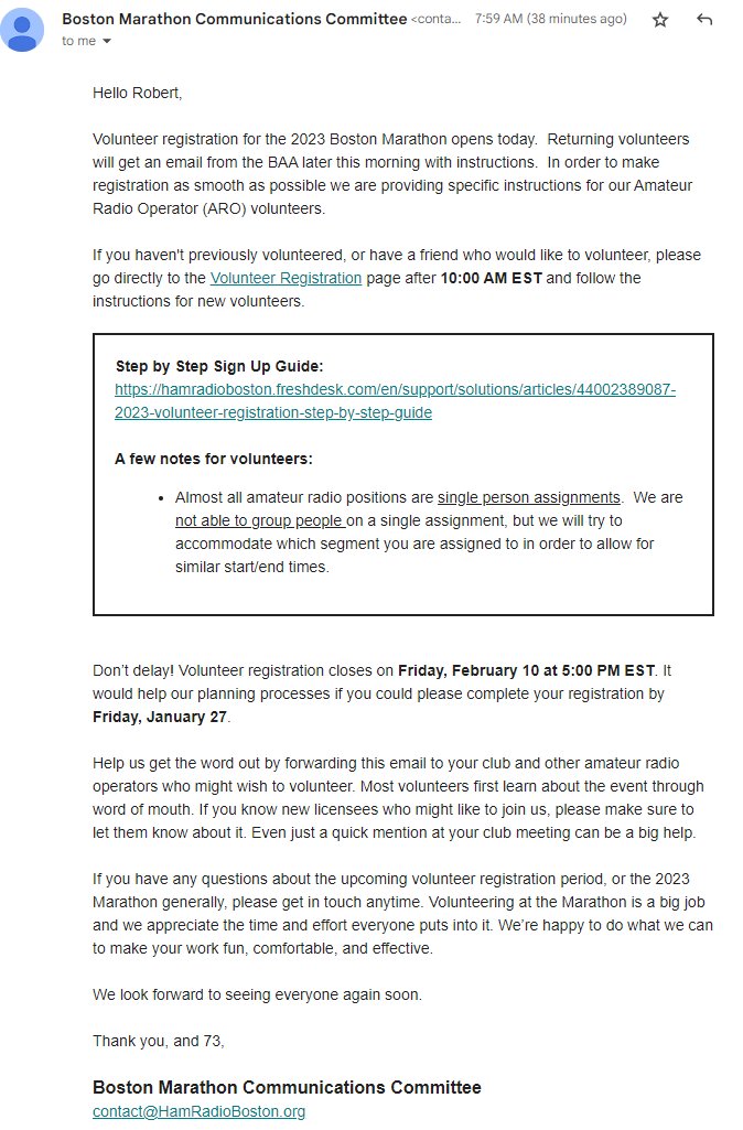

    https://www.baa.org/races/boston-marathon/volunteer/volunteer-descriptions/amateur
    This group of volunteers are communications specialists and assist in the transfer of both emergency and routine messages during the race. An FCC Amateur Radio license is required to act as an Amateur Radio Volunteer, much like you need a driver's license to operate a motor vehicle. If you are not already licensed and are interested in getting licensed reach out to us at contact hamradioboston.org. There are certain volunteer jobs that do not require (although encourage) an FCC Amateur Radio license. Our service is made effective as it focuses upon the clarity, efficiency and accuracy of the communications links we provide. Volunteers who have public safety communications experience are among those so qualified. Please write contact@hamradioboston.org to see if you qualify.
    Race day is Monday, April 17th this year!
