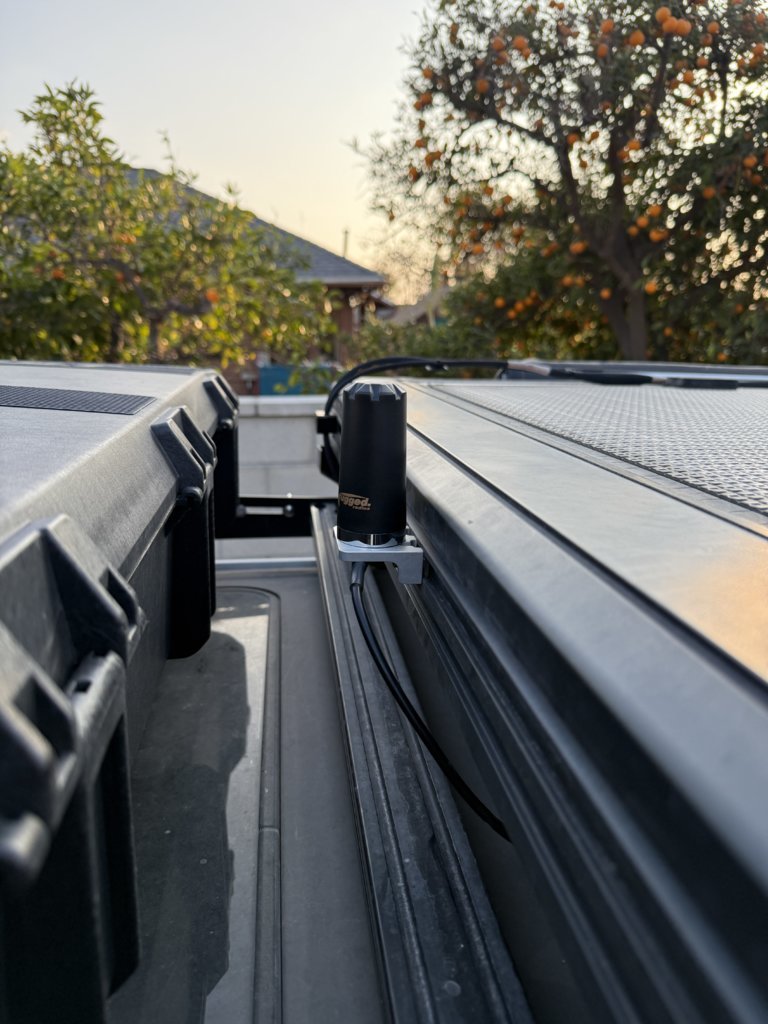

    1-unlicensed. As mentioned, I use this strictly for desert races (Mexico SCORE mainly)
    2-Antenna is a VHF 1/2w NGP cut to operate on 154mhz (39.8”) and coax is RG58/U
    3-Antenna is mounted above the roof, off the front edge of my GFC camper (I can get pictures)
    4-Freq’s used are in the 151-156 range ONLY
    5-This is purely simplex, I have no repeaters programmed
    It is currently powered through a SwitchPros with a 20A max fuse.
    As an update to my previous post, I disconnected antenna and coax connections and checked everything for continuity, from antenna tip to the end of the coax and my results were 0.
    Another SWR test conducted within the 151-156 band and I am now in the 4.0 SWR range and power output in the ~40w range.
    There are some urban environment factors that may be playing a role here but I do not want to rule out equipment issues.

  11. Jan 30, 2025 at 7:36 PM
    #9411
    JasonT87
    JasonT87 Well-Known Member
    Feb 6, 2016
    #177280
    1,023
    Jason
    Southern California
    '16 TRD Sport DCSB
    Total Chaos mid-travel front. JD Fab SUA rear.
    I’m going to add a picture of how my antenna/mount is setup to give those who are able to help an idea. Pictured is my NGP ‘low profile’ vhf antenna (tuned for 150-158) however I also have the whip as stated earlier.
    I am unable to move the antenna mount much due to the 40” coax length (it is threaded at the 3rd brake light). A new 10’ coax will arrive tomorrow and I will test the new cable to rule out the current coax.
    Are there any issues with my current antenna location VS mounting it on the driver side of my GFC or even the ditch light locations?

  12. Jan 30, 2025 at 7:56 PM
    #9412
    firemaniac
    firemaniac Well-Known Member
    Jan 27, 2013
    #96239
    88
    Northwest corner of Montana, Troy/Yaak area
    04 DC 4x4, Flatbed, auto, teardrop tugboat.
    Flatbed, Bilstein/OME 883 lifted, ARB bumper, Warn M8000, Onboard air, Onboard water system, Lights, Lights, Lights
    You might start by adding a ground strap going between that mount, and the frame of the truck. A camper, with a rubber seal on the bed rails, not to mention all the painted surfaces don't conduct very well, and having the a good ground should help.
  13. Jan 30, 2025 at 9:05 PM
    #9413
    JasonT87
    Feb 6, 2016
    #177280
    1,023
    Jason
    Southern California
    '16 TRD Sport DCSB
    Could you explain in detail where/how the ground strap/loop would attach to the nmo mount?
    Might answer my own question here but would moving the mount to the roof rack (which is bolted to the roof) be an option? Currently the antenna is mounted to an aluminum bracket but can be changed.
  14. Feb 1, 2025 at 7:17 PM
    #9414
    firemaniac
    Jan 27, 2013
    #96239
    88
    The NMO mount should ground/connect to the bracket by design, so a ground wire/strap connected from one of those bracket mounting screws should work well.
    The rack bolted to the roof might offer some improvement, but also could have some of the same problems with rubber seals and paint blocking the electrical path, and might end up still needing a ground wire/strap also.
  15. Feb 2, 2025 at 2:01 AM
    #9415
    JasonT87
    Feb 6, 2016
    #177280
    1,023
    Jason
    Southern California
    '16 TRD Sport DCSB
    Copy that. The aluminum bracket is not going to work even with a ground wire.
    Though I have spent some hours diving into my setup. I might have found a 40” ‘jumper’ cable that may be faulty. At first I thought it was antenna placement. I’m going to replace that section of cable tomorrow and test my theory. For whatever reason, I put a new 10’ coax in place of the ‘bad’ 40” jumper and was getting SWR readings down to 1.1-2.0 and power from 40-55w (50w radio) no matter where the antenna was placed. As soon as I put the 40” jumper back in, SWR was 4+.
    firemaniac[QUOTED] likes this.
  16. Feb 2, 2025 at 9:18 AM
    #9416
    crazysccrmd
    crazysccrmd Well-Known Member
    Mar 17, 2016
    #181592
    9,242
    Alaska
    Aprilia Tuareg 660
    I had my antenna mounted similarly on the front of my GFC aluminum extrusion and had no issues without a grounding strap.
    firemaniac and JasonT87 like this.
  17. Feb 2, 2025 at 10:34 AM

  18. Feb 2, 2025 at 10:44 AM
    #9418
    crazysccrmd
    Mar 17, 2016
    #181592
    9,242
    Alaska
    Aprilia Tuareg 660
    I did not, solely seat of the pants if you will. Long distance radio direct to radio and off repeaters with reports of clear transmission quality was good enough for me. It was a Kenwood 710G with a Comet SBB7.
    JasonT87[QUOTED] likes this.
