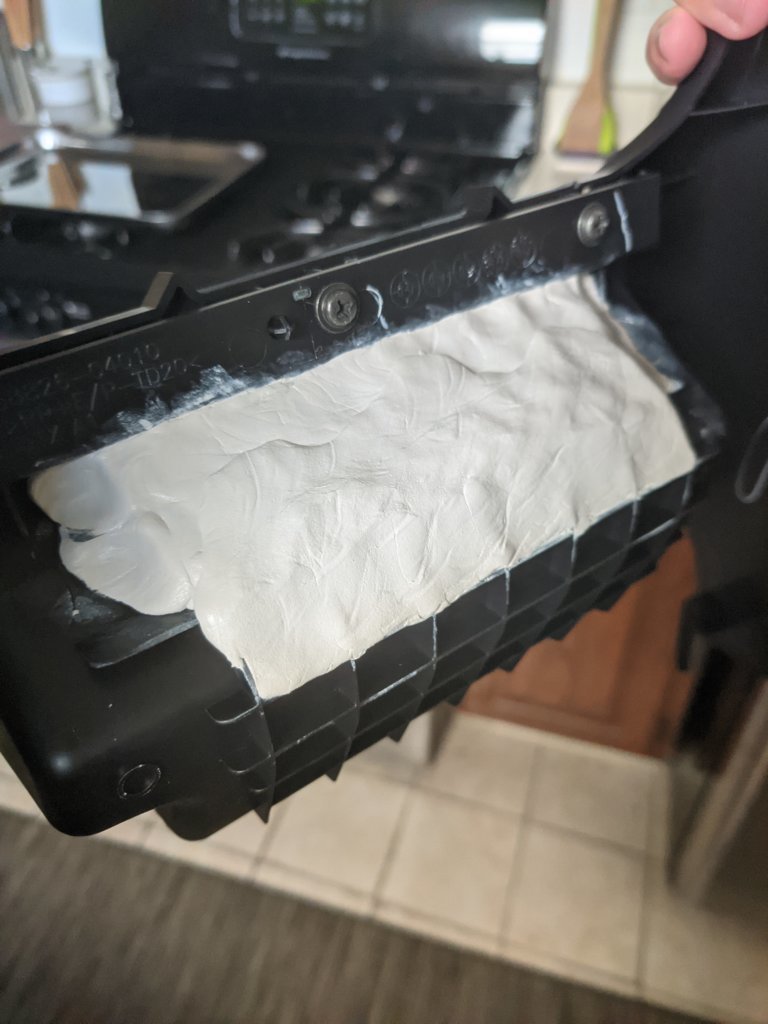

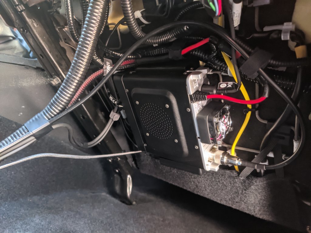

    Installed an FTM500 in my truck last week.

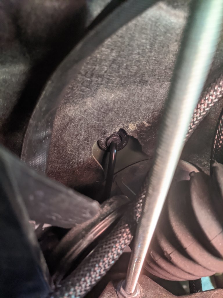

    Used PCTEL NMO Mount on the Victory 4x4 bracket. The mount is designed for a thick surface so I had to put a bend in the Victory bracket. If the mount or coax ever fails I may look for a different mount that does not has as many threads on it but I liked the construction and how it appears very water resistant. I added some clear silicone under the bracket the next day (not shown in the photo).
    The coax is routed over the hinge, fed into a cable sheath, and behind a panel in the engine bay then through the firewall on the passenger side and over to the driver side where I tipped the cable.
    Radio body is mounted under the driver seat with the included bracket to the seat springs with some zip ties. I was able to mount the bracket then slide in the radio. You can make out in the photo a Mobilinkd TNC4 which I attached to the back side of the radio with some velcro. It is powered by USB running to an aux power source I have by the driver side footwell fuse box I have posted about before.
    The Mobilinkd improves the APRS interaction with the radio in my opinion by allowing the use of a mobile app like APRSdriod. I tested two antennas with an antenna analyzer and got good readings. With a Comet SBB5 I was getting 1.03 on 70cm and 1.01 on 2m.
    For the mic I used an RJ45 passthrough Toyota switch and added it closest to the driver. I had already relocated the ETC to the shift knob and deleted the Qi button a while back. So I moved the BSM and Parking switches over a space. I had deleted the Qi early on as I don't even have a phone with wireless charging and had heard of the bubble that happens. Well the bubble happens sometimes even if you never use the charger. For this install I finally did a full delete of the charger, I found the SR5 cubby online and swapped it out.

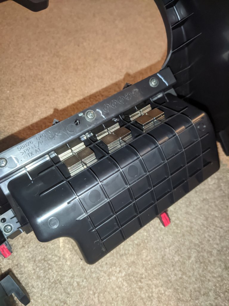

    Magnets were added to the underside of the cubby and some JBWeld Plastic apoxy. Another RJ45 passthrough was added to the back of the cubby. Yaesu sells a steel bracket that I attached to the head unit and it sticks nice to the magnets. When testing it indoors I was holding the plastic trim upside down and shaking it and the head unit did not budge. Hopefully it holds up over time but I am happy with the result. The magnets also hold anything magnetic in place that I toss in the cubby which is a plus.
    The head unit and mic are stowed away in the center console when I don't want to use the radio.
    Power for the radio is connected to one of my switch pros inputs.

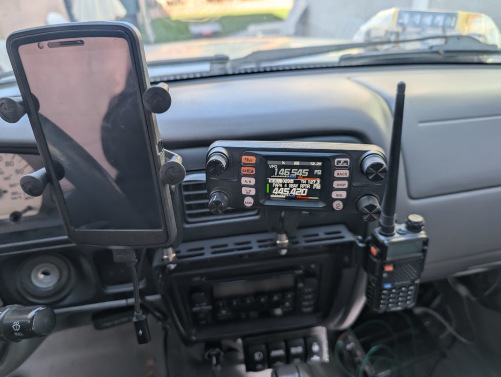

    Also second that mobilelinked makes APRS on my FTM300 actually fun.
    I used to have my FTM300's head unit down by the shifter but now I have a TEQ offroad chinga to mount it on. I'm split- I liked how low-key the original install was, but its much easy to operate and monitor on the TEQ.
