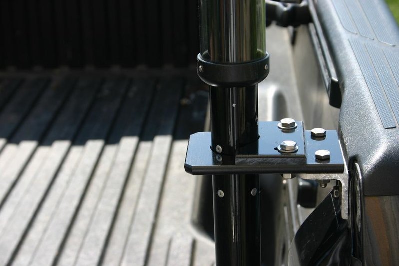

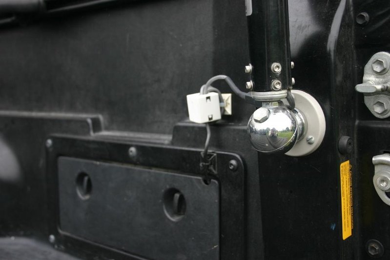

    Hi all,
    I would like to install an HF radio in my 2013 DCSB and I am looking for suggestions on installing a Lil Tarheel II. Has anyone installed one of these antennas on their truck? If so where and how did you mount the antenna and what other steps did you take for the installation. Pictures would be great!

    That's a great antenna does amazingly well replace the whip with some thing around 56" It may screw up you 6 meter band but the HF side will shine you can all ways put the shorter whip back on for 6 meters. The mount on the body is a standard ball mount the black mount at the top is home made the black part is lexan the entire antenna is RF hot so it can not be grounded. Yes you need a ground but the ball mount provides all the ground that is needed the coax brad is landed under the mounting screw for the mount. Do not buy into the ground plane myth. P.S. remove the tail light assembly for your wiring install.
