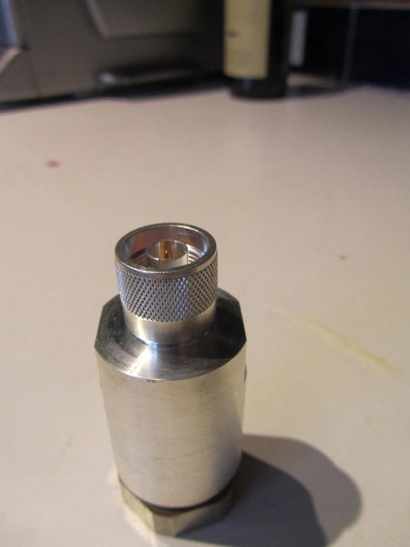

    Here is my ideal of a proper connector I can see this one!

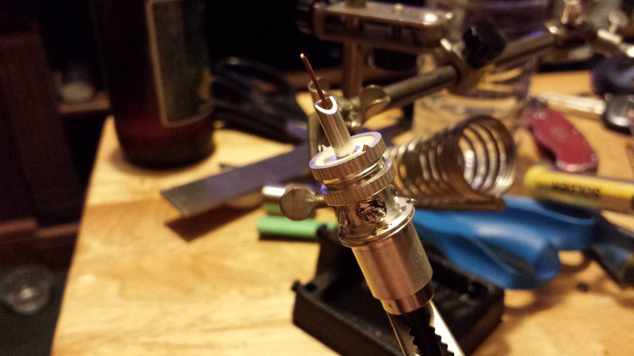

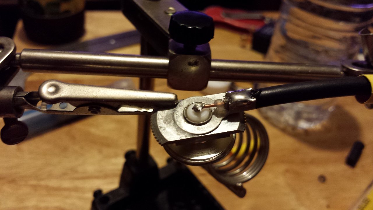

    Most important part of installing those is a ruler.

    I run a Larsen NMO style through the roof on my Tacoma. And depending on type of wheeling I do I'll either have a 19" 1/4 wave or the longer 5/8 wave antenna. I also run a NMO mount through the roof on my crawler with just a 1/4 wave antenna. I believe that the 1/4 wave propogates better in box canyons that I'm normally in with the crawler when on the trail.
    I soldered everything myself for the crawler, ended up being a lot easier then I thought it would be. I also Google that crap out of how to solder connectors before my first attempt.
