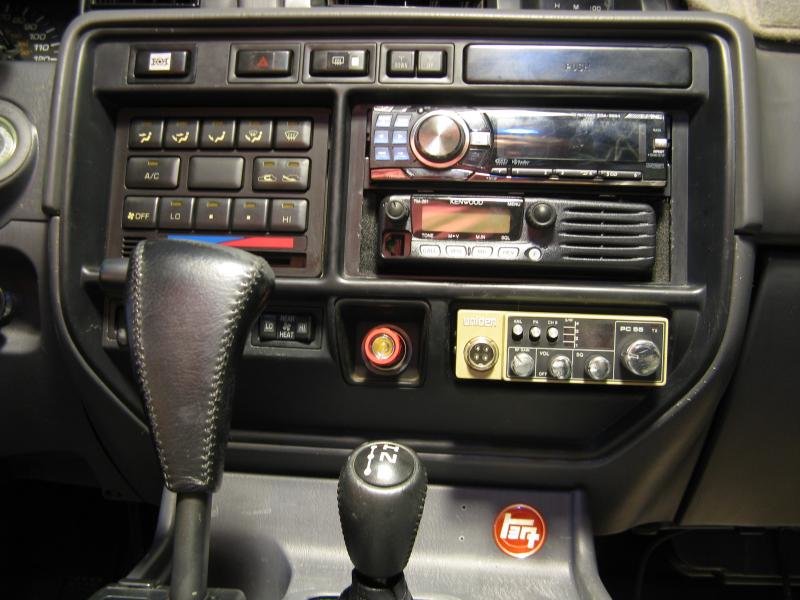

    thanks for all the Great Advice Guys.. Love the set up... I think i decided that i am going to go with the 281a. i decided it for a couple reasons. i love the 65w of power.. single band is all i really need right now because it will mostly be for trail rides and in a emergency situations. i saw a picture on the internet the other day which i want to try and achieve... I think i am going to go with a nmo series Larsen antenna as well..

    My only concern would be heavy use on 65 watts might get pretty hot with zero air flow over the huge heat sink on the 281. I think the kenwood would be fine but the stuff around is not ready for that heat

    I can use mine for a good rag chew on low power without any concern, haven't done that on high power yet but that's why I didn't go in front of the shifter

    didnt think about that. you really think so?.. crap .... guess the center console with an external speaker.... maybe... choices...

    I can hear mine with the lid closed at 3/4 volume. If you operate on low power except when the 65 actually is needed I think it would be fine in the dash

    You could always add a 12V computer fan back there if you have the room.

    i wished i had room.. its just like the tacoma and the cross bar is litterally right there... its the prefect size 2-din size for the kenwood radio combo..
