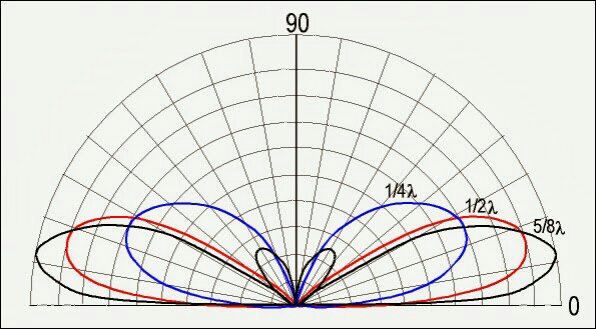

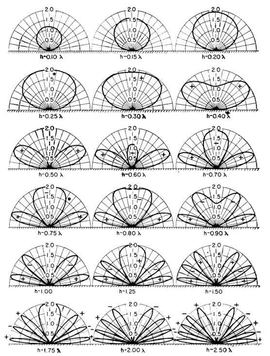

    The main difference between 1/4, 1/2 and 5/8 wave is the angle of the signal. I don't remember which is which, but one sends the angle more horizontal and one is more vertical. So depending on your terrain, they may make a difference in your need.
