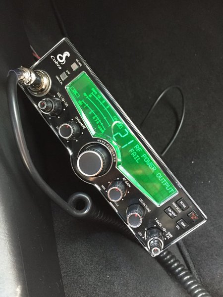

    My cb 29 lx radio isnt working and i can get the bar to swing from the swr side to the cal side. What did i do wrong???

    Ground it better

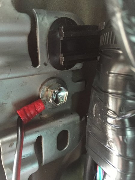

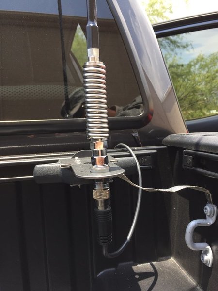

    Here is what happens when i run the check. And that is my ground, which should be good?

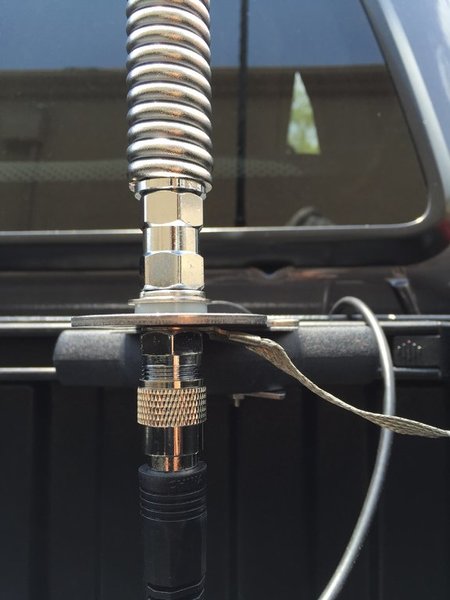

    What do you think?

    Check your antenna ground, that's what will majorly affect your SWR. Grab a multimeter and ensure your mount is well grounded.

    As Chris said, did you powder coat the antenna mount? Gotta scrape it bare

    I don't think that D-ring is tied to the frame. Also does that mount hole have bare metal exposed?

    the d rind is not attached to the frame but it is grounded by that fat silver grounding wire.

    It's not grounded then. You need to get that mount grounded to the frame.

    The fact that you have a grounding wire, doesn't mean that it's grounded. You need to connect that "fat silver grounding wire" to the frame or something that is grounded.

    Find a CB/Radio shop, they usually charge a few bucks to put an SWR meter on and tune it. They can also tell you if it's grounded or not. Also, jump into the AZ BS thread, there are several guy in Tucson and one of them may have a SWR meter that can do it for a beer.

    It's been said, but I'll say it again. With the plastic bed our trucks have. The "Ground" in your setup here consists of the shield on the coax. And about 4" of braided wire. To dramatically improve this, run another copper braid from the other side of that d-ring down to the frame. While you're at it ground both fenders to the frame, the cab, tailgate, doors, and hood.
    I promise you're radio will thank me. :)
