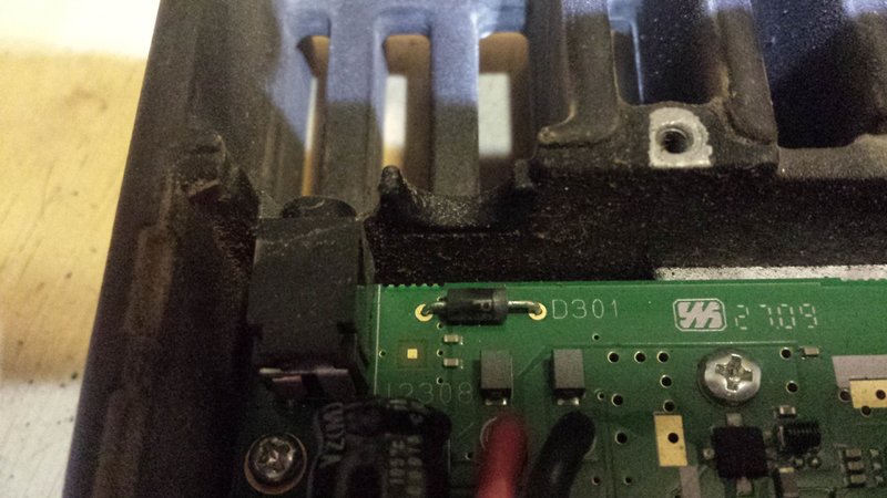

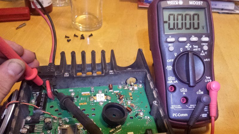

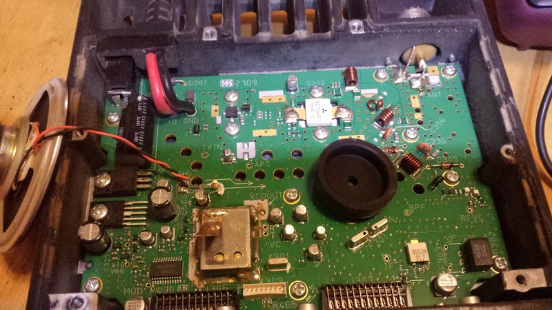

    My Yaesu FT-2800M popping fuses instantly as soon as I place one into the fuse holder. I think I may have blown the surge protection diode labeled as D301 during a recent wheeling trip since my Optima Yellow Top battery was having issues resulting in many jump starts during the couse of the run. I conducted a diode test using my multi-meter which gave 0v or no reading across both sides. Also getting the same result when ohming it out. Also has continuity both ways, that diode is toast! Now I have to decide if I want to try and replace the diode myself or find a local HAM that would do it for some beer or something.

  10. Nov 12, 2015 at 9:10 PM
    #1510
    MonkeyProof
    MonkeyProof Power Top
    Oct 7, 2008
    #9774
    12,823
    SoCal- SGV
    Awesome info, will make it easy to find and replace that diode. :thumbsup:
    I can tell you that the alternator and charging system has been thoroughly tested finding the alternator is fine and the Yellow Top battery having a bad cell. The battery had low CCA's and would not charge over 10.5V. My rig was jump started at least 10 times that night using various jump packs and jumper cables. It was the very last jump start I got that blew the diode, I'm sure of that. The Yellow Top has been replaced under warranty.

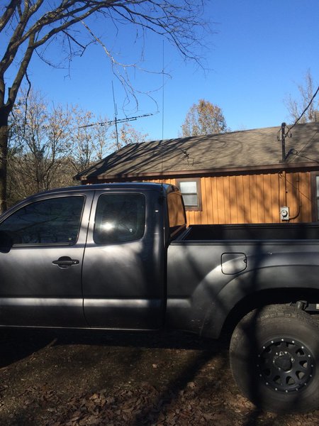

    cllowe24
    cllowe24 Well-Known Member
    Oct 24, 2015
    #167538
    630
    Mid Tennessee
    2015 access cab
    Billstines with 885 coils 2”aal Lce header, pro dry drop in filter, charcoal filter removal, light bar in grill, ditch lights, yaesu dual band radio, and a bunch of other junk
    Put my 5/8 wave on this morning. makes a big difference.
    llibrm and Chipskip like this.
  16. Nov 14, 2015 at 2:53 PM
    #1516
    Lars
    Lars Radio Active
    Oct 25, 2014
    #141032
    1,285
    Lars
    Cedar Creek, TX
    '10 Tundra TRD RockWarrior
    Yes.
    could you do a couple detail photos on the mount, and how it's attached to the AC door?
    Thanks :)
  17. Nov 14, 2015 at 2:59 PM
    #1517
    Crom
    Crom Super-Deluxe Member
    Jun 22, 2009
    #18782
    9,642
    Nick
    San Diego, CA
    2009 4x4 DCSB Camp Supreme
    Millions
    I's that one of those diamond mounts?

  19. Nov 14, 2015 at 4:31 PM
    #1519
    bluewaters182
    bluewaters182 Well-Known Member
    May 14, 2012
    #78794
    1,729
    Greg
    Ohio
    2019 4runner TRD premium
    Weathertech Mats, Leer 180 Cap, Icon 2.5 coilovers w/700lb springs, Icon UCA, fox 2.0 remote resi 10" travel rear shocks, nitro 4.56 gears, carrier bearing drop, Level 8 guardian rims 16 x 8.5, 315/75/16 Cooper ST Maxx, satoshi grill, shorty antenna, BHLM, color matched eyelids, rear diff breather relocated, exhaust chop, mudflap delete, debadged, All Pro front bumper powder coated white, smittybilt x2o 8 comp winch, SOS sliders, illumination supply 30" single row led bar, uniden 880 CB w/2' firestick on relentless fab hood mount, full AllPro skids, AllPro expo leaf springs, AllPro U bolt flip, Ultraguage, interior LEDs , trimmed fenders and flares 2", AP ext brake lines, CMC, fire wall massage, pelfreybilt battery box, diehard group 31 battery, Kragen 7" HID, homemade HiLift mount, Yaesu ft-8900, Ellis precision AT shifter, EBC yellowstuff & sport rotors, PIAA 510 fogs, Safari snorkel
    Looks to be a heavy duty lip mount. There are many different styles and brands, here is a picture of the one comet makes.[​IMG]
    Oct 24, 2015
    #167538
    630
    Mid Tennessee
    2015 access cab
    That's exactly what it is
