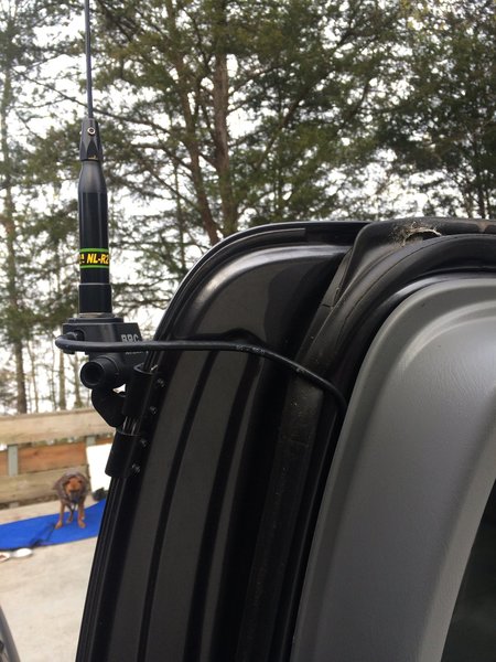

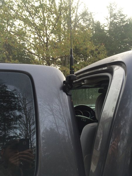

    Is it attached to the back edge of the door then? Does it clear the rear of the cab when you open the door all the way?
    I've got an RS-840 mount that I modified a lot for use on my truck, but I like the idea of getting the antenna up higher, and not having it interact with the bed. If/When I build my bed rack what I've got is going to get in the way.

    Yes it is on the back edge and clears fine

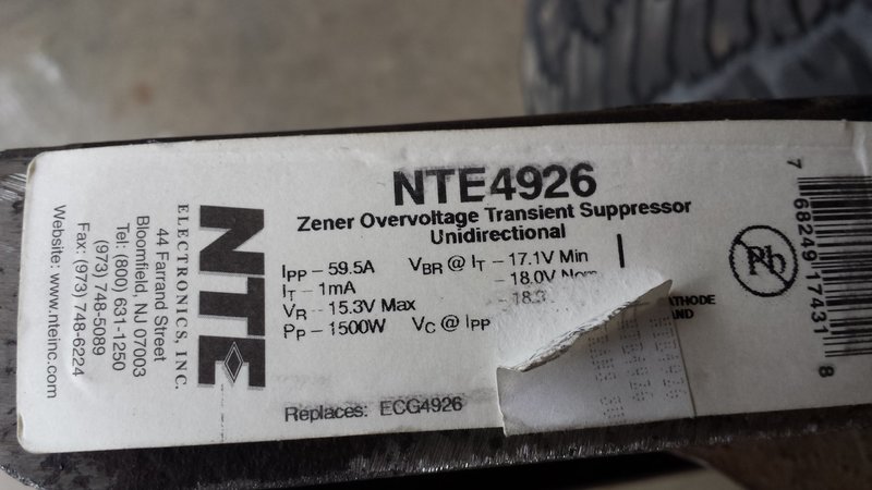

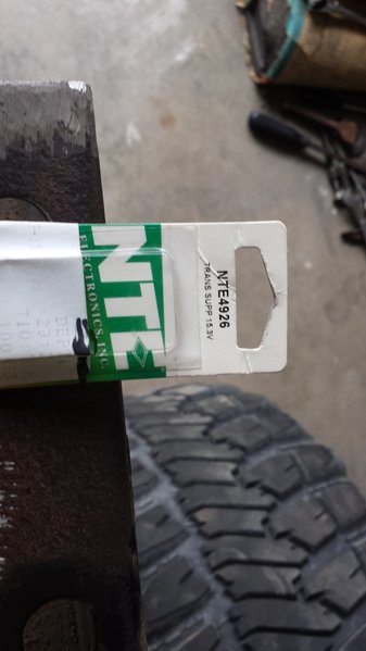

    20151115_133455.jpg 20151115_133455.jpgwhat am I looking at here? Is this the right TVS diode that I need?

    @MonkeyProof that is a different part number/company than the one I posted and the voltage looks low. Here's the website that talks about the repair I found earlier, and a quick google search of where you can buy them.

    Awesome! Thanks for the link...I didn't want to pay 8 bucks for a 50 cent diode so I chanced my luck at Frys..

    The length of the NTE4926 will fit without any interference but the leads like you mentioned will be close. I'm going to try it out and if it doesn't fit then I'll order the PKE18A.
