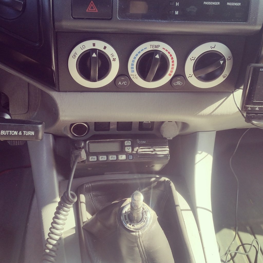

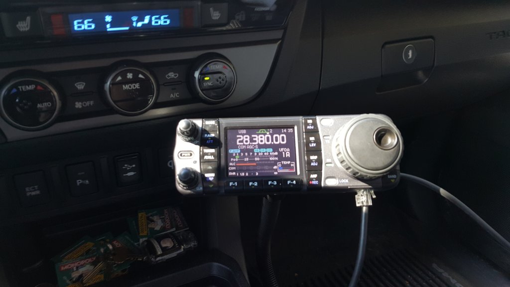

    Well, I decided to swap in the IC 7000. Currently using a mag mount (works for now) and a Wilson 1000 cut for 28.500Mhz. I did grab a Tram adapter so I can use a 20m hamstick (while parked) until I figure out a more permenant solution. Tempted to order a LDG at-100 for a 102" whip which would get me 10m-17m. I prefer a resonant antenna though. Hmmm?

    Build a tray it's easy and cheap an SD keeps it from resting on connections

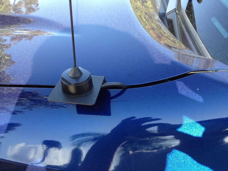

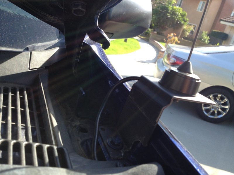

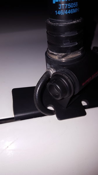

    Hey fellow ham'ers! just want to show you my setup and would like some feedback from all you experts out there. I have a Kenwood TM281a with 1/4 wave Larsen antenna mounted to the hood. My main concern is the hood pinch on the coax cable. Any of you guys and gals who have the same setup please share your experience or issues. Thanks:thumbsup:

    Mine is like that, no troubles.

    I would have mounted closer to the windscreen and just routed in the wiper cowl..

    I had my VHF/UHF on the edge of the hood at first. I did actually end up damaging the coax after about a year.
    I think not having the antenna move with the hood will make it a little easier to adjust how the coax sits.
    I might recommend drilling two holes in the vertical section of the mount, and running two zip ties to hold the coax securely in place along side the mount.

    Thanks for the tip:thumbsup: Where do you currently have your coax mounted to?

    I have a CBI hood mount for one of my antennas. I ran the cable in through the driver's door, into the trim and under the carpet. No pinch points.

    I would get the CBI hood mount only if they made one for NMO style connectors. The concept of mounting it to the hood hinge bolts would solve my issue.

    Just drill it out, I had to for the VHF connector.

    I would not want to push 50 watts of RF into my head like that. Get it up on the roof, and it will serve as a nice ground plane and create a better transmission pattern. W1VVK
