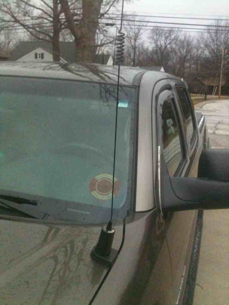

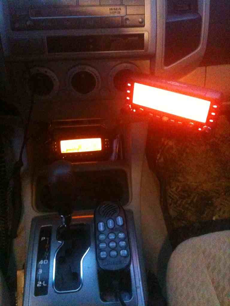

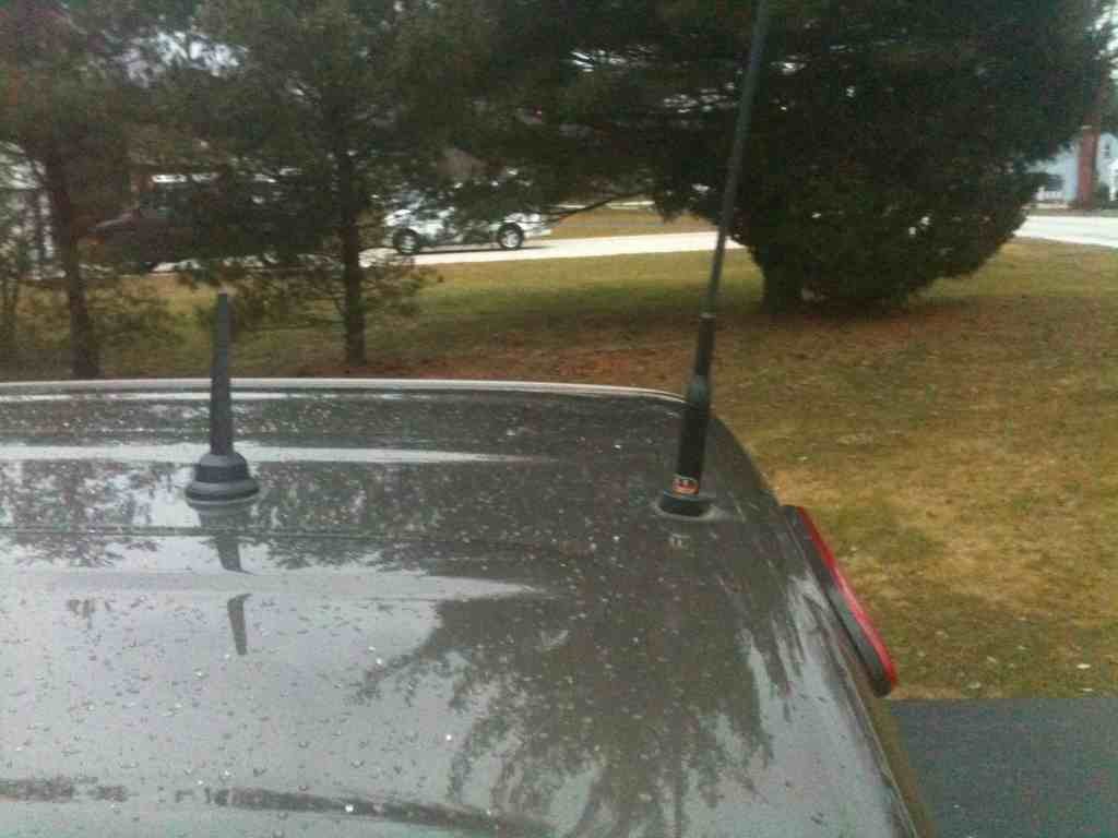

    Just seeing how other people have mounted radios in the second gen.
    Kenwood D-700 in the well and a yeasu FTM-350
    Hood antenna for the kenwood dual band
    Rear antenna for yeasu dual band and forward antenna is for the Wilson cell booster

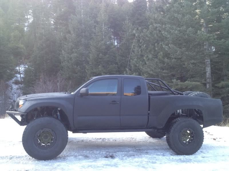

    here's my icom. Permanent mount antenna is on the roof . Your install is way cleaner than mine, lol. 7c08dcfd_9948de5a8f803a601722d97b67c27e4c7bcd4ba2.jpg

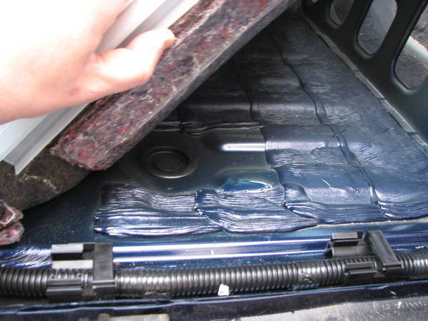

    There are grommets along the floor of the cab you can pass the cables through. There are a couple in the back wall, too - but they are harder to get to as the box is in the way.

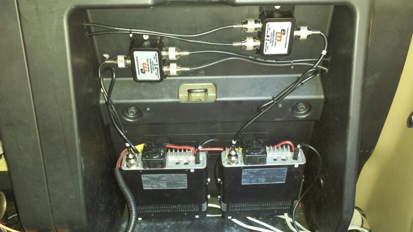

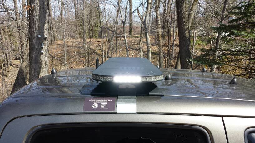

    Most recent antenna setup. Front 2 are UHF, second row are 2 VHF, next is a cell booster antenna then finally is the APRS tuned to freq. I run 2 dual band Icom id880 d-star radios. They are run through duplexers to spilt the freq. I run special events with so so coverage so now I can run 5/8 wave antennas on each band
    And the most recent control heads mount
