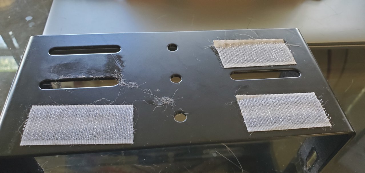

    Not familiar with that rig, but I put my Icom7000 body under my driver seat. I used adhesive velcro on the bottom of the mounting bracket. Sticks great.
    (one of the pieces of velcro came off when I removed it)

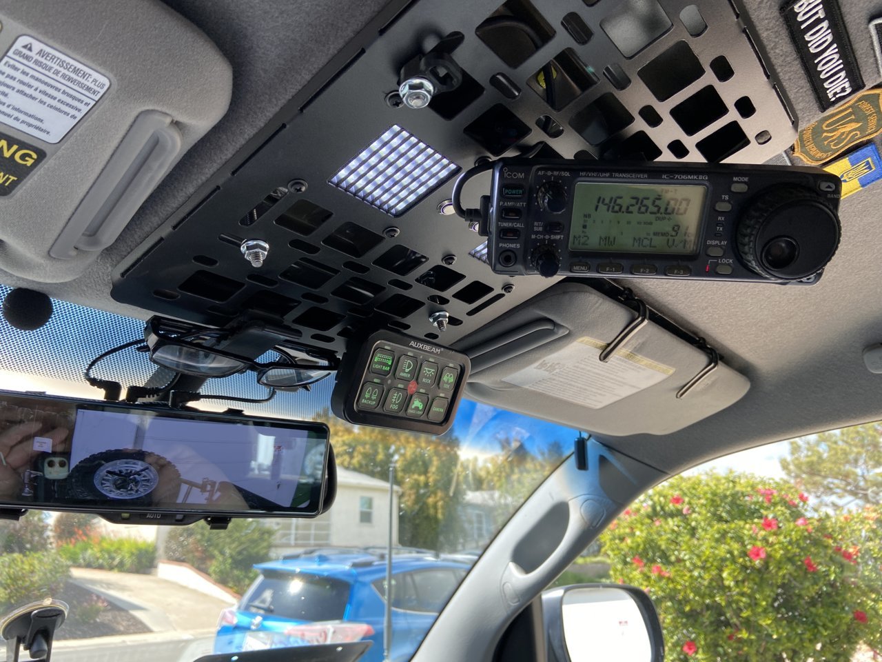

    I use a KFLo MOLLE overhead mount and have my 706mkiig face there. The main is installed behind the rear seats and using a cat6 cable I run the mic under the carpet and between the front drivers seat, mic sits in the cup holder.
